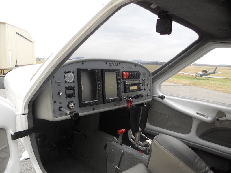

  6. Apologies for not replying until now... The problem was that the check valve in the right wing root... It didn't have the "bleed" like the left one did. Replaced both with new Andair check valves with the "bleed" and tanks now stay dead even.

  13. New owner here. Picked up N731J (2010 J230-SP) in Shelbyville ten days ago and flew home to KOXC (Oxford, CT). We left Lynchburg, VA with a full fuel load, the three fuel shutoff valves (left, right, main) all ON, and the fuel gauges on the G3X reading full for both tanks. A few hours into the flight we noticed that the right tank level was dropping faster than the left. By the time we got home, the right tank was reading much lower than the left. Got out my new Jabiru fuel stick this afternoon. Left tank reads 15 gallons... right tank no reading on the stick at all. That tells me I've got a blocked/pinched fuel line. Anyone else had this issue with their Jab? Thanks in advance for any guidance.
