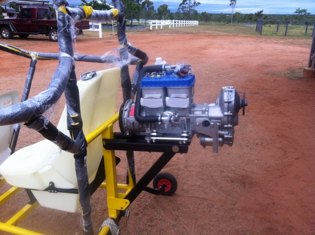

  14. Have been waiting on a couple of parts from the States which have arrived so have done a little more, nearly ready to weigh and a engine to run in.

  16. Can anyone tell me if the temp of the 2 stroke oil entering the engine will make any difference to performance. This is on a 582.

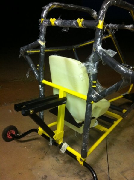

  18. Morning GG, yes back seat is the fuel tank. Have had a few question this set up, ( regarding sitting on a roto molded fuel tank ) I have then asked do you ride a quad, answer yes, whats the tank made from, end of concern. You are not wrong about the old 3 wheeled ATV's, deadly. Could be tradition, not many 4 wheeled aircraft about, less drag, better visibility from the front seat, who knows. Will post some more photos as I go, the back wheels are not the right ones have tundr's to go on eventualy. Cheers Tim

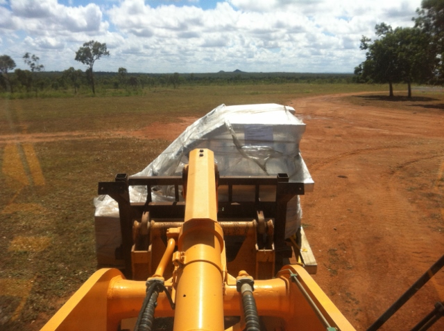

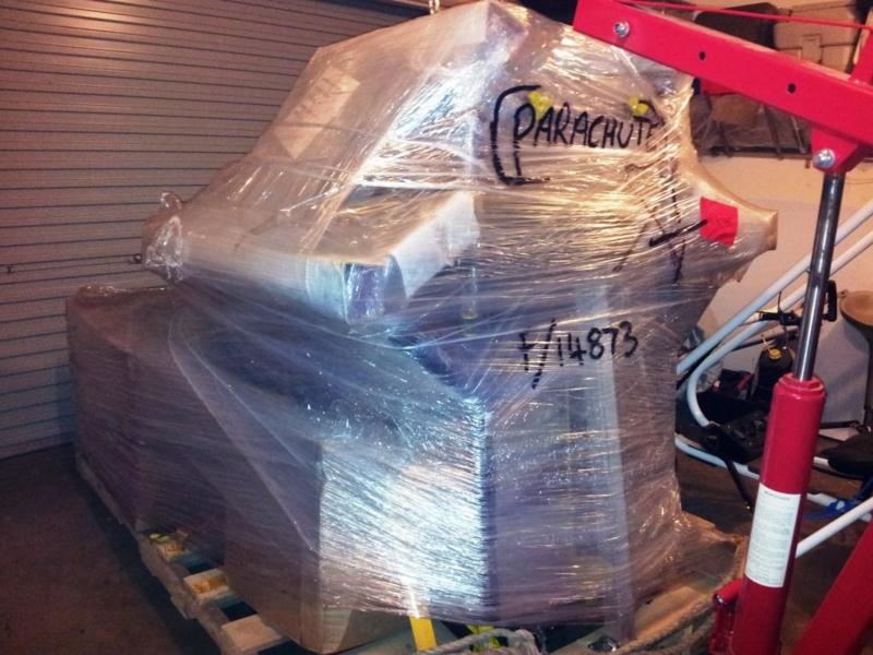

  21. Morning Graeme, yes and no, machine arrived in Australia just before christmas but have not had a chance to get to Melbourne to pick it . Looked at freighting it home but because of its size, just wider than a standard pallet and 2 long, freight companys want more than I want to pay to get it here. January is a busy month so hope to make it south, weather permitting in February. As you can see she is Laura Palmered in Melbourne. Have you finished your build. Tim
