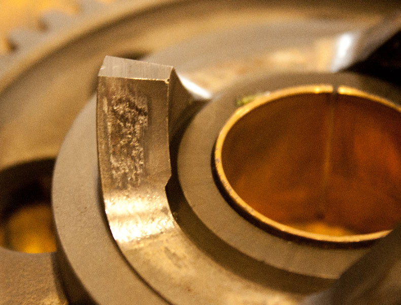

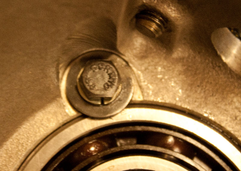

Hello all and Maj, thank you for a very thorough list of things to check on the Rotax engine setup. My friend just tore up the gear box and it does show sings of a prop strike. The main bearing is worn and the bolts that hold the bearing have some extra shims under the bolts that are not supposed to be in a gear box. Other signs of a prop strike are visible. I have added two photos of the bolts and shims and the wearing of the "clutch". He will be replacing the bearing and removing the shims, using thread lock instead. He hopes to resolve the problem with a new bearing. All other items Maj has mentioned have been checked and replaced when needed. This is a three year process and we hope it is reaching its conclusion. I will keep you posted on the result.
