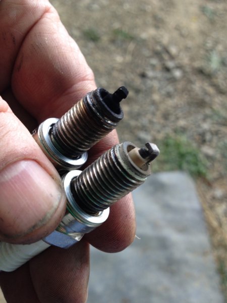

Rotax 912 ULS cylinder 3 running lean
macedonranges replied to macedonranges's topic in Engines and Props
I spoke to Gary from Bert Flood imports - distributors of Rotax in Australia and he said the following The spark plug that “looks lean” actually looks OK, and the other one is a bit rich. Did you run the engine at high revs before looking at the spark plugs ? as they do tend to go black and sooty with prolonged low rev running. We normally see different colored spark plugs on the same bank, this is due to the design of the intake manifold and not anything to worry about. When I did the change of spark plugs I had warmed the engine to facilitate the engine oil change so it was probably only at idle for 5-6 minutes so interesting comment - the engine has been running fine and no problems - so will be interesting to hear other peoples comments about what they have found when doing spark plug changes in the Rotax 912 ULS cheers ROB -
We have just done our 200 hour service and changed spark plugs and found the two spark plugs in cylinder 3 were very lean compared with the other cylinders .. Anyone have any ideas on when this would be - as cylinder 3 and 4 are fed from the Right carbie. Engine is running well and have had no problems.. so not sure about why it is happening Picture of spark plugs - Left side is from cylinder 4 and right side is form cylinder 3 Thanks ROB
