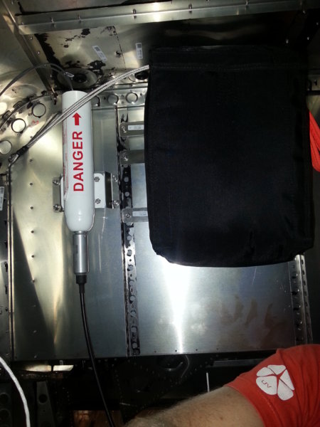

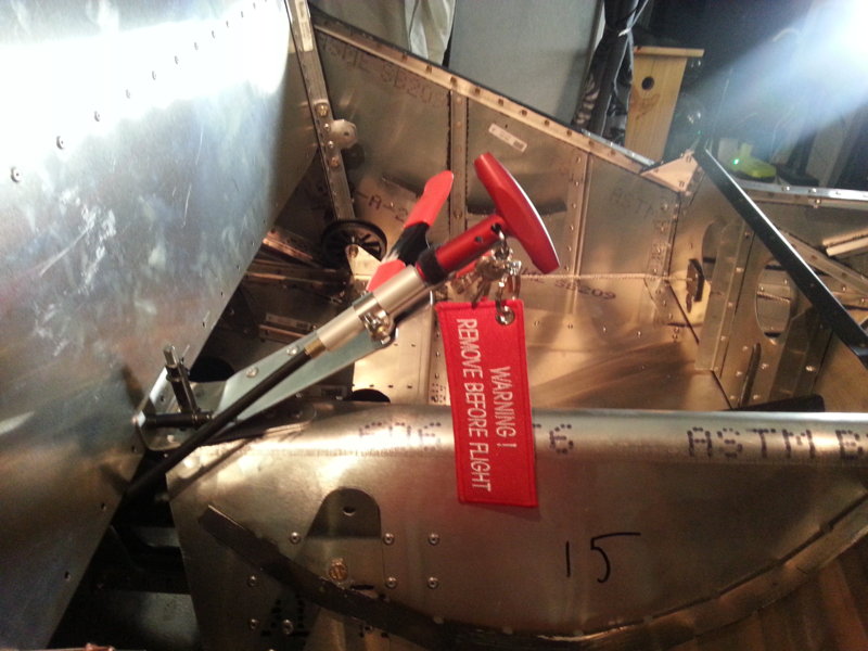

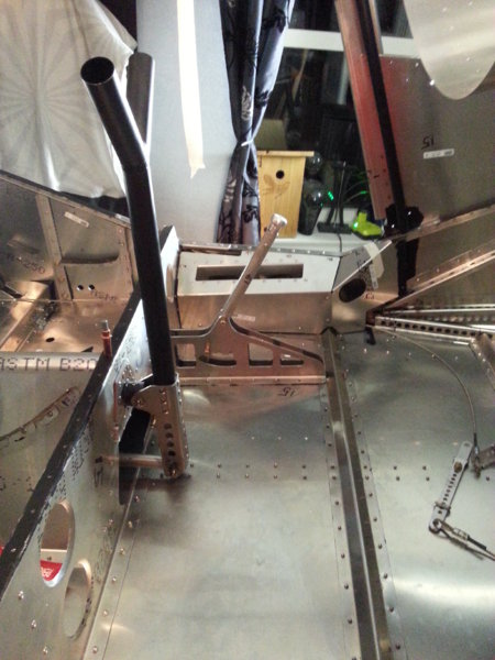

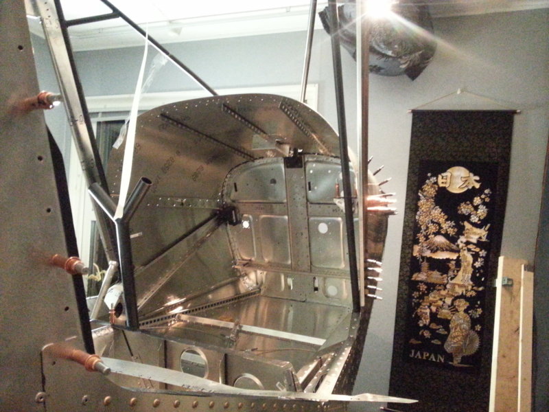

  22. They do respond its just that they are Italians(They answer a few of the questions, not all queried, and after a very long time maybe) ;) they seem to be understaffed since one of their main technician just quit. I bought my kit directly from ICP, not dealer.
