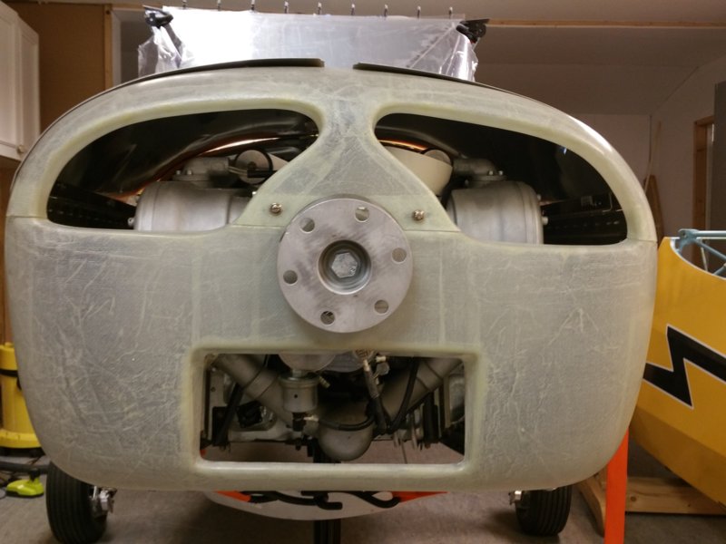

  13. Skee

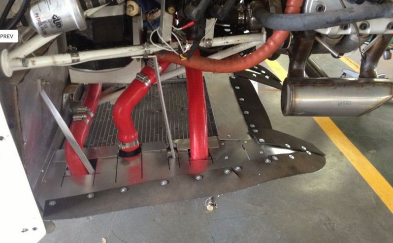

  16. Just another day in paradise =) Added the front fin. The oil can got there. And adapted the Coolergrill to fit around the oil filter, ppretty happy with it considering i dont have any special machines. The radiator is big like hell and i solved it by ducting the air from the front to the sides. Now to Get the nacas molded into the front.

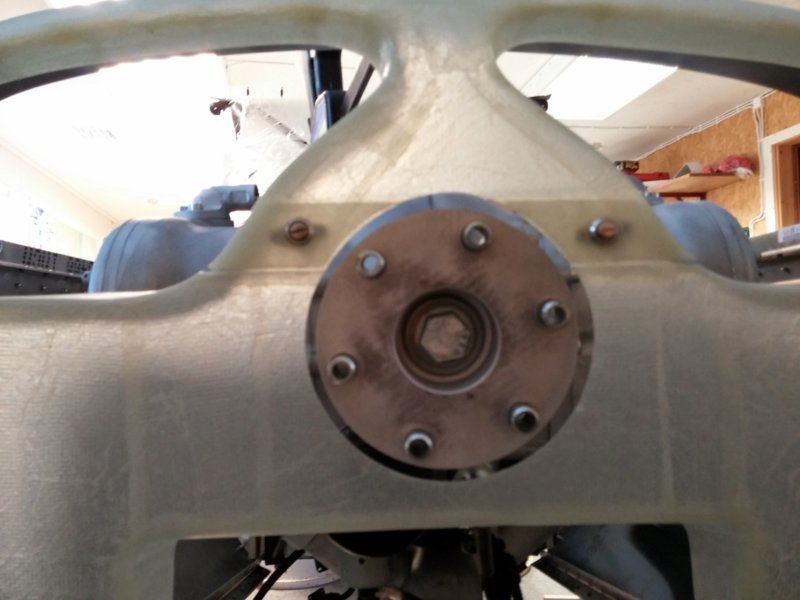

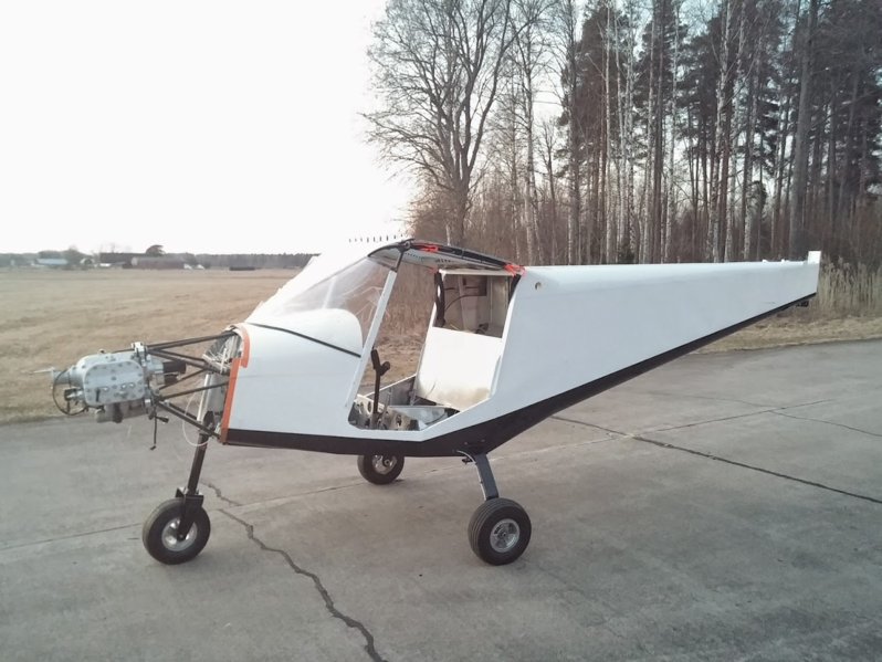

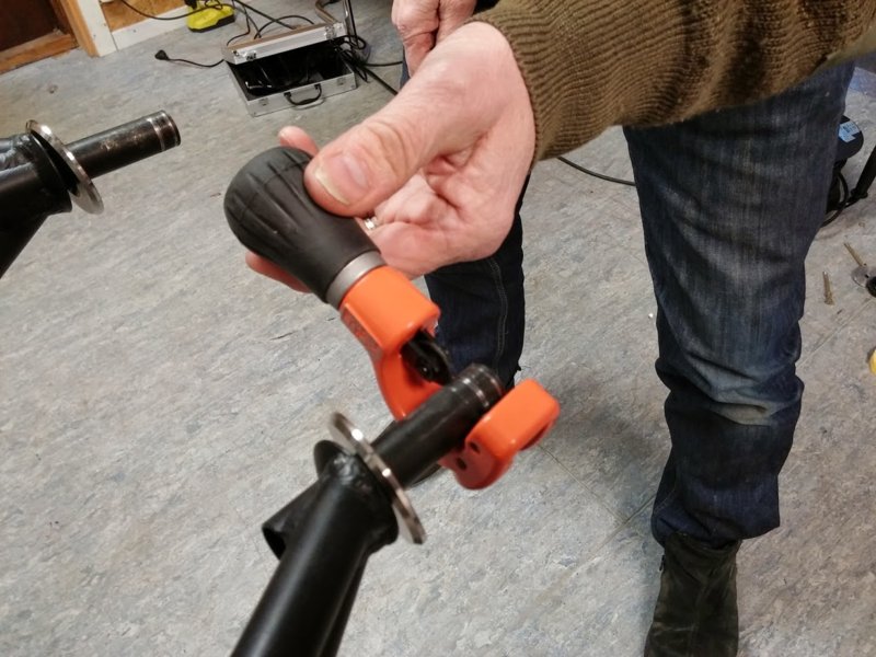

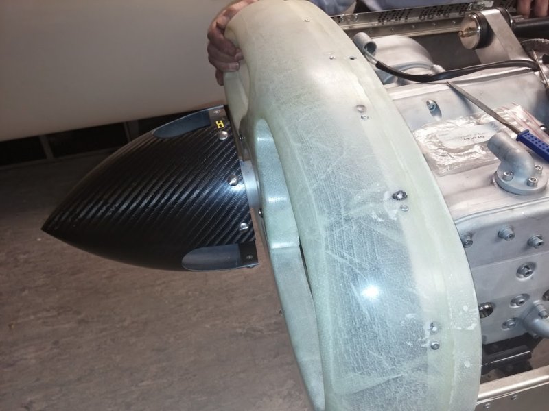

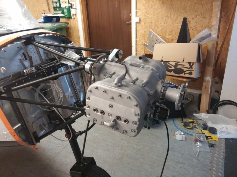

  18. Had to make a cut-out for the oil filter, i kinda regret now that i didn't just buy a prop extender, but i walked this road when i shortened the cowl. I Finished my Carbon monoxide sensor =), ill just connect it to my Efis and it will warn me on screen if its active, lets hope i never need to find out if it works. Also putted some shrink tube over the brake lines. On Monday there's a guy commin to tack weld my exhaust, i also ordered a new hood from icp, i got a kink on it, stupid hood should come pre rolled from factory. Ever wonder if engine manufacturers thinks twice? so tight i even had to turn the screw facing other way and i still think its to tight.

  23. I need to buy a radiator. How do i figure out what size i need? many use Motorcycle radiators.

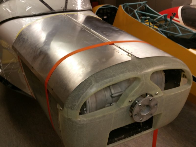

  24. So ive shortened the Cowl about 5cm and aligned it, so much work.... Also need to make cutouts in the airintake for oilfilter and oil temp probe. Now to shorten the hood a bit.
