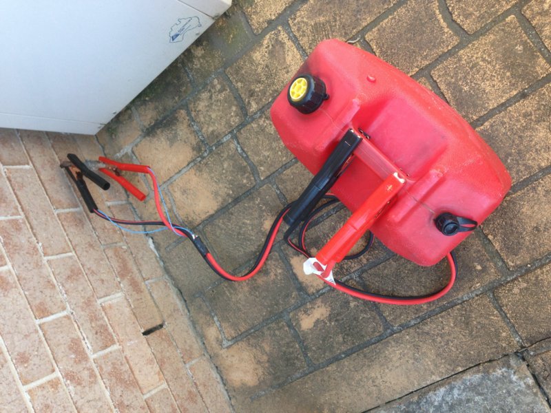

  6. It occurred after about 5 litres of fuel was pumped into the tank via a mr funnel. It could have been the result of a spark occurring when the nozzle got close enough to the funnel for a spark to occur. I can't recall if the nozzle touched the funnel before the spark. During fuelling the nozzle never rests on the funnel as this would cause my funnel to tip and spill fuel
  7. No, I was wearing a pair of shorts and a t shirt. The t shirt was cotton and polyester blend. I do recall the drum brushing up against my leg as I walked it the five metres or so to the trike. I then put it down, open the cap, installed the nozzle and started fuelling.
  8. I think the following procedure might work well: Bond or earth funnel to trike, Earth trike, Wipe drum with damp cloth including nozzle. This will make the drum conductive and allow it to be effectively connected to an earth. Charges built up in the flowing fuel should be the only possible ignition source but given the relatively low flow rates from a drum it shouldn't build quickly as at least some of it will dissipate when the fuel makes contact with the funnel. Not using the funnel would make the fuel charging issue less as a spark inside the tank would be much less dangerous than one inside the tank. This is because the fuel air mixture is too rich (unless the tank is empty) to cause ignition. Those who don't use a funnel will probably have less risk of fire but greater risk of fuel contaminants being an issue. I know of some people who never use one and routinely fill up with mogas. I wouldn't ever dispense with a funnel personally.

  10. It's easy to get this whole thing way out of proportion especially by me right now. As Maj has stated it is a very rare occurrence. Airborne have stated that they take no special precautions when fueling trikes and they've been around for decades and have flown many thousands of hours and refueled thousands of times without incident. The whole triking community would have probably accumulated somewhere in the order of a million hours in the decades of operation and most have refueled as I have. In all, I count about 4 known incidents in that time including mine. Let's say another dozen exist that have not been reported and you have less 20 tops in the history of australian triking. That's 20 failures in at least hundreds of thousands of refueling events. Clearly, a whole range of events have to come together to cause a fire. Yesterday was one of those rare days when it all did.

  12. I had no trouble inducing a charge with the container on the ground. Remember, I used a red drum. It would be interesting to test the earthing properties of the black ones.
  13. I just tried it and it worked perfectly. I first showed that a charge could be induced on the drum using hair as before (no earthing). After I was satisfied that the drum indeed could be charged I then wiped the surface of the drum using a lightly damp cloth. Charging by the same method as before failed to induce any charge what so ever! Just be sure to wipe the surface of the nozzle too if you use one.
  14. That is a top idea head in the clouds. The evaporating moisture will remove charge just as would happen on days of high humidity.
  15. Charges that build up on metal items distribute themselves evenly over the surface of the conductor and are easily removed by earthing. Unfortunately non conductors do not behave in the same way. When they become charged the charges cannot easily move around on the item as they are non conductive (this of course is dependent on voltage as anything can become conductive if the voltage is large enough even plastic). I just did a quick experiment to confirm this as the humidity today is lower than yesterday ~10%. I attached a set of jumper leads to the same drum I used yesterday and earthed it to my homes earth stake. I then used the hairs on my legs to charge the side of the drum by moving the drum back and forth along the hair. I had no trouble doing this with the drum attached to the earth. I know it was charged by the large deflection of the hairs on my legs as the drum was moved toward them (so I used the hair to both charge and detect that charge). I also then used my finger tips to produce tiny audible sparks as I moved them close to and made contact with the drum. I then attempted to discharge the drum by rubbing the palm of my hand over the surface of the charged area. The charge reduced but was not eliminated. I repeated the above procedure with and without the earth leads connected with no significant differences in the results. This demonstrated that the earth was not effective. See the attached image for my setup. Now assuming that the earth I used was a valid earth as I would expect it to be, then the following conclusion can be safely made. Conclusion: Earthing plastic fuel drums is ineffective. So, the results seem to suggest that static build up on plastic drums during low humidity is common and difficult to discharge. What I don't know is at what humidity level does it become a serious issue? What I mean by this is at what point will a large enough charge occur that a spark is likely? And if so, how big does the spark have to be to cause a fire? What I can confidently say is the spark I heard yesterday was louder and bigger than any spark I deliberately created today.
  16. I have to agree with what's been regarding earthing the aircraft and the can. There is no point earthing the aircraft without the can as sparks will always be generated from a charged object coming into contact with earth. The problem may be exacerbated by the plastic containers as they cannot be effectively earthed. The fuel itself is another problem as it will develop a charge when it flows. It cannot be effectively earthed as it is non conductive too. There is no way to eliminate the risk completely except to not fuel when humidity levels are very low. Yesterday's humid bottomed out at 27% which coincided with the time I was refuelling. My advice is to check humidity levels at your airfield via the BOM site and avoid refuelling from cans when humidity drops below 40% or so. If your not at an airfield with observations, pick the closest area to you with observations as humidity levels can be dramatically different over short distances. Alternatively, if you are detected static discharges on yourself or objects near you then you know it is a danger period for working with fuels. After the decision is made a fire extinguisher at hand should be mandatory from now on.
