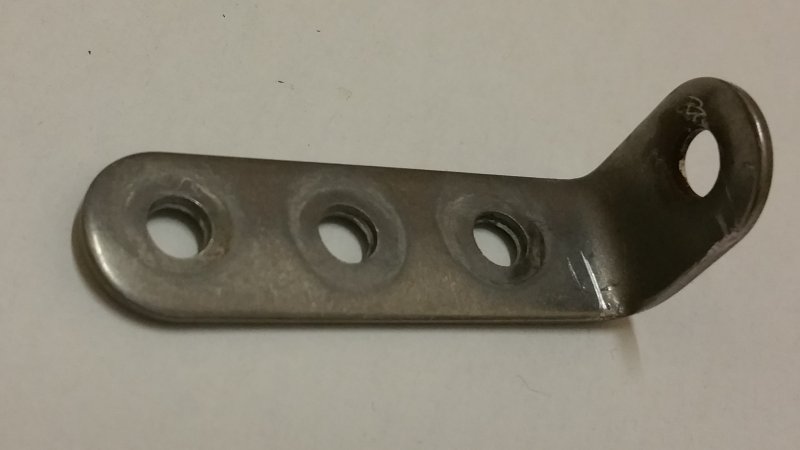

Does anyone know where I can get some hinges as used on Drifter rudder and horizontal tail plane control surfaces these are also used on other rag and tube aircraft. Its a SS bent plate with 4x 5/32 holes

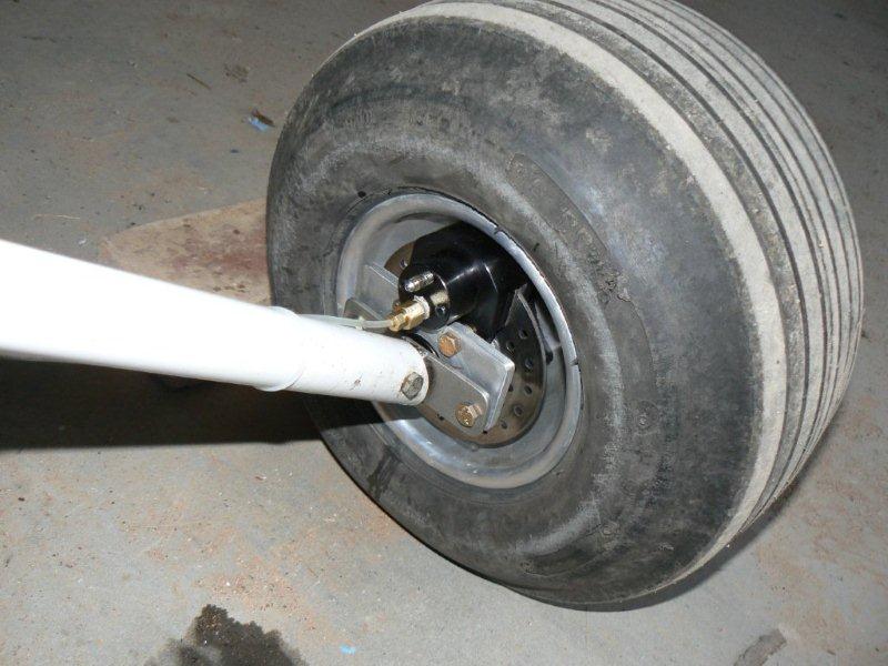

Fitting Black Max brakes to my Drifter! You can purchase from the manufacturer Hydraulic Brakes You want the “With Newly Redesigned Hub that takes heavy duty bearing” Not old stock like I got This one, BX44863-4 The rim is 4 inch wide, 6 inch diameter, 3/4 inch axle diameter [ATTACH]10572.vB[/ATTACH] The caliper is mounted with some aluminium plate from Bunnings aero-space The Drifter joy stick is 7/8 inch diameter, the Black Max master cylinder has a 1 inch mounting hole. I used a bit of 1 inch OD, 1/16 inch wall thickness Aluminium tube as a spacer for mounting This photo shows the park brake on, which will easily hold at idle [ATTACH]10573.vB[/ATTACH] The standard Drifter rims are 5 inches wide, I use 6 ply Trelleborg tyres, which are wider in the sidewall than the usual lawn mower tyres, These will just fit in the width of the Drifter spats, So using the 4 inch wide Black Max rims will make it all fit with spats I Run these Trelleborg tyres tubeless, at 15psi The brakes will hold at full throttle! I don’t have spats fitted at the moment, because I got the 6 inch wide rims, and the spats won’t fit These are the same brakes that are on the Australian Airbourne trikes Landing distances are easily halved with these brakes Differential braking is not needed, with use of throttle and jiggling the brakes I can do 360 degree turns with one wheel stationary Hope this helps Shane
