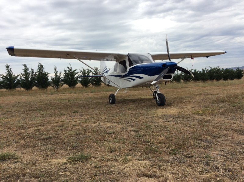

We took possession of our new VH Registered Brumby 912iS R610 Highwing on 12th Feb 2016
I flew it home with Phil Goad a few days later after some training & a flight check. 3-1/2hrs Cowra - Central Vic
We cruised around 4500' @ 15 - 16 LPH 100K ground speed

Nice paint job to your specs or leave it up to Brumby. I'm 1.8M tall & I can just walk under the wings
It has now done about 70 in Flight Hrs & excels at altitude, takes off quickly in our paddocks with 2 POB
