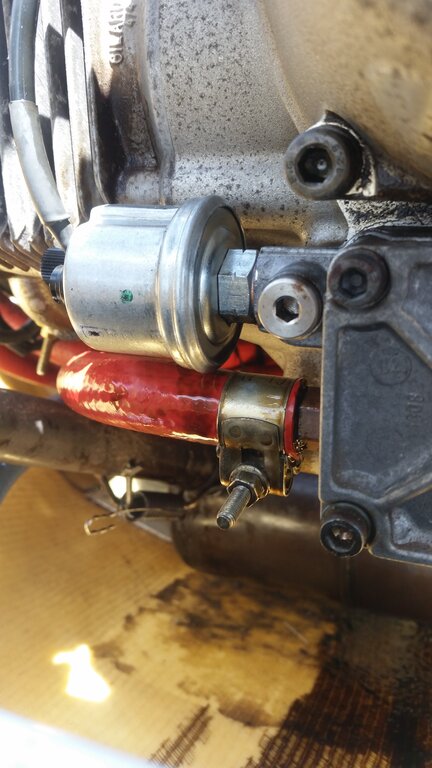

Hi folks I have discovered on further investigation that the new pressure sensor is not leaking after all. I have not realised that the thread is tapered and have put the new gauge in too far and split the housing. Der to me So to get a new one costs about 900 from Floods. But I can get a secondhand one with the NPT thread for about half that from Floods. I do feel like a twit. Floods tell me I'm not the first to do this, but that doesn't make me feel any better. An expensive lesson learnt. Heath

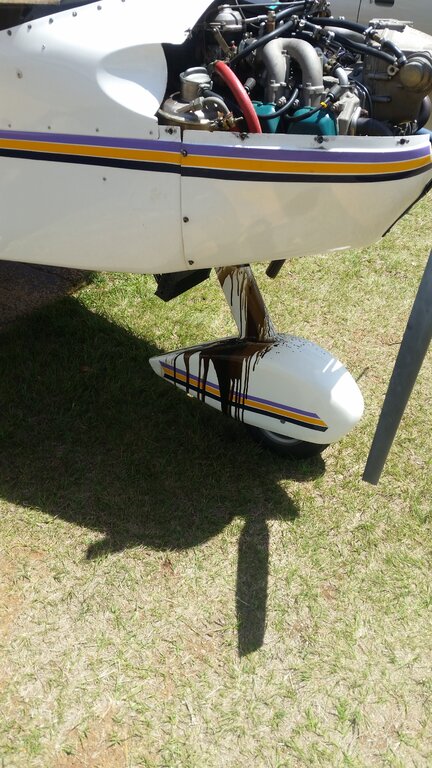

Hi folks Got a vdo 360.004 sensor from Aircraft Spruce and installed it. Unfortunately it failed on engine start up. Oil spewed out of the sensor where the outer shell is pressed over the inners which holds the stud. I am waiting to hear back from them to see what they can do. My next door neighbour who is a mechanic and also flies says I should source one through a auto electrician. Might do that next week. Floods in Melbourne quoted me $223 for a vdo 360.081 and I thought that was a bit too expensive. Attached are a few pics after the engine was started and run for no more than 30 seconds. I'm just glad it didn't fail when I was flying. Heath
