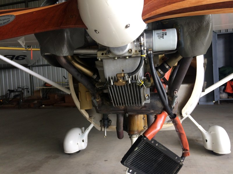

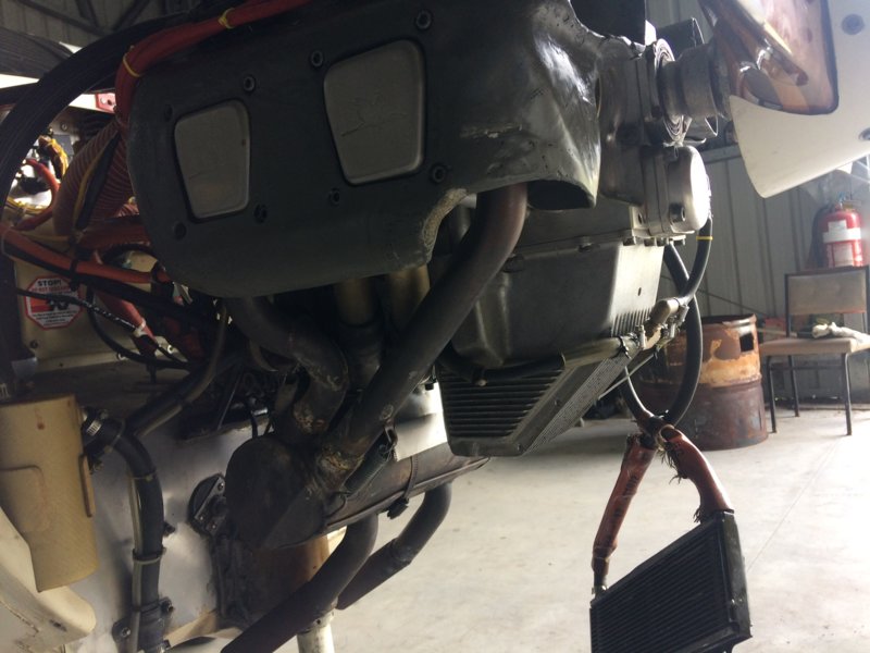

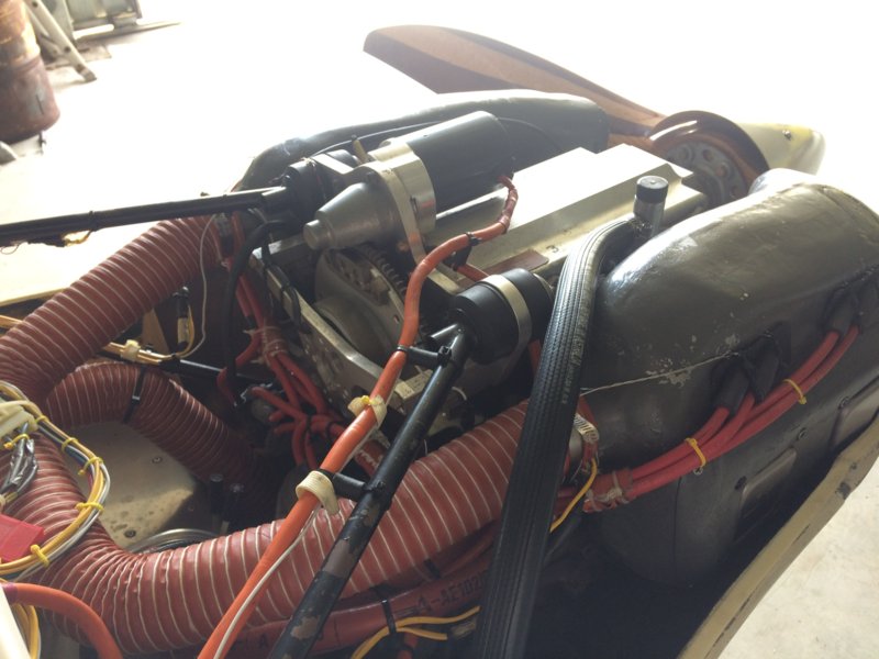

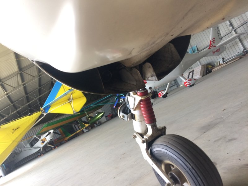

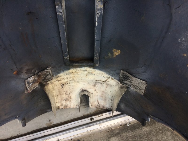

Seb can’t locate video after my move, it’ll show up in some stupid place I’m sure, took photos whilst doing oil change this morning the lower cowl has deflectors which hug around tail pipes, the video showed engine on stand with cowls fitted and blanked off at fire walll end, he used a smoke/fog machine and a large fan, u could clearly see the air flow through the cowl and swirling effects, personally I think it’s all a bit over the top as I found just little bits of tweaking on previous jabs had fair result with many hours flown on engine relatively trouble free.
The drifter wing is not constructed strong enough to withstand the fabrics shrinking process, Wayne fisher said too much distortion would occur When I asked why only tails and ailerons were seconite and not wing.

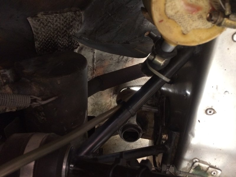

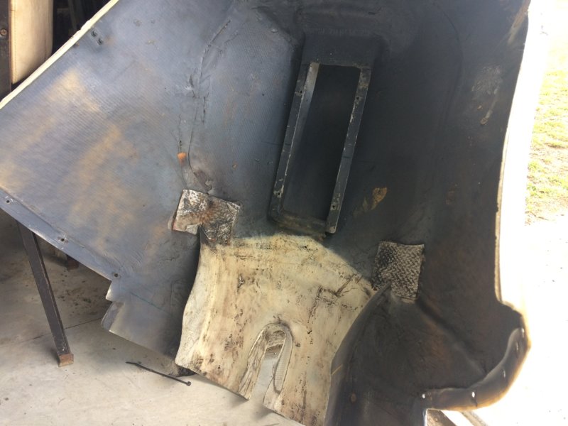

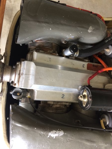

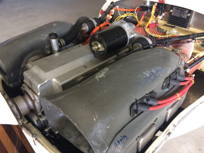

No, No deflector, there is actually eight components involved in his modifications. I should have taken lower cowl off so you can get better view. The cylinders are nearly fully Encased with Kevlar like duct and air is forced out bottom of cylinders nearer to engine block. Have moved recently so may take a little time locating the stuff you require

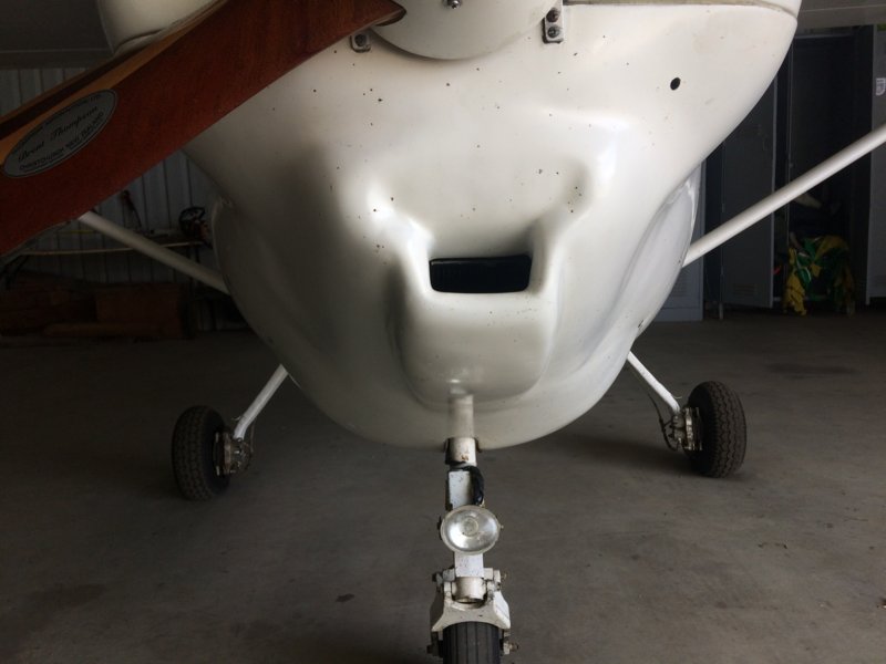

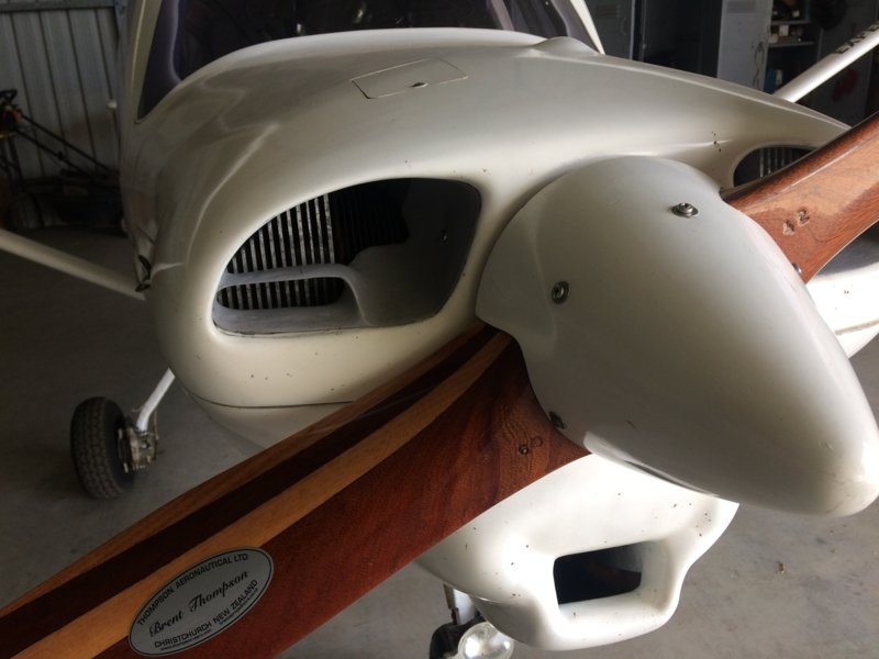

Hi, Seb My intakes appear standard with an insert (grey coloured) in pics. You need to remove these inserts prior to removing cowl as they are screwed in. The hole intake moulds are not jabiru and are hand made of thick fibreglass and there is no deflector on drivers side, completely open unlike photo of passengers. Yes oil cooler is from bottom inlet and cooler mounted on lower cowl then air forced into lower cowl that exits with exhaust. I have a video somewhere that shows the engine on bench with smoke and fan showing air flow. Will try to locate if you wish.. I think the scat hose is used as a balance for air pressure balance during different angles of attack, not sure but all seems to work ok.

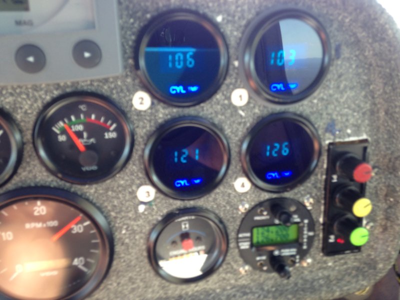

I bought this jab because of the builders detail to duct work etc. photo taken at 32 deg day @ 1000 feet last year. Oil cooler attached to lower cowl, large opening lower cowl and hand made air ducts that Inclose spark plugs and has scat hose at rear of ducts used to balance air between the 2. On hard climb no 3 can reach 156 on a stinking hot day but lowering nose will quickly lower temps. Oil is a bit cool, but I don’t want to play around with it and up set something else
