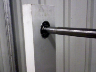

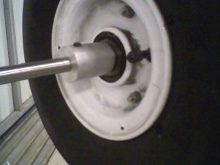

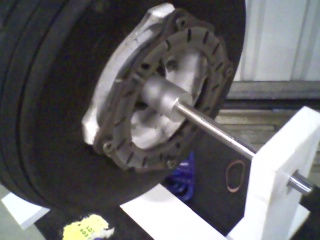

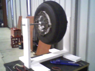

If anyone is having problems with main wheel shudder on takeoff ( and nose wheel shimmy on the t/o run ), I offer this home made solution to try... cost me about $50-60 to put together ( you need a lathe or a mate with one). If anyone is interested and motivated enough to make their own, PM for details. You can buy them commercially from a few m/cycle accessory importers but they range in price from about $250-400. Interestingly, it required about 50-60 grams to balance the mains with the discs attached. Best of all....it works!! Some images ( please excuse the poor quality, taken with phone camera).

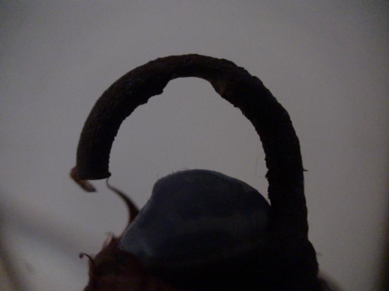

Johnm Hopefully.. photos of an exhaust spring attached showing the extent of erosion after approx 100 hours. I couldn't find one of the badly worn ones to show you.... this one is about half through. The anti seize is Loctite 771 but also available in Permatex etc..available from bolt bars, bearing shops etc. Use sparingly as you don't want excess falling on the muffler. If I was flying a 'pusher', I'd be checkin the springs with a microscope before flight..a spring into the prop..ouch!! Since I filled the springs with silicone I haven't broken another one but note they are still wearing...but like cloudsuck a couple of springs went 'missing' in the first couple of months until I remembered that we used to do this to the exhaust springs on our MX bikes, as they tended to suffer the same fate. I don't believe applying beads on the outside of the spring is as effective. Cheers
Hi Johnm...in response to your question about replacing the tags...no I haven't replaced them yet, but I noticed at the last oil change and general engine inspection that the apex of the spring eyes had worn very thin on a few of the springs, and I'm certain I would have lost a couple by the next oil change from fatigue. I changed all the springs as a precaution with new ones and applied high temp nickel anti seize to the tags/springs...too early to tell yet if this will reduce the wear factor (only done about 10 hours since applying) but works in other engineering applications so reasonably confident. I have also filled the spring centres with high temp silicone rubber to reduce harmonics...this is recommended by Rotax but not widely known. My engine has 130 airswitch hours , and like you I was very surprised/alarmed to find the tags had worn so much in so few hours. I haven't measured the tags with a vernier, but the Mk 1 eyeball estimator says 25 %. A few of the springs had worn down to 50% of original diameter, some a bit less. How many hours has your engine clocked? Like you, I would like to hear from any LAME's or Level 2 guys who have had to replace the tags. I remember ringing Bert Flood and asking about this problem ....they gave me the Rotax recommended spacing between the tags but can't recall at present....suggest giving them a call, I've always found them very helpful and happy to give advise over the phone. Hopefully some Rotax gurus out might like to add their 2 bobs worth so we can both find out! Cheers Johnm

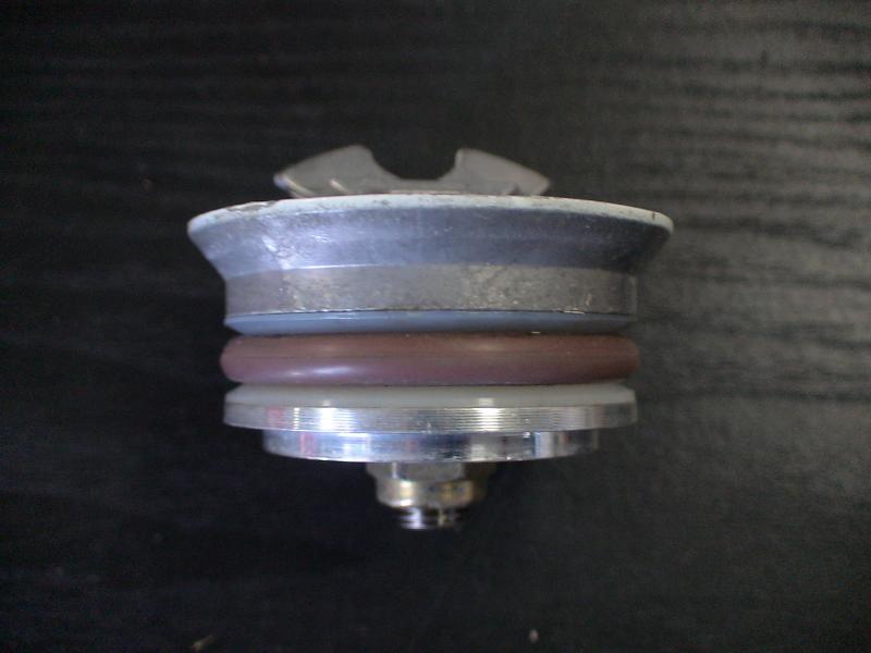

Cloudsuck You can see the nylon gaskets either side of the o ring in this photo. (right click on thumbnail and click Open Link) Cheers
Briefly, trim the nylon gasket between the top and bottom halves of the cap. I didn't even notice it until it was pointed out to me by someone more knowledgeable than I. He trimmed it for me. I think, from memory, the cap has to be in the closed position when you do this so the gasket is squashed out proud of the cap slightly. Trim the gasket very carefully with a sharp knife being careful not to nick the o-ring. It's only slightly proud so you wont need to trim much off, but it makes a difference. Also, if the cap is really tight to close or tight going into the tank neck, you may need to adjust the 'squash' on the o-ring by loosening the nylok lock nut say 1/8th of a turn out and then turning the lower half of the cap out against the locknut and retightening. If you decide to adjust the cap, make sure the cap lever is in the closed position when you loosen the locknut, otherwise you risk damaging the lever. Closing the lever stops it turning. So, it's either the o-ring or the nylon washer or both thats causing the problem. I found the caps really annoying to remove but resisted the temptation to use screwdrivers and keys etc to lever them off....god only knows what happens in flight schools!! However, a little at a time on the adjustment is the order of the day.. If you decide that the above advise makes sense, when you race off to the hangar to have a look, let me know if you agree and the outcome:thumb_up: PM me if need be. Cheers
