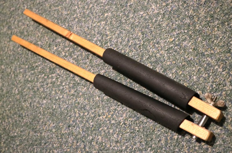

Adjusta-Prop - a hi-tech accessory for adjusting pitch angles. Two x 2 ft lengths of 2"x1" timber (for the non-metric parts of the world ) Two bits of foam pipe insulation Two penny washers Long bolt, bit of plastic tube and a wing nut Clamp over the root end of the blade, gives much finer adjustment and is kinder on the blades

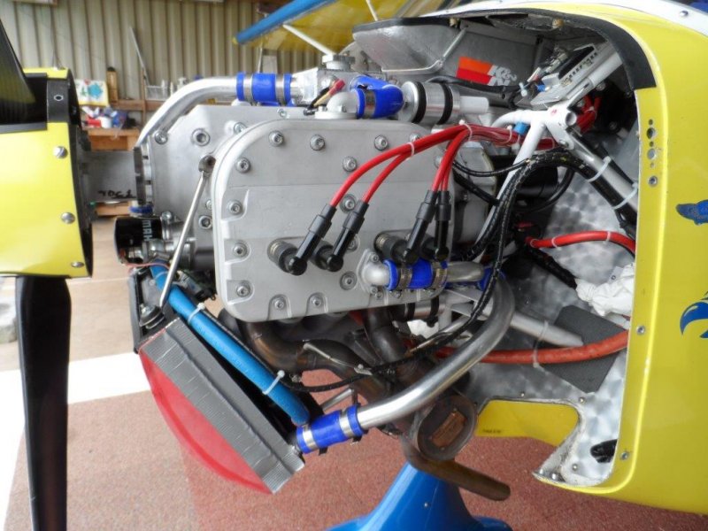

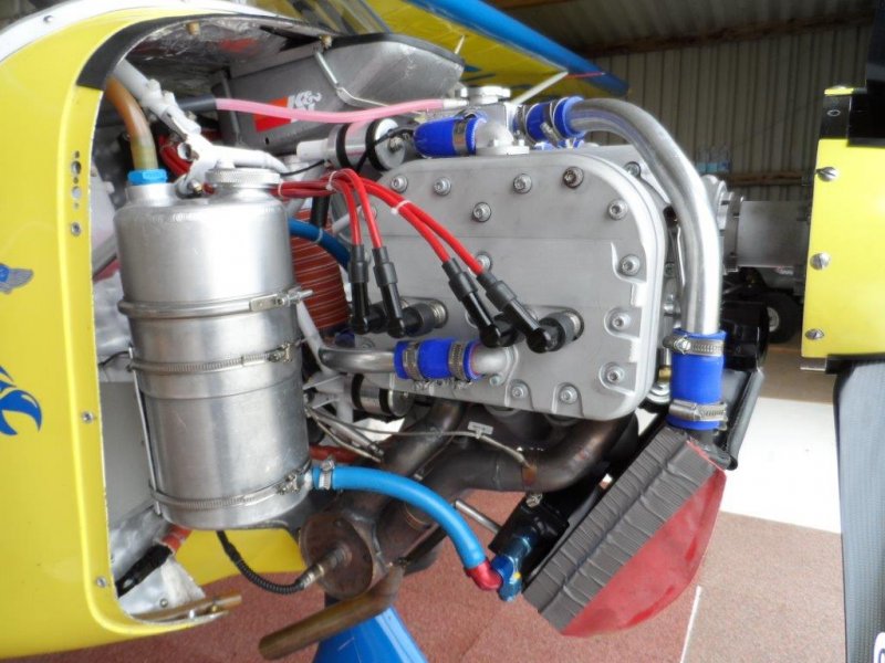

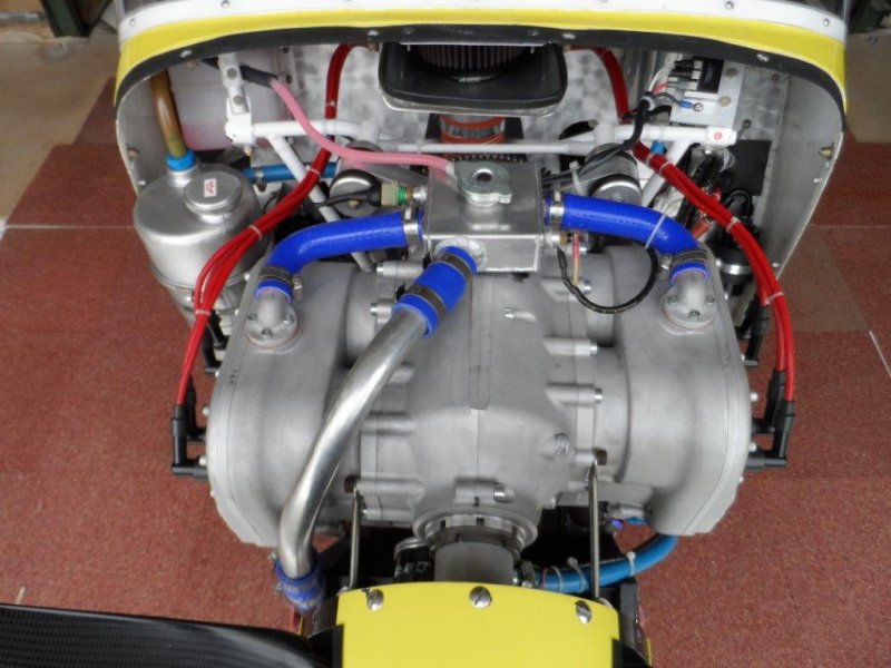

Having mastered posting photos, a few views of my own installation when the cowls were off for a service. The engine was not prettied up for these, it stays quite clean and dry Before I get rude comments, the old carpet tiles on the hangar floor make it easy on the knees and stop dropped nuts and bits disappearing. Nick
Correction, that should be radiator and fluids, you can just see the double can exhaust below the engine.

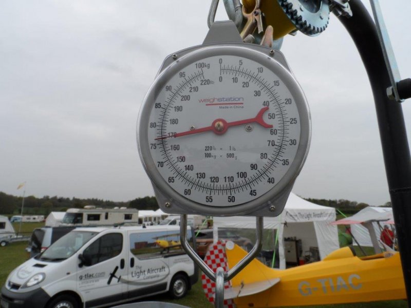

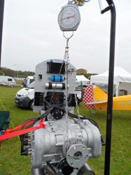

Magic! Thanks to fly tornado. Photos of the D-Motor 6cyl on its display stand at Popham. The red tape was just to stop it swinging round in the wind. Weight includes every accessory except exhaust and fluids, the oil tank is on the rear of the plate. Nick
