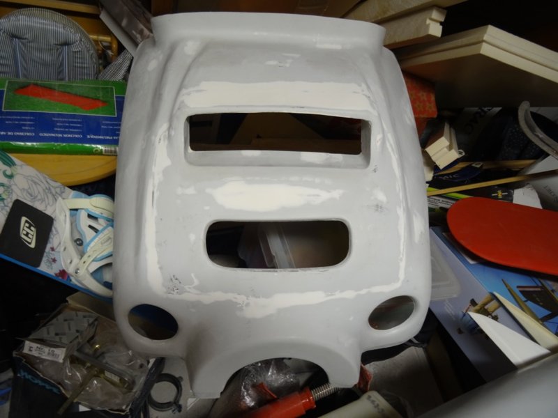

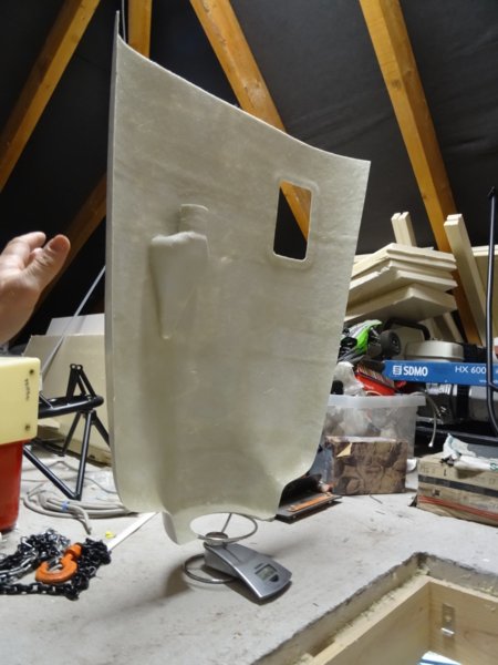

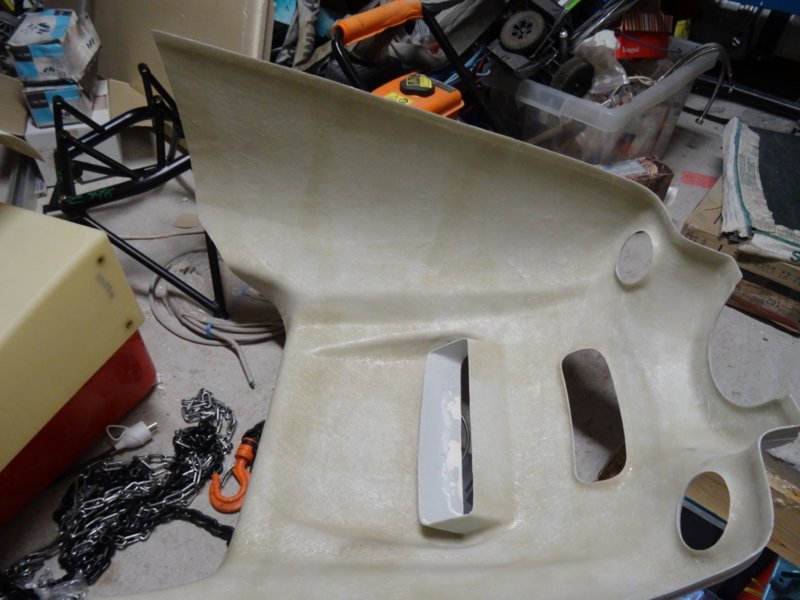

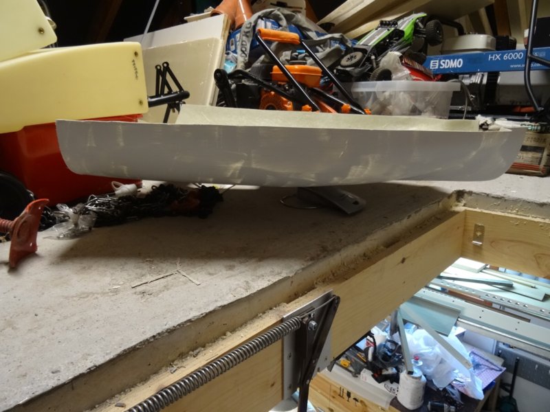

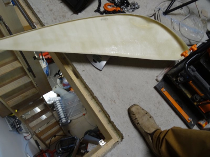

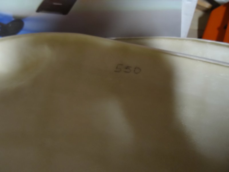

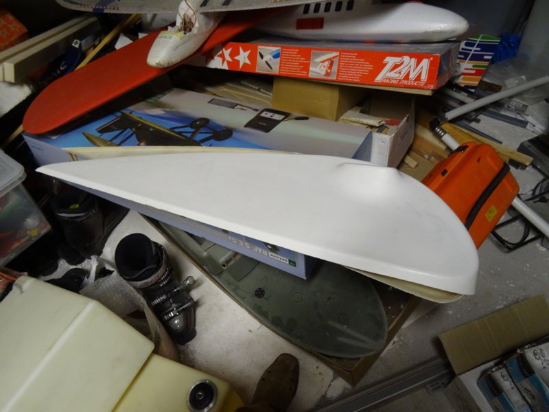

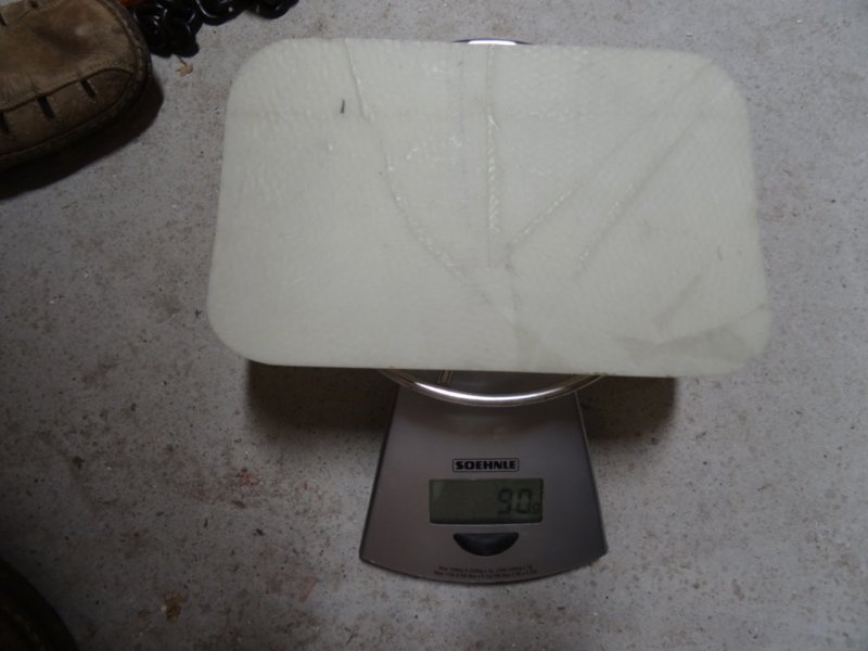

  7. Well we just got back from the south so I had to go and do something with the Savannah so I weighed the fibreglass parts :) wing tip 1 = 680g wing tip 2 = 550g upper cowl = 1682g lower cowl = 2246g oil cover = 90g the quality seems ok with a little filler and rubbing down I should manage a decent finish.....

  11. Hi Thomas, ready top put the cowl on? I have some serious catching up to do! I am away on holiday at the moment but will have a go at weighing the tips and cowl when I get home. Out of interest is one layer of the woven mat enough for the tips and cowl? Is there any advantage in other types of mat such as carbon or kevlar? I would be interested in having a go at making some parts and will try like you did the fin and tail tips. Mine are a completely different shape to the fin and tail and need to be squeezed to make them fit. On another subject did you get the electric trim? If so what type of connecting rod does it use? Mine has a ball joint and not the clevis that Ray Allen uses, just wondering why they changed it
  12. Hi Thomas they look great and a much tighter fit than the originals well done :)

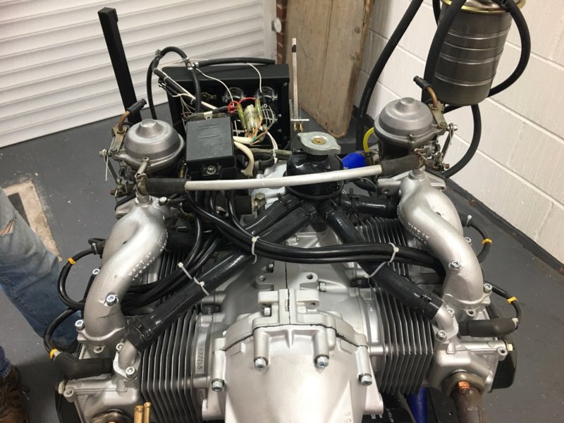

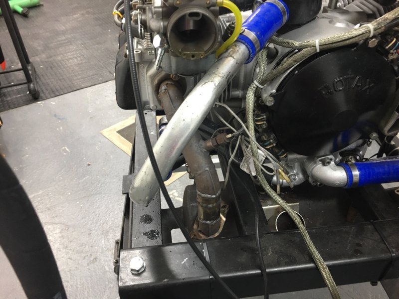

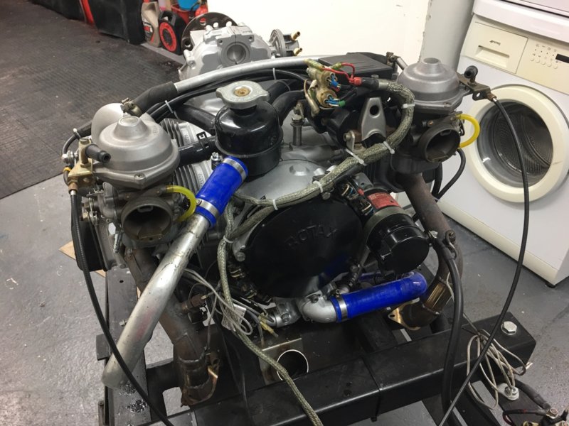

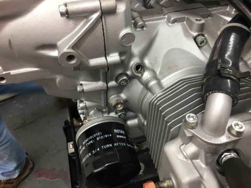

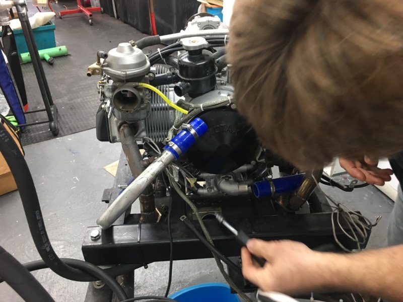

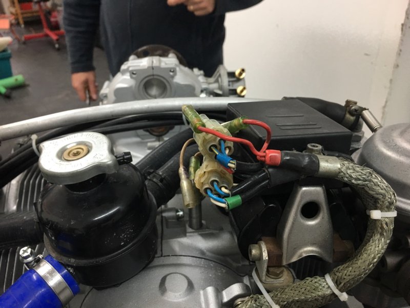

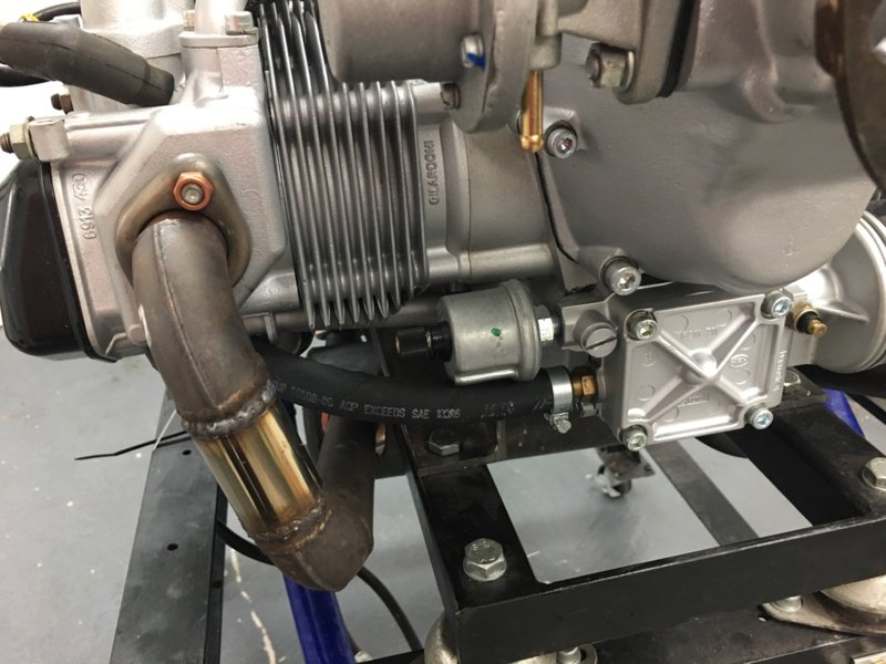

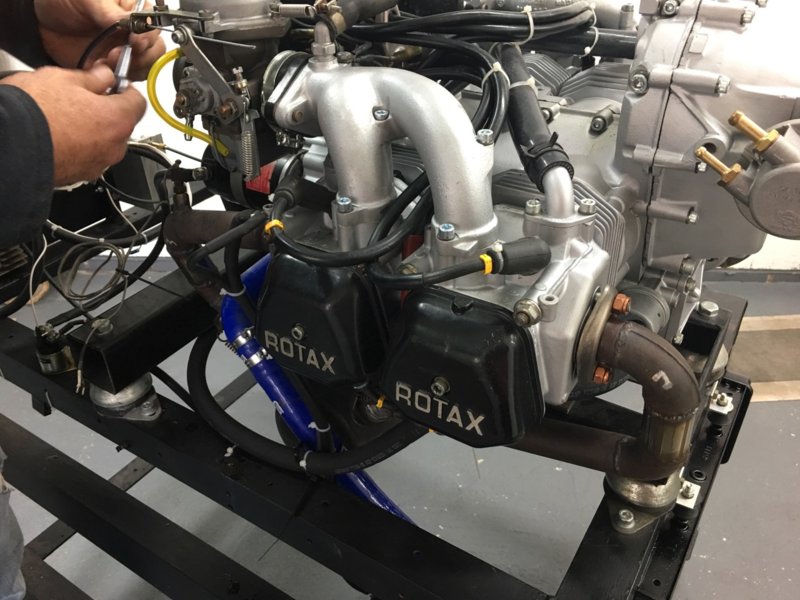

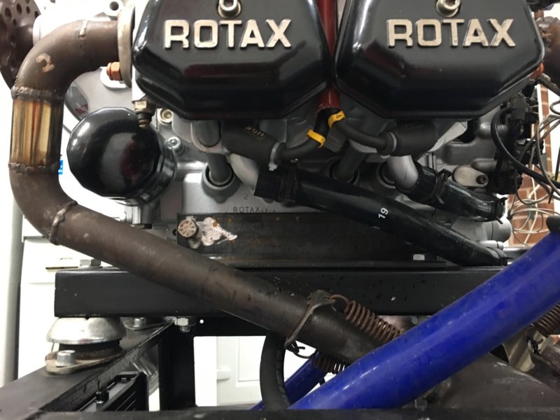

  15. Indeed it is a rebuilt 2004. It was rebuilt by the fellas that acts as the LAA expert on Rotax, so it should be as new. Saw it run and vibrates less than the new ones in our club plane. Cant wait to get to the stage where I can try it properly.
