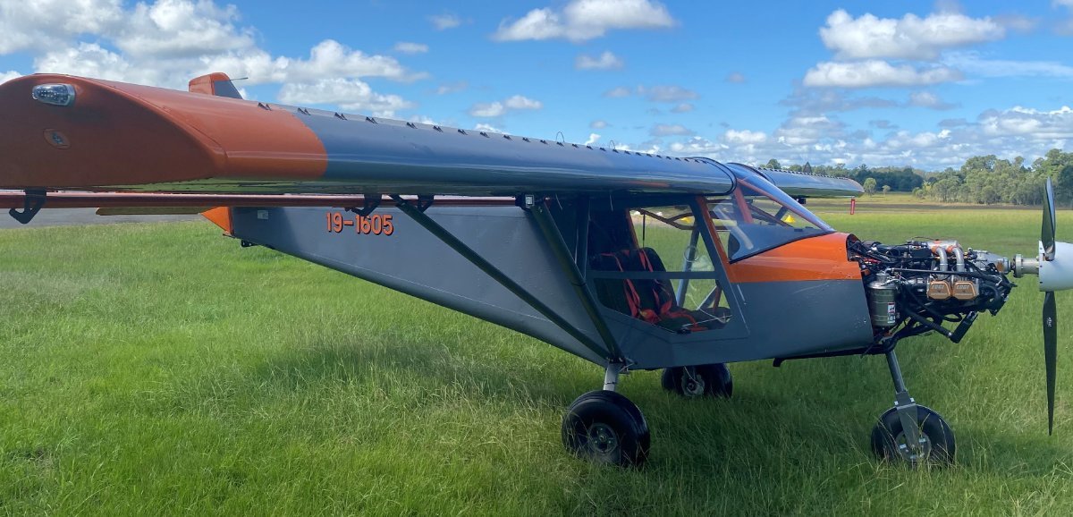

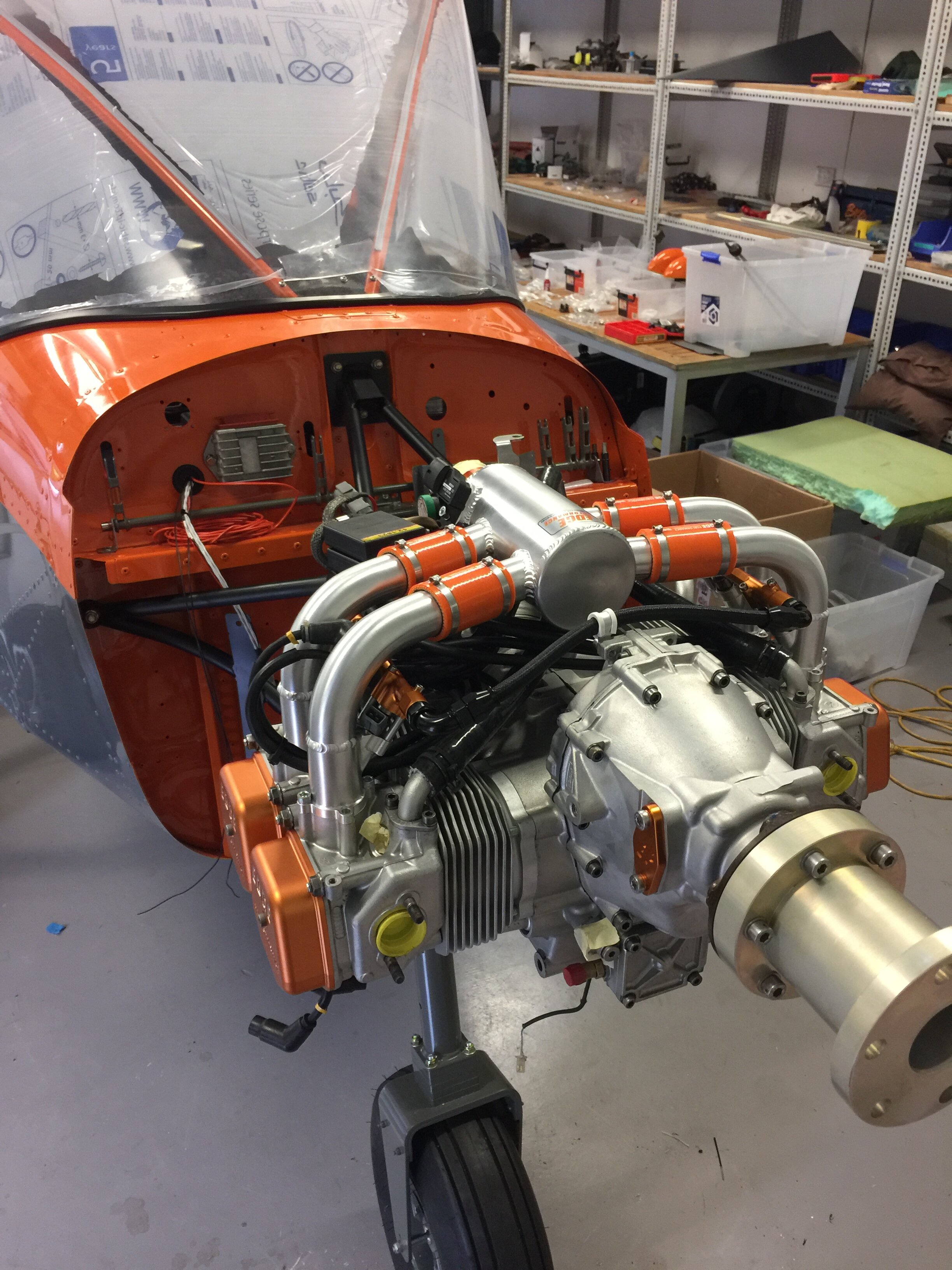

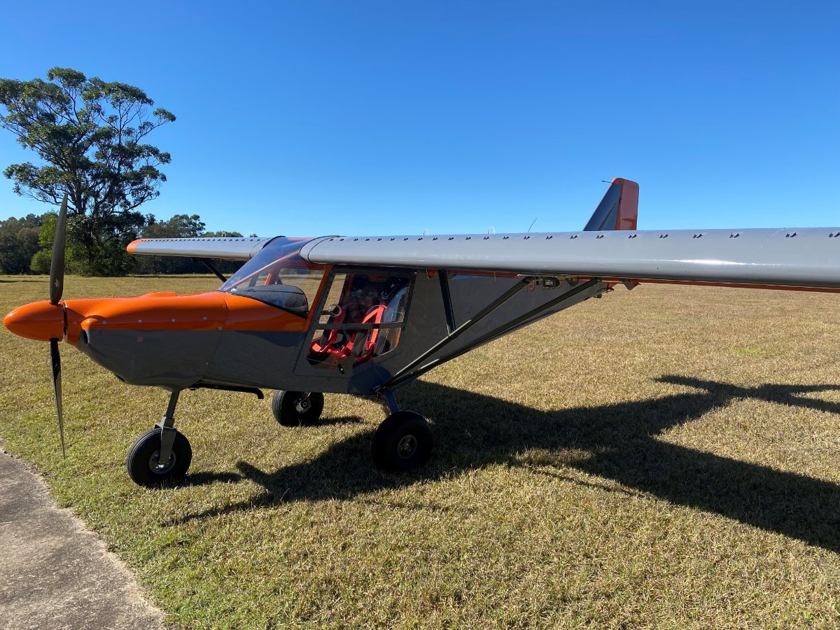

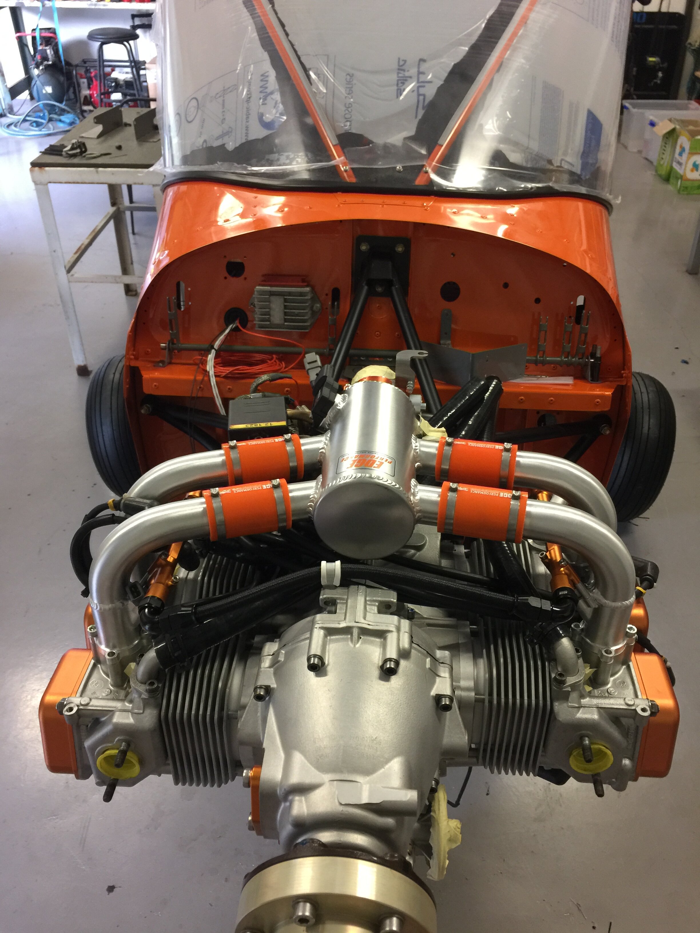

Been some time since I posted on my build. Test flew back in July and I'm only about 10 hours into the RAAus test flight program due to working away from home and poor weather. She flies nice and straight from day one. Only a couple of little issues to resolve, the most annoying being the MGL radio which I will hopefully have resolved next time I'm home. The Edge enhanced Rotax certainly gets her of the ground with 120hp+ under the new carbon fibre cowl. Just playing with prop pitch at the moment also to get a nice balance on cruise speed and take off performance.

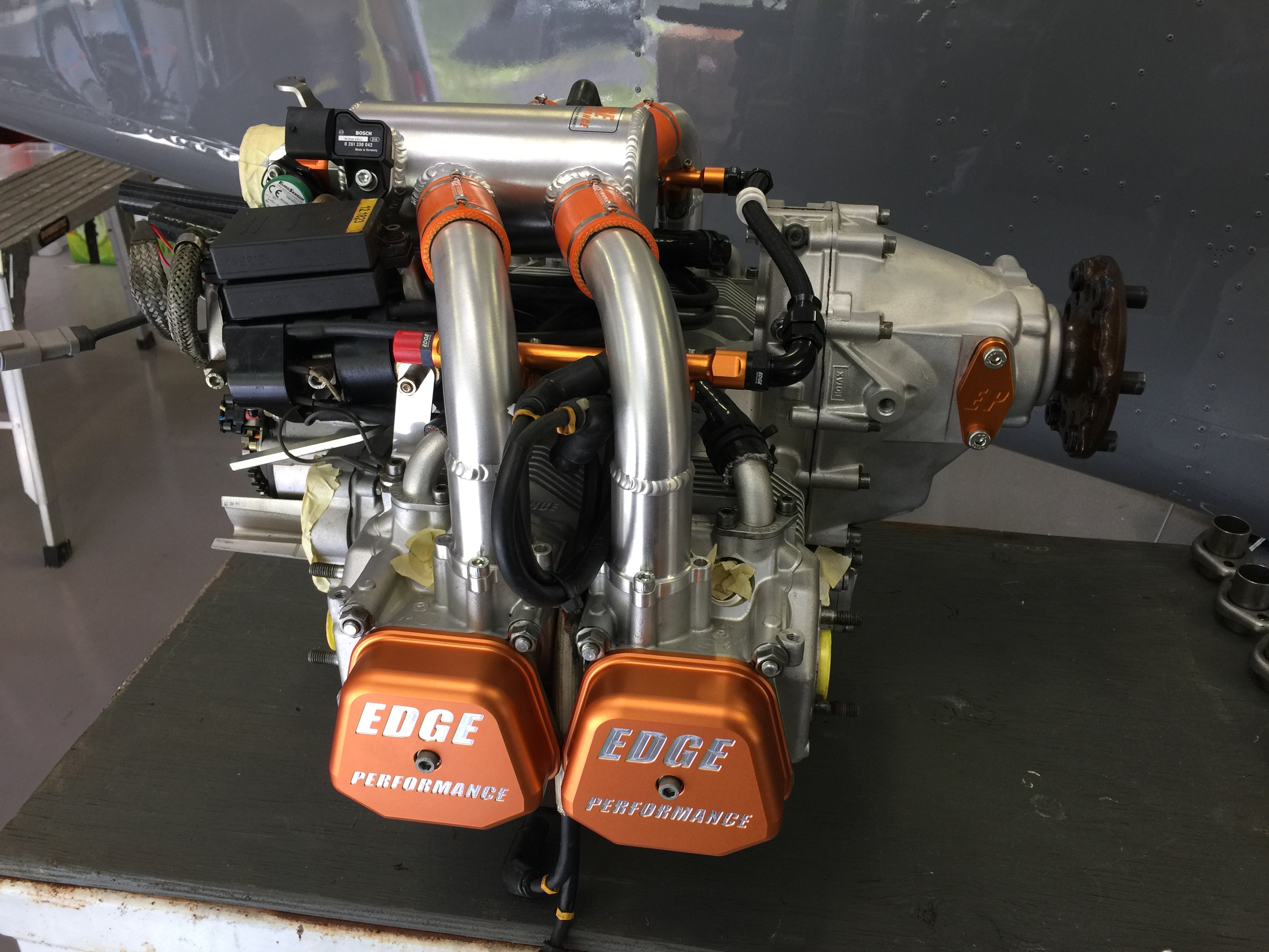

Been busy with a new FIFO job so not getting as much time on the build as I would like. Finally got my Edge Performance part, big bore kit, performance cam and EFI and engine build is complete. Home for a couple of weeks so have the new engine mounted. Next big project is a custom 4-2-1 exhaust doing way with the crappy ICP system.

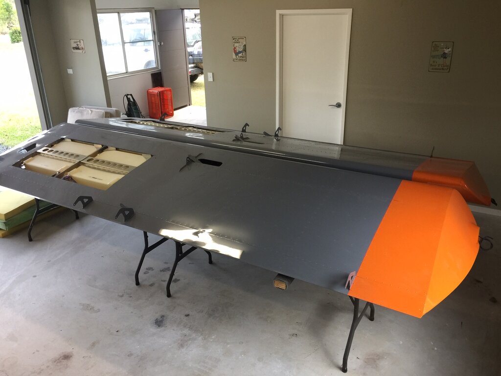

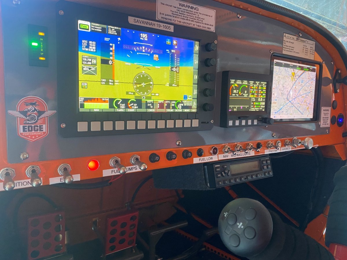

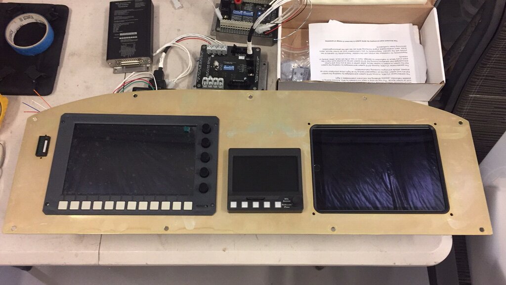

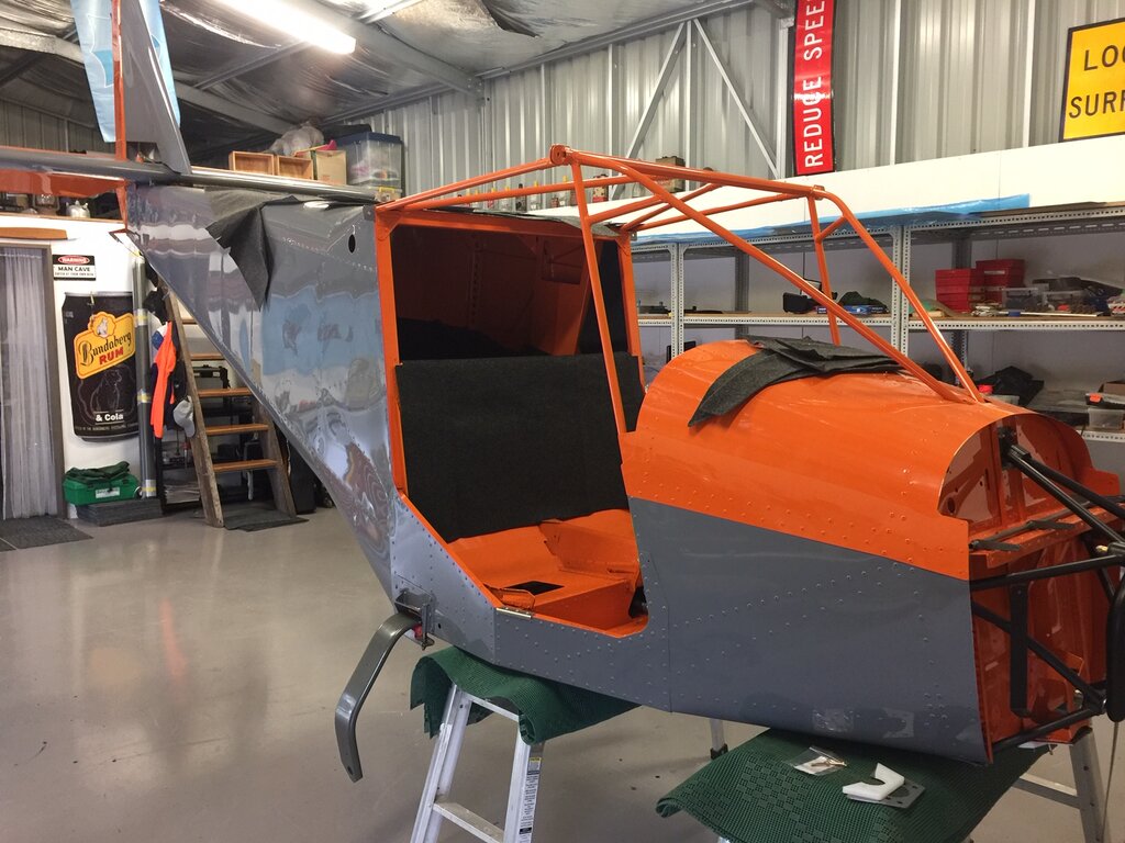

I haven't posted for a while so I thought Id give a quick update on the progress of Savannah 19-1605. Fuselage and wings have both been to the paint shop and I am working on the internal fitout. The panel is a simple glass setup with MGL equipment being used. I gone with a 8.5" Explorer Lite iEFIS as my primary, and a XTreme EFIS/EMS as my secondary. Also fitted a Guardian mini IPad holder for running OzRunways. Also using the MGL V16 radio controlled from the EFIS and a ECB (Electronic Circuit Breaker) which can also be programmed and monitored from the EFIS. Engine build is progressing slowly. Am waiting for big bore kit, EFI and performance camshaft to arrive from Edge Performance and the rest of the components I require for the overhaul from Floods. This combination should put me around 125hp, providing a nice boost of power when it is needed. Cheers Phil

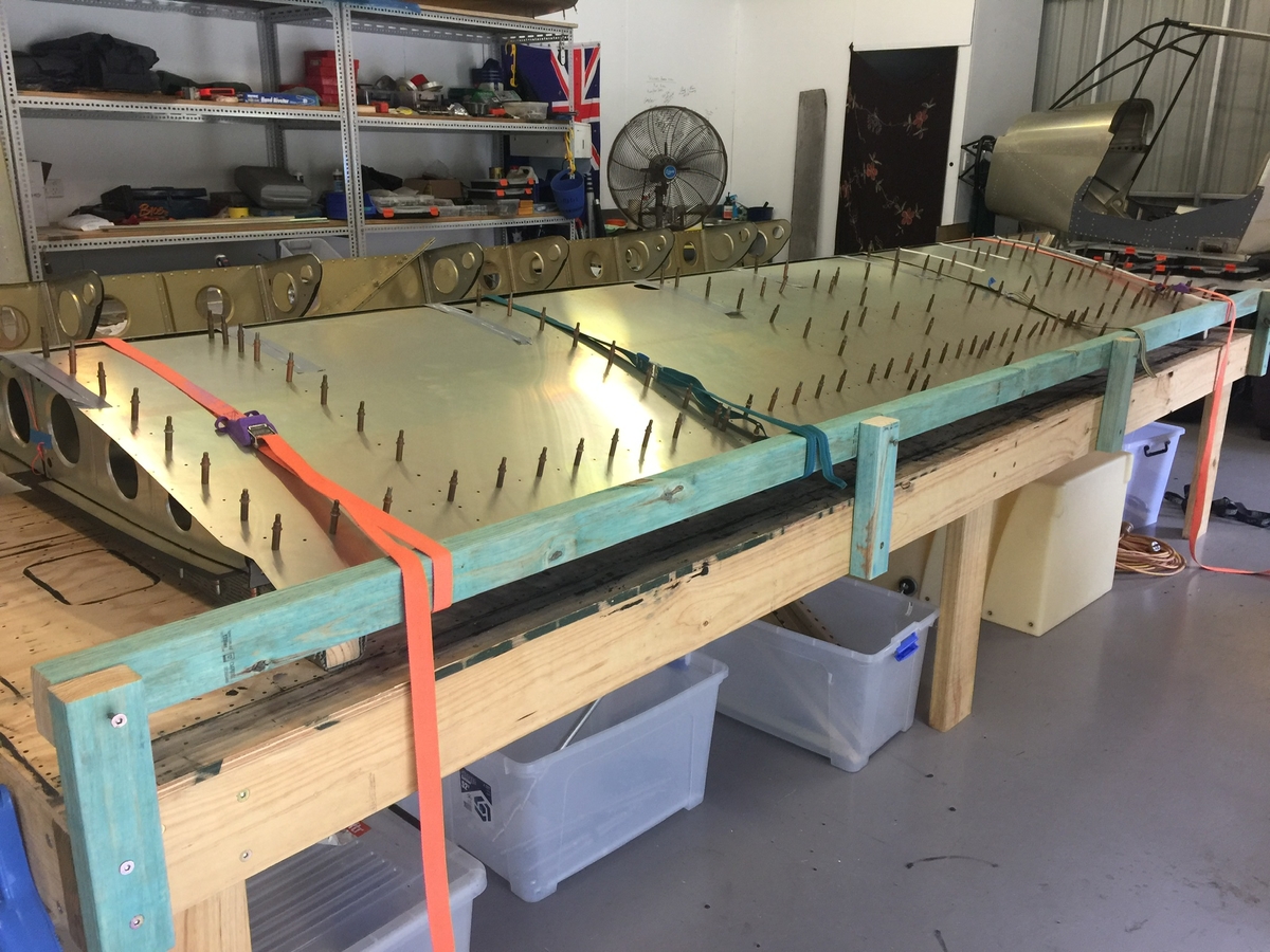

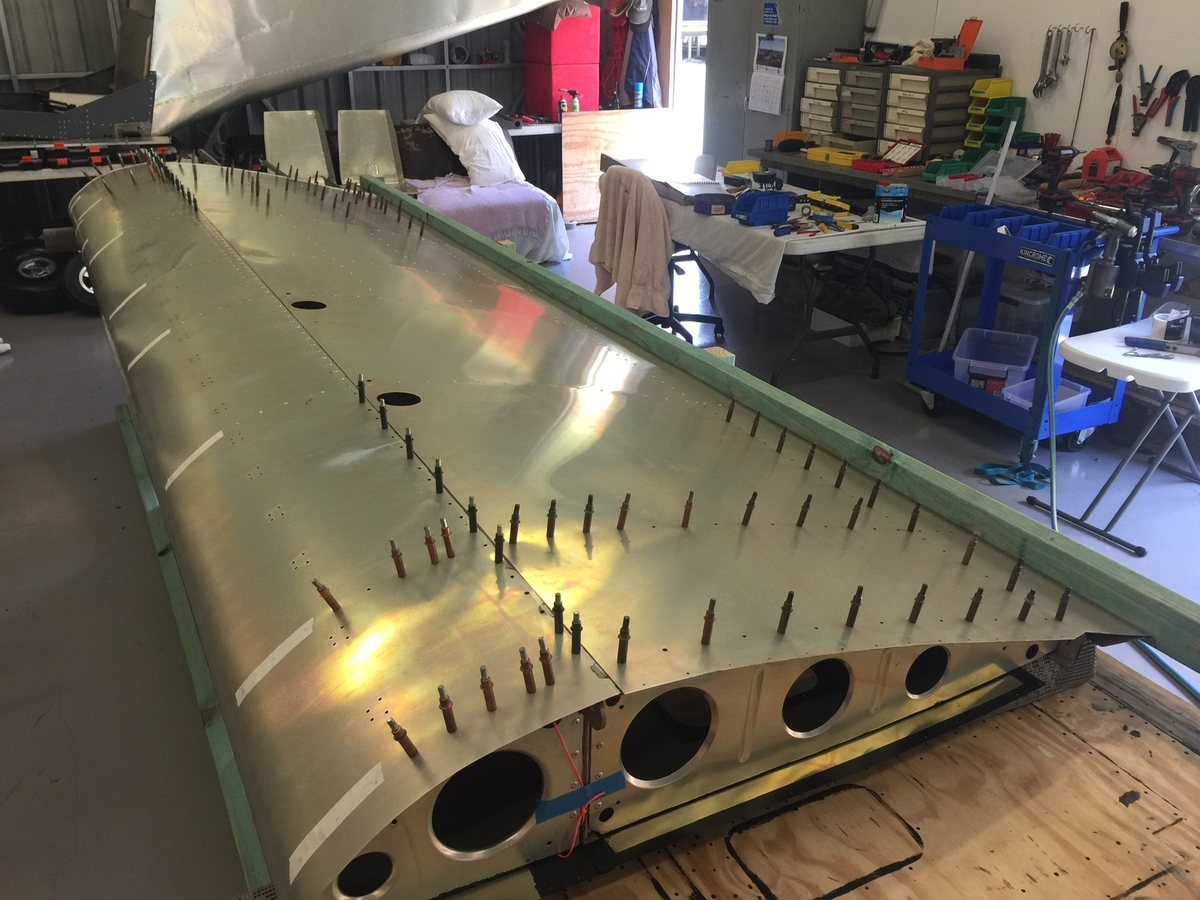

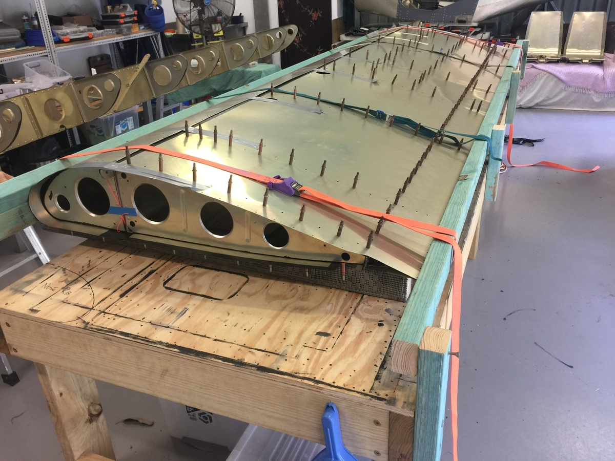

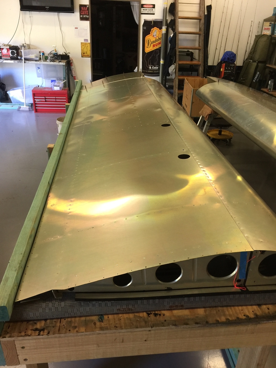

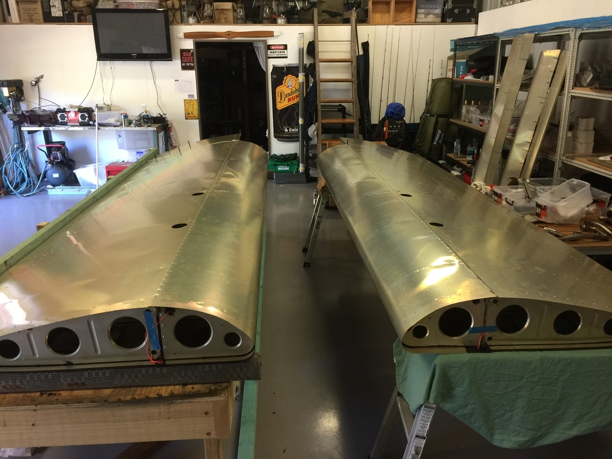

A quick update on my build progress. Have the skins on both wings. Thanks to IBob for the idea of using a fence on the bench and to Bill Grieves for helping me pre bend the D skins. Fuel tanks and plumbing in next. Cheers Phil
