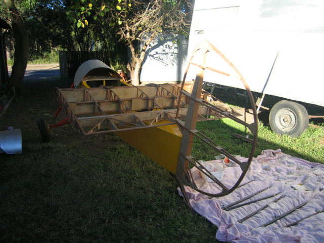

Hi Scott. post some picies and we will soon tell you what it is, I have a complete Hm14 undergoing an engine refit and a partially built 293 that is an exact copy of Freds 290. You must be aware of the severe seating restrictions imposed on the pilot in these types of aircraft. These aircraft are made for small people ( designed for 70 KG pilots) even though the larger pilots who are tuning into this group will disagree with me. I have decided I am not happy with either of my Fleas. The HM14 is undergoing its engine refit to go to the TAVAS museum because the wing has been built with a swept spar ( no flat centre section) and no drag / antidrag struts in the wings. Not safe to fly.. The 293 is 4 inches longer than Freds 290 but my ribs all come from his jigs and the mainspars are made from Canadian spruce imported by me. All steel is complete plus fuel tank and instrument panel. I''m not comfortable in it. I'm 100 KG's and theorically the 293 should not fly me although I have seen Freds short winged 290 flown by pilots 20 K's over weight with no trouble. The trouble you are going to have is when you declare to the RAA that you are going to continue the build. They will want to know the build history and particularly the woods and glues used in the build. Be prepared for this because it will be very painfull probably requiring an inspection by a level 2 authorised inspector. The RAA is PAIIIINFULL to deal with and could take as long as a piece of endless string. Any way put up some picies. If it is a short HM14 fuse it can be extended with Freds authorised mods. At one time when Bob Cornwell was running his Flea site, we knew of all the builders in Aus. On the death of Phil Baligand (293) and the lack of information on the cause of his crash, all building of the Flea in Aus stopped ( there may be a few exceptions I dont know of) You may have the beginnings of a few Bob and I know about. Do you know its build history? Vive Le Pou James

Sorry we got out of sink with the picies posted of the modified 14 and my comments. I must get mine off the trailer this week and begin to mount the Henderson. My 14 has the curved mainspar and was built from Henri's book, so no flat centre section or folding wings or extended fuse. Looks 1934 Authentic and I dont want to mess with it so that it looks like a late era build
Yes I plan on raising the 14 of the ground more than it is. My 14 has a solid axle and relies on big rideon lawnmower tyres to provide suspension. Too close to the ground and thats how I flipped it> whose flea in the photo?
