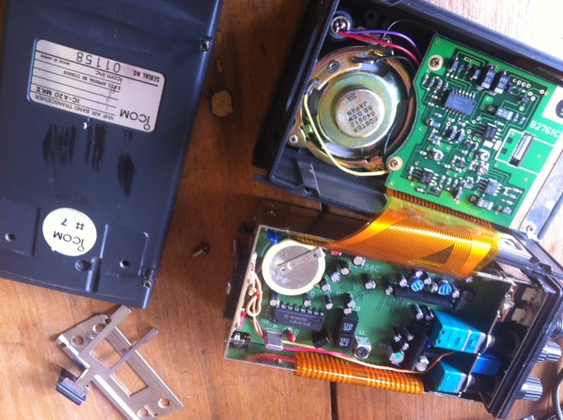

Icom IC-A20 MK II - it won't go..!
Tomo replied to Tomo's topic in Instruments, Radios and Electronics
You're a legend, thanks I'll do that for sure. Shoot us your mailing address when you get back and I'll chuck it in the post... Have to borrow one in the interim as I'm taking the plane on Holidays next week! (they always know when to cark it don't they!!) -
I've got a slight problem... I accidentally left my radio on the other day - aka master switch - on my plane and flattened the battery dead as dead. More frustration than anything there... however now after charging the battery I come to turn my radio on, and it ain't turning on! Found a blown 1 amp fuse which I thought was the problem, so I excitedly fitted a new one, being happy that it was such an easy fix! My joy was short lived however, when it only lit up the backlight on the radio and nothing else.... So I've dug deaper and pulled the radio out of the plane and have pulled it apart...hoping to not find a fried mother board or something - which I didn't. I did find a little 3v button battery in-side though, and it gave me the thought that maybe it has gone flat flat and now it won't let the cpu work or something. What do you educated fixerers think? If I leave it on the power for a while will it get recharged or should I pull it out and fit a new one? Or am I barking up the wrong tree completely and should I go back to swinging spanners instead? Thanks! Ps. Here's a photo of the inards of the radio and the little button battery. (why the photo is up-side-down is beyond me, I took it standing on my feet, honest!)
