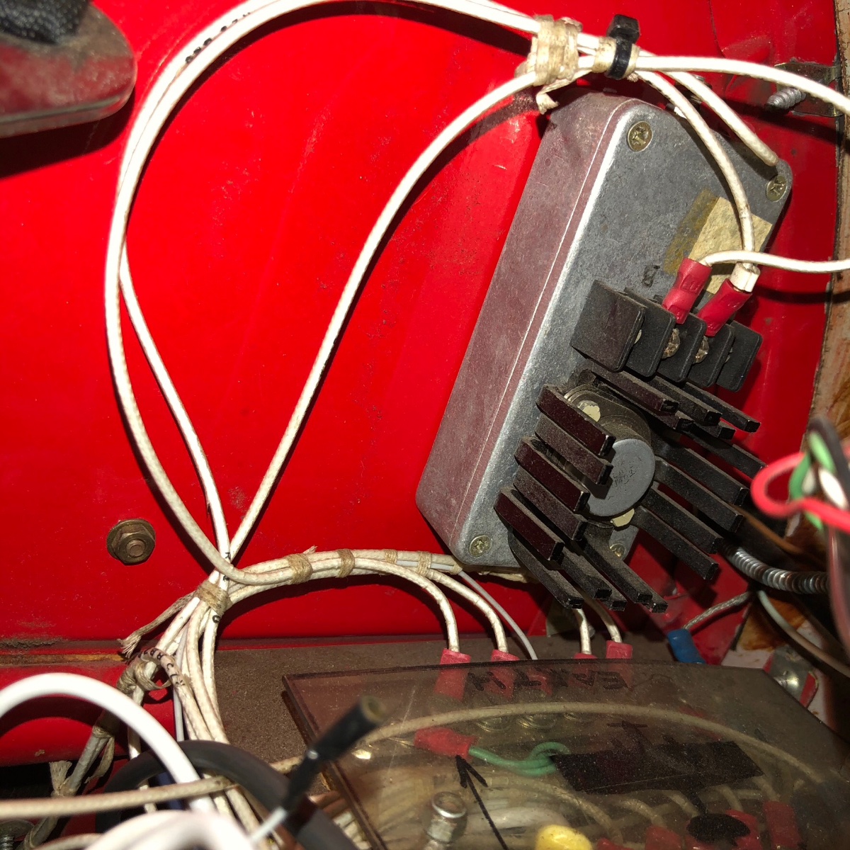

  1. Update........🥴 Alternator removed for refurbishing. Replacement Bosch Voltage regulator on way too. All under LAME guidance and figment.
  2. I shall get back with that answer!
  3. I was concerned about the fuses too, checked all satis. i have since test flown the aircraft and the charging system is now correctly charging.
  4. Hi flyers, Well the silver box was in fact full of electronics! Yes I believe home made! But........with an adjustable volt dial inside the box. Sorry I couldnt take a picture with the box open. The LAME’s hand were in the way. End result Alternator checked OK ✅ Voltage regulator readjusted to 13.9v ✅ A very interesting exercise, I learnt a lot, and will promptly forget tomorrow! I do now have a spare Bosch RE55 in my tool box if the above fix is not ok. Thank you for your knowledge gents!
  5. Thanks Nev, I thought it might be a homie! The alternator is a Mitsubishi car alt, I have the ident number. It would appear to be from the around the 1990s at a guess. I have tried an internet search for the alternator, no joy yet but early days. Yes it’s belt driven.
  6. Howdy Gang, Help is needed to ident this voltage regulator thanks. If some one has the slightest idea on make n model have a go thanks. Overvoltage issue on an aircraft engine with a car alternator. 15.8v, no adjustment available. Three wire version? I haven’t traced the wires back yet.
