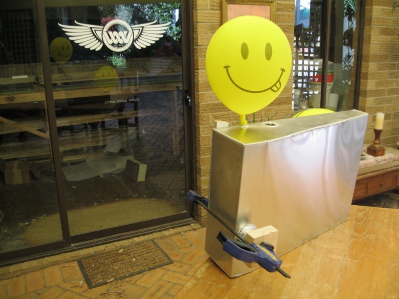

  3. Gents, I have some comments on leak testing in this thread that may be helpful. I recently needed to leak test two wing tanks and the main tank for a Dakota Hawk I am building. I first used balloons filled with air (a safe low pressure test) and looked for bubbles. Aircraft grade Balloons and bubble liquid were bought from the local party shop. I found one very small leak. The chaps in the club were a bit sceptical about this test so I went back to the party shop for some helium filled balloons. ($1 each) I fortunately have access to a helium sniffer gun. This is a very sensitive method. The Helium molecule is small and if there is a path is will escape. It will pick up your breath if you don't brush your teeth. By this method I quickly found a second leak. On redoing the bubble liquid on the second leak, and knowing where is was, I could just see it. My conclusion is this. You can miss small leaks by immersion in a water bath (the supplier did). An air pressure test with bubble liquid is good but you have to go over every joint very slowly and carefully in order to see a small leak. Helium and a sniffer if you have access to it is the best. It also is a way of sometimes testing in position as the instrument probe has a long nose for sniffing and a small vacuum pump. The instruments voice gets squeaky (beeps) if it finds a leak in the vacinity. I made the mistake of not washing the bubble liquid off and it dried and it has marked the aluminium so there must be some chemical in there. I suggest you wash off with water immediately afterwards.
