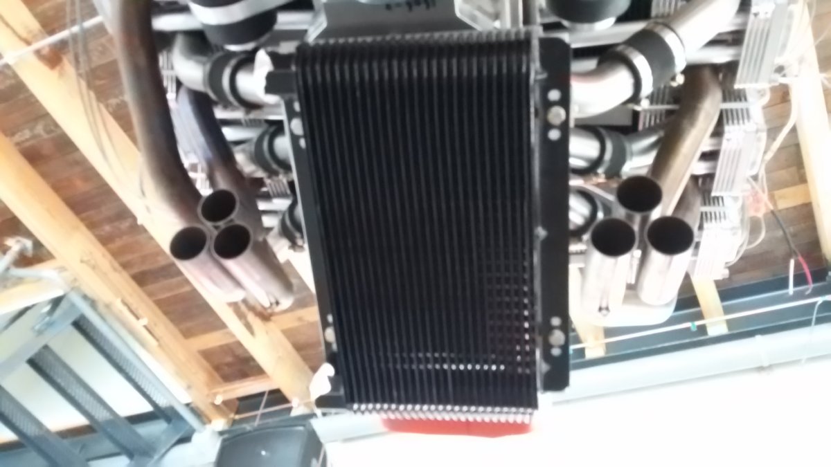

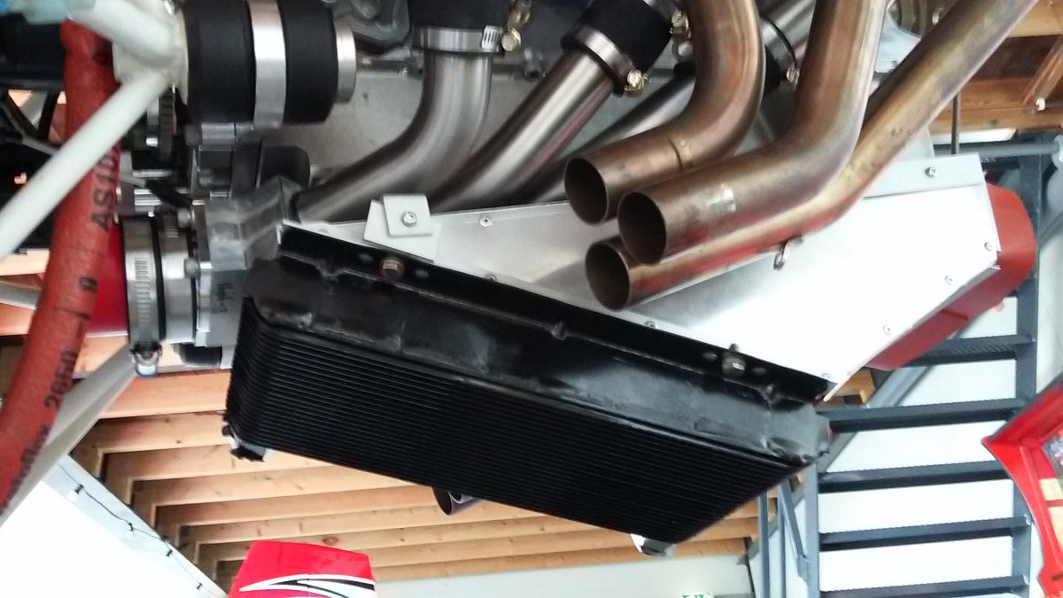

Thanks! I built a plenum around the sump so the air passes along the sump and through the oil cooler, then down and out through the bottom of the cowl. That way it doesn't upset the low pressure needed for head cooling too much. Got two 3-into-1 CAMit mufflers, so there's ample space. The cooler is a universal type, I got it from a local VW hotrod shop: https://www.hotrod.nl/shop/contents/nl/p3271_Oliekoeler_element_48_rijen_____280_x_190_x_40_mm_.html I've seen similar ones in webshops around the world. In retrospect I should have gotten one size smaller, perhaps I'll swap it out later this year.
I'm using your Version 2 on my CAMit engine install. Works a treat, most of the year I have to block a large portion of the cooler to get the oil over 80 degrees C. Thinking about exchanging for a smaller cooler.
