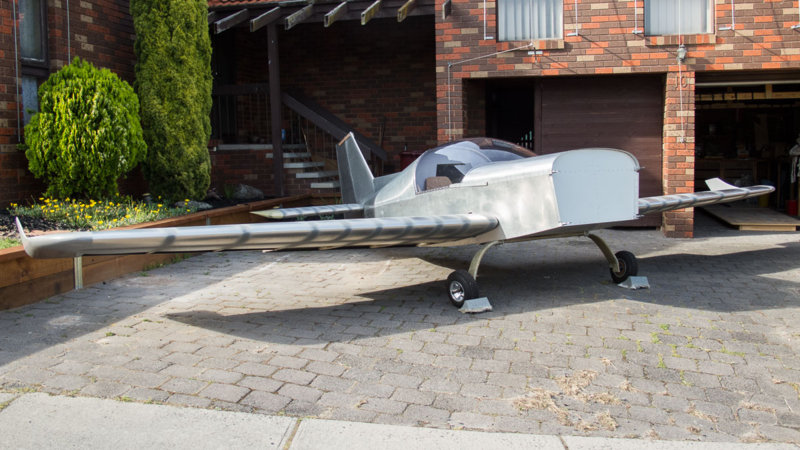

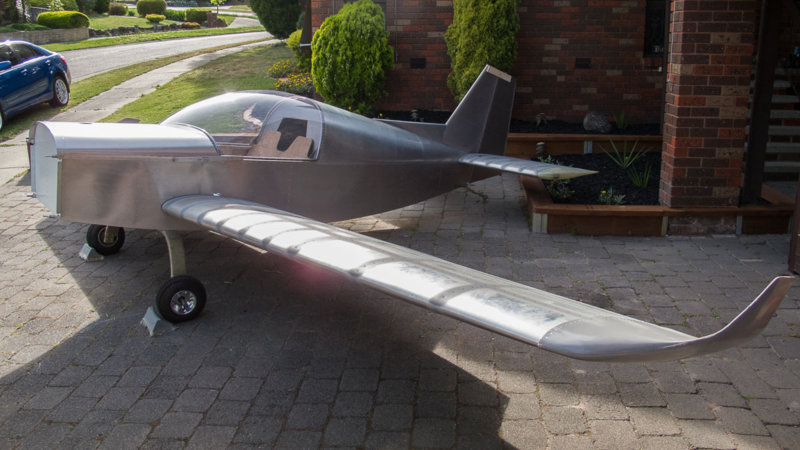

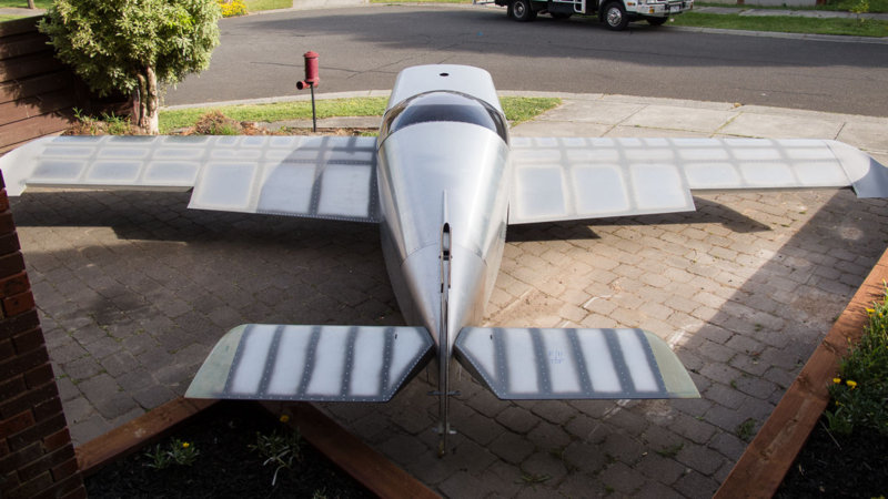

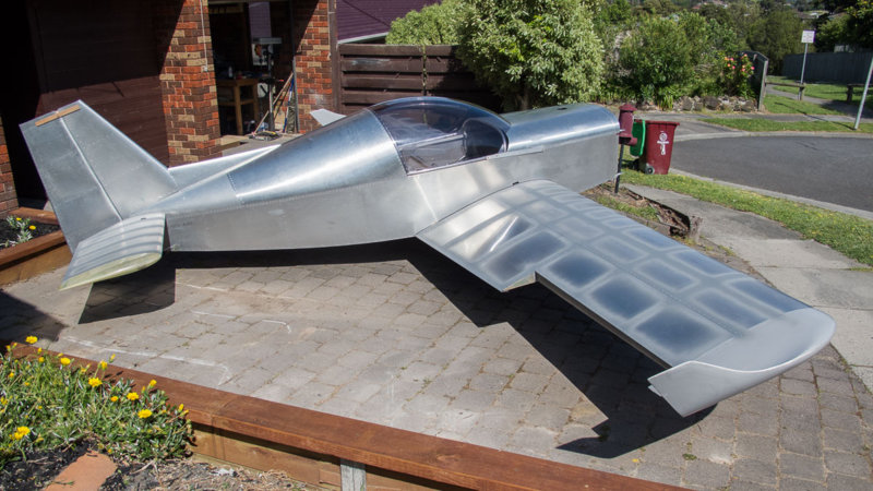

Hey Guys, I have been working on updating my Blog with HEAPS of info but it is taking me a while...sorry! I hope the following video is enough to tide some of you guys over for now til I get the blog up-to-date. This was taken on my phone (the quality is not the best) on the 19.01.10 and illustrates where we are currently in the build (sort of). What you are seeing is the Wing Spars with Ribs attached, rigged up on the fuse to get the angle of incidence and location for the rear drag spar. Currently the drag spars are in position and skinning of the fuselage bottom has been completed. Next is the Fuse side skins and then onto some serious wing build'n fun. [YOUTUBE]<object width="425" height="344"><param name="movie" value=" type="application/x-shockwave-flash" allowscriptaccess="always" allowfullscreen="true" width="425" height="344"></embed></object>[/YOUTUBE]Cheers, Toby
