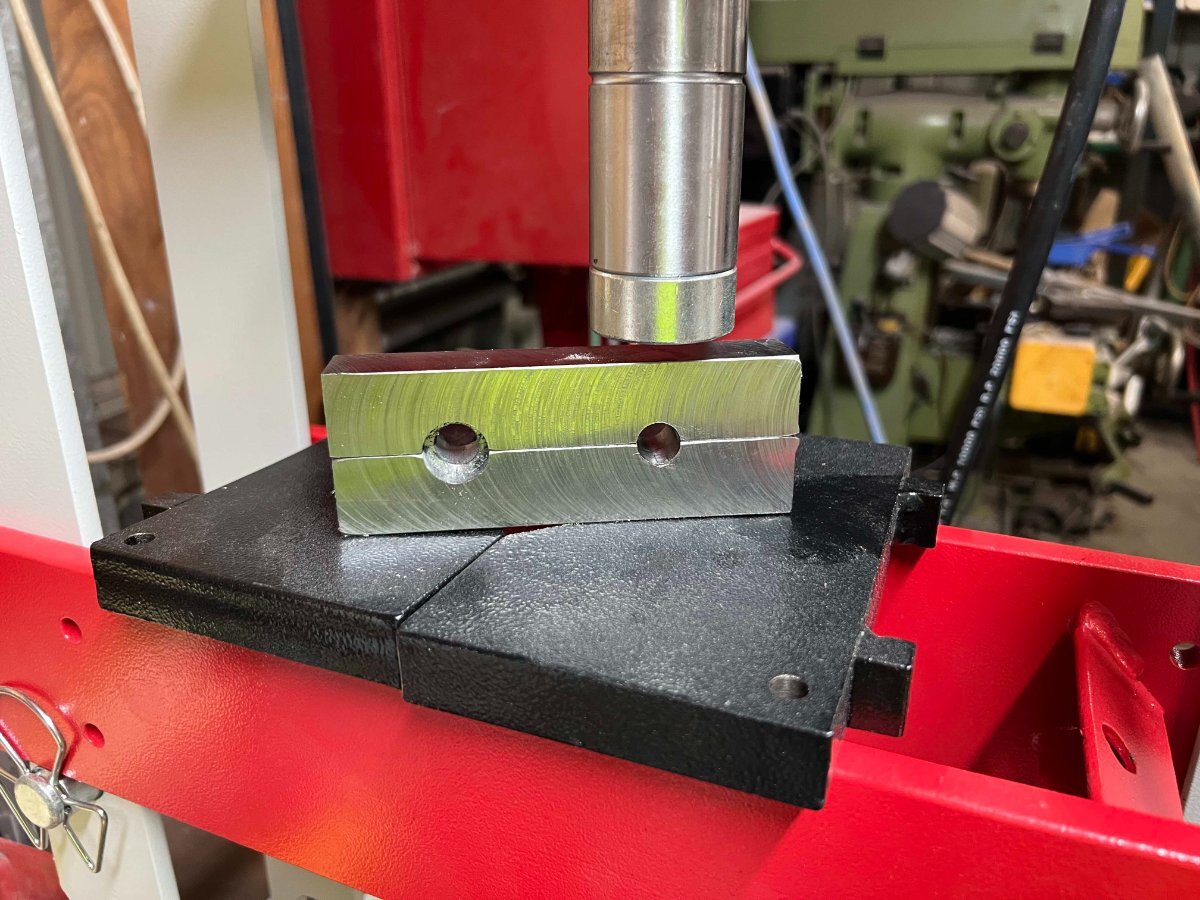

Mothers Day Busy day 🙂 Cooked the boss and her mothers breakfast this morning...sanded the lower cowl ready for some fine filler...that being all done preped the bits for the throttle kits so I can get some done. Went over to Danny's place and turned the tubes to size...used a different tool tip..circular ones. Works better on the stainless and doesnt distort the tube so I have ordered a few of these tips so I can do the rest of the tubes. Got 5 units tig'd up just have to pickle them and will set them up to make sure all is correct and I think I will be ready for production. I need to be retired...its been a big few days 🙂 -

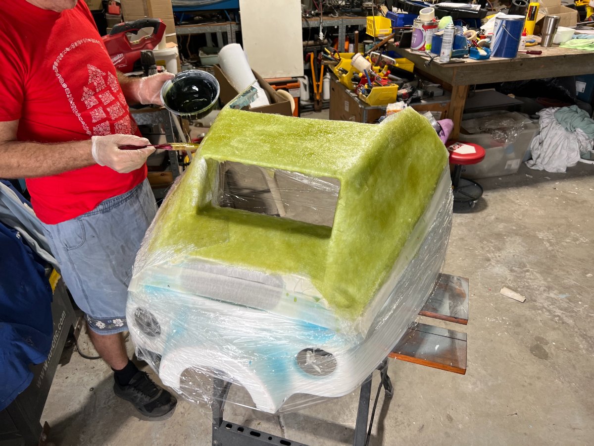

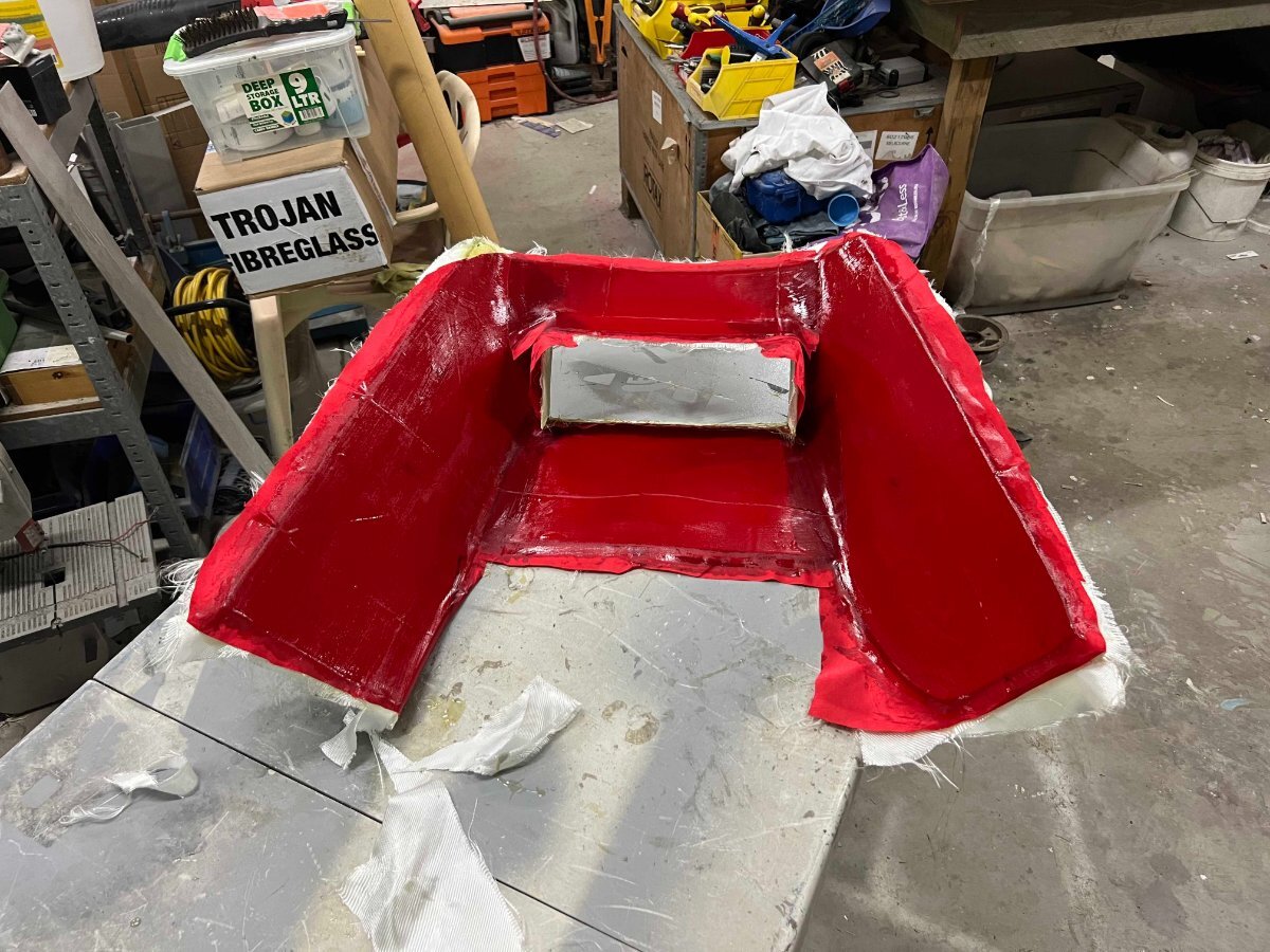

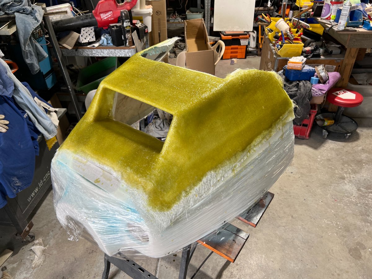

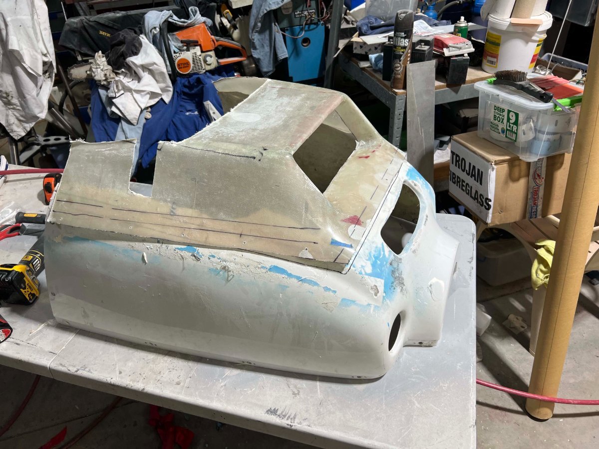

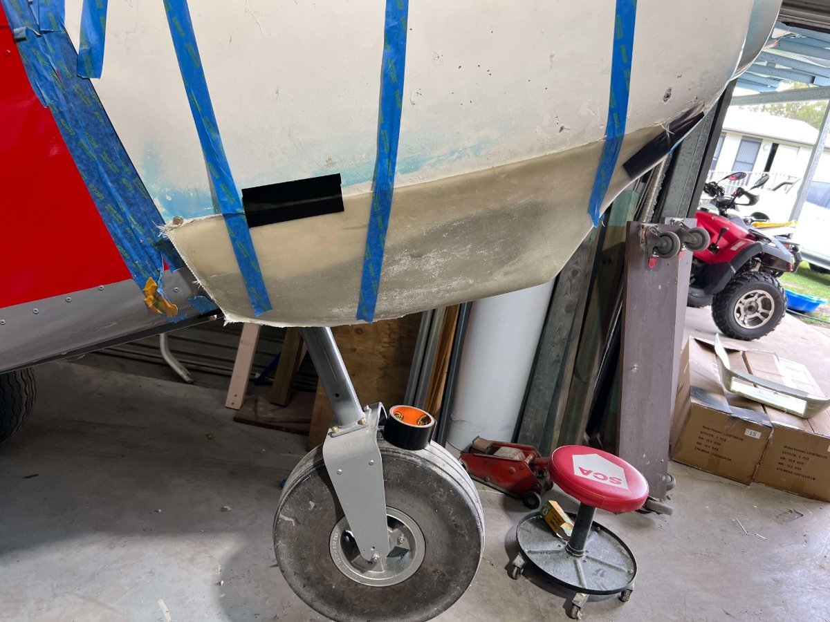

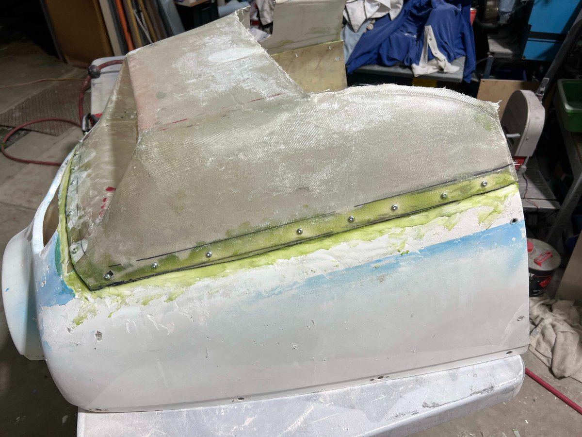

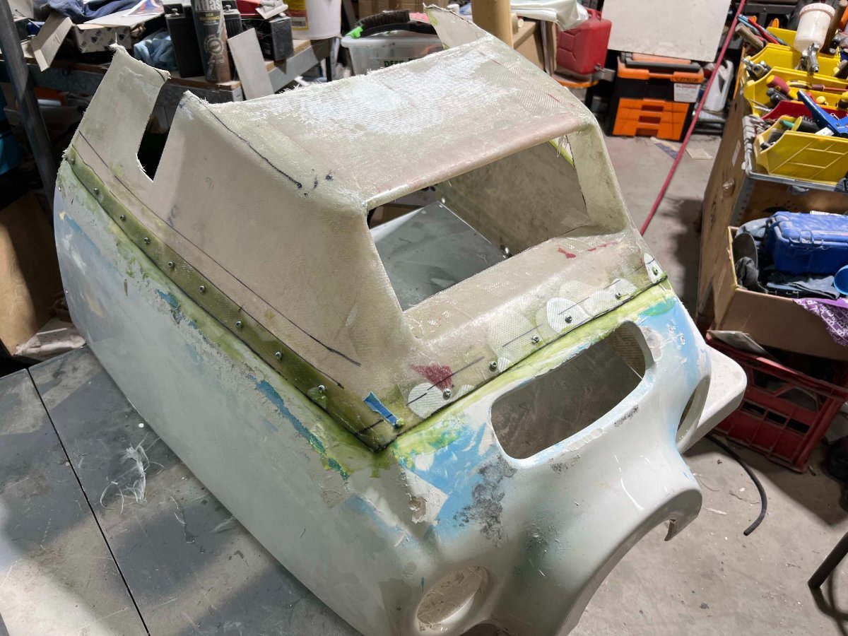

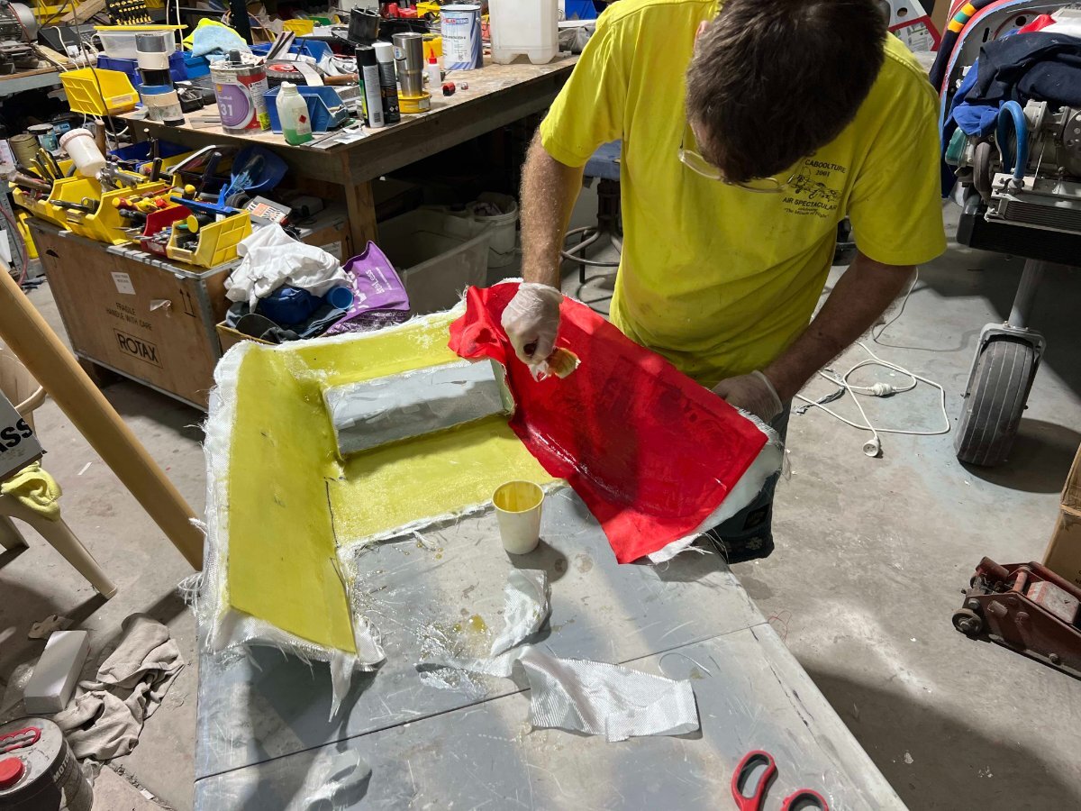

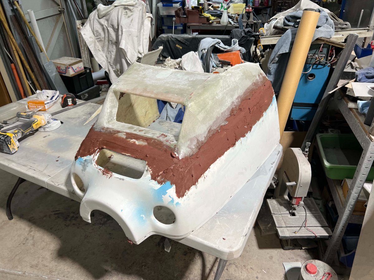

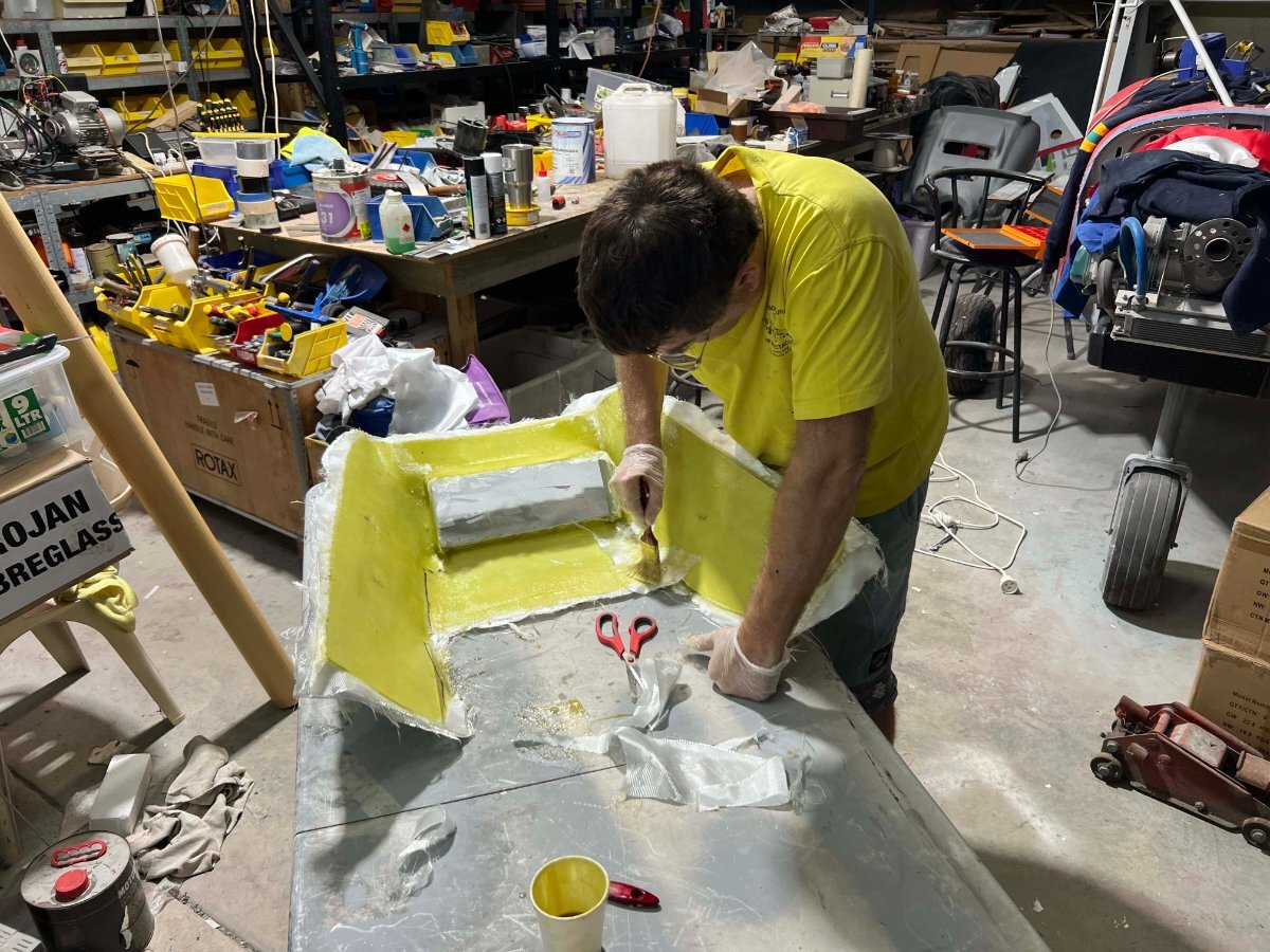

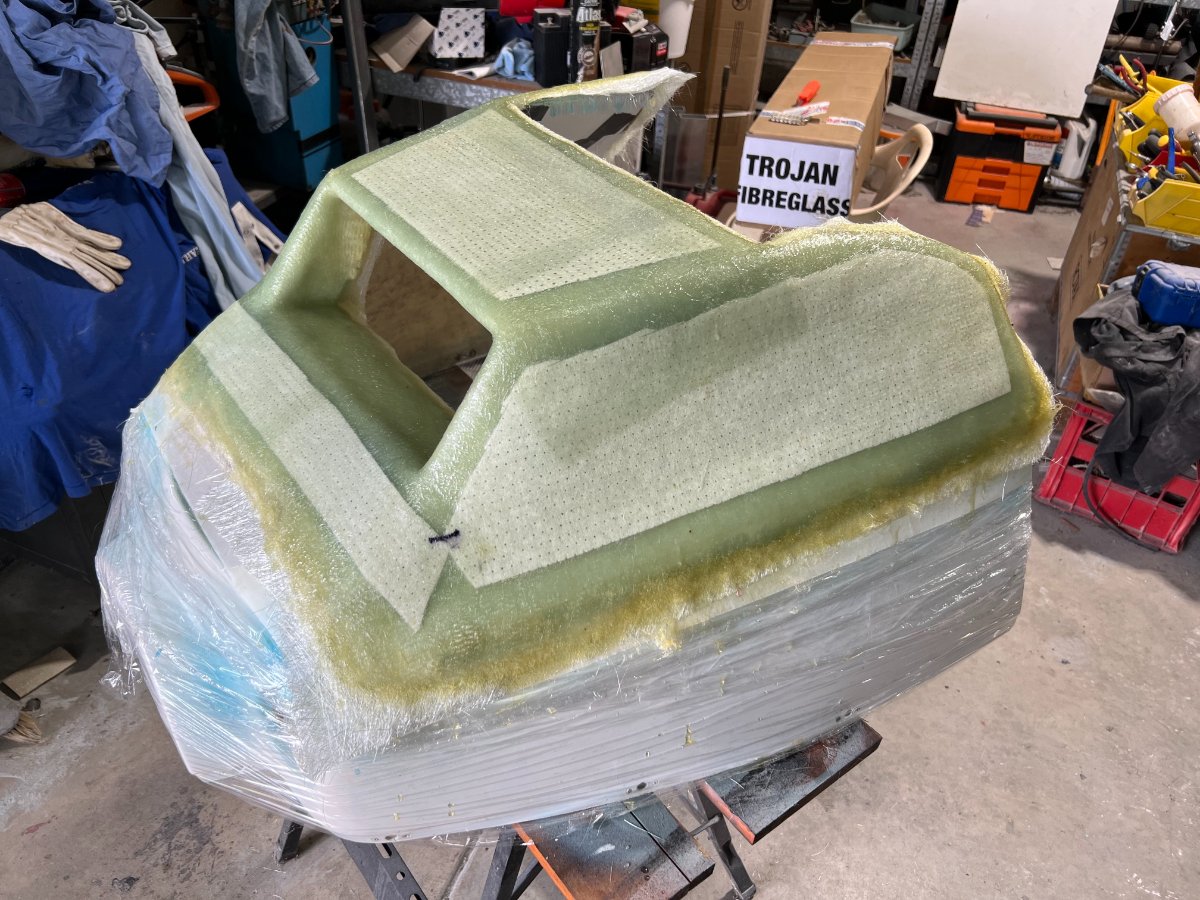

Mike I am working as fast as the resin will allow me 🙂 Glassed the joins on the outside and inside for the strength and also put some core mat into the flat bottom to strengthen it up. pretty happy with the finish by using peel ply (nylon) the purple stuff in the above pics , over the areas and squeegying it..when you pull off the peel ply when the resin has set properly and it leaves a great surface and of course gets off excess resin. Need to trim it all up now as well. Will let it go off more and do some initial sanding tonight hopefully then hit it with the fine filler tomorrow morning. Let it dry as I am going over to Dannys place in the morning to get some of the new throttle system kits tig welded so I can get them away. Got people chasing me like crazy for them. Just havent had enough time to spread across so many projects 😞 -

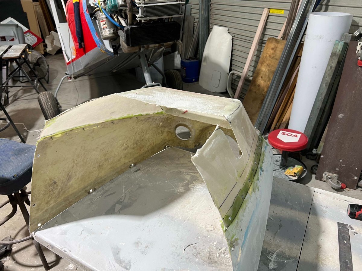

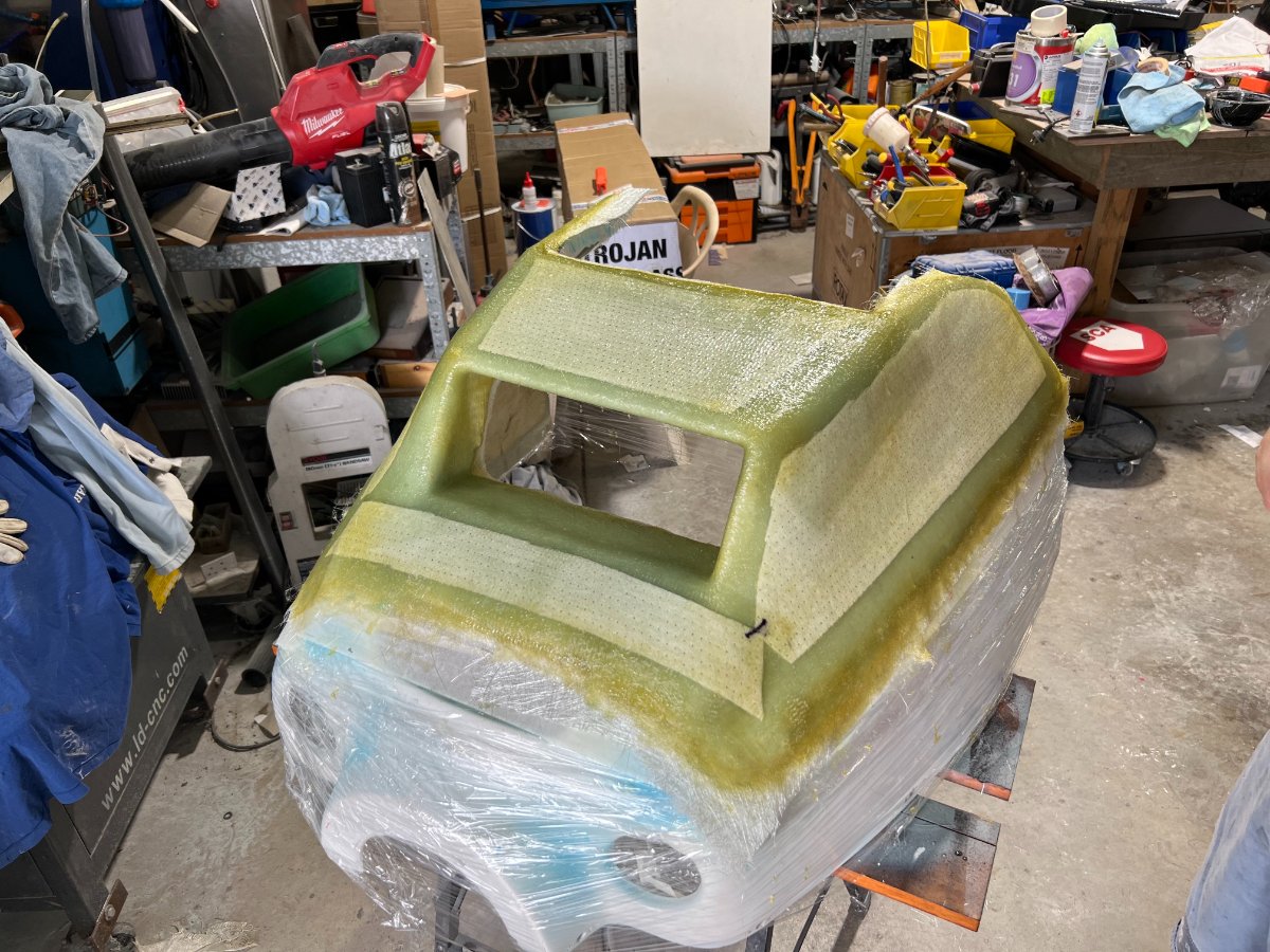

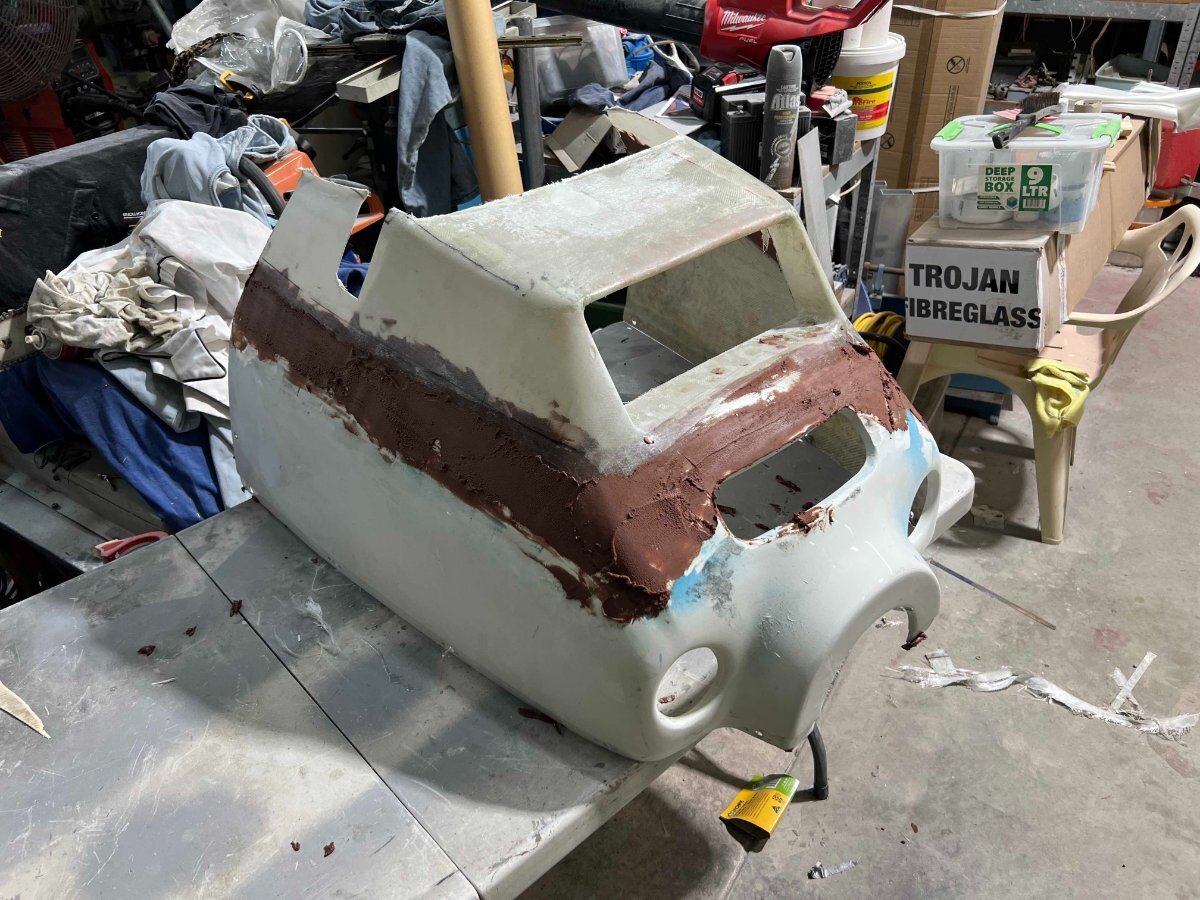

With any luck this maybe finished by the end of the weekend. Sanded the filler to shape over the joins and now layed some nice twill weave glass over the outside joins all the way. peel ply on so will see what its like tomorrow morning..might need to get the heat lamps on it as I want to get that peelply off later in the day. The inside join areas have been filled and I still have to glass that but can do that first up in the morning and the heat lamps will help that as well so all should be fine. Will need to put some coremat on the inside bottom as its a bit flexible also maybe on the sides...I will decide after all the joins are done -
