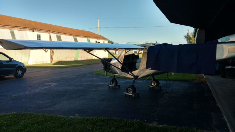

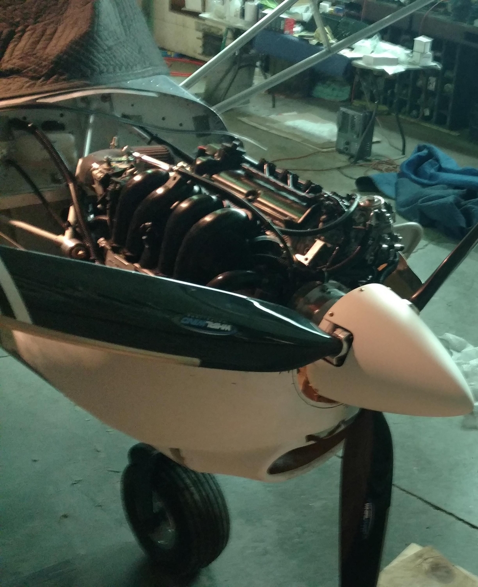

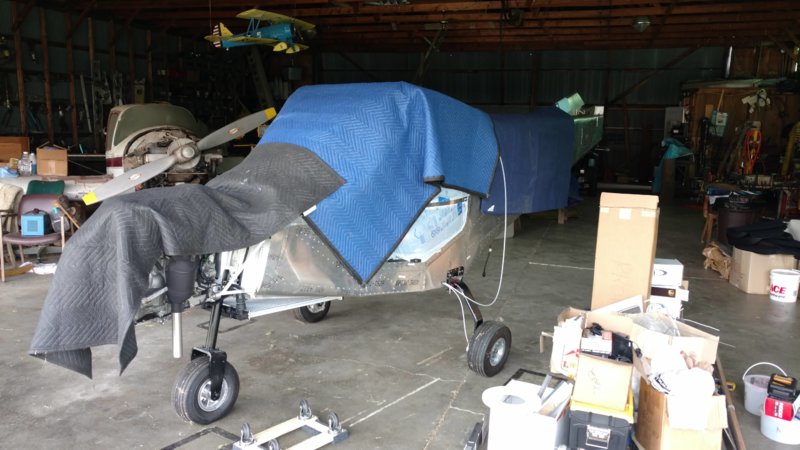

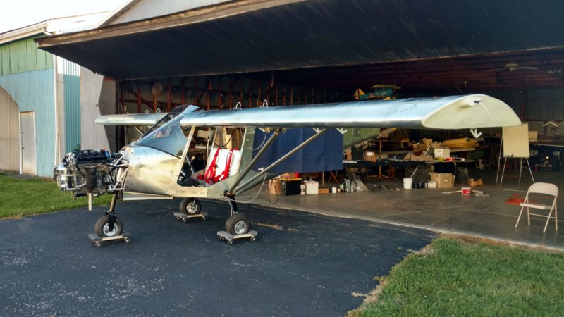

Okay guys I know it been quite a while for me but I just wanted to get you all updated on progress being made. We did a thrust test today and here are the results. 545lbs of thrust with a Viking 130 and a 68” whirlwind spinning at 5700 rpm. I obviously have to adjust for a bigger bite but man that engine just sings. That’s a lot of thrust for a 770lb Savannah S. I know that sounds a little heavy for a Savannah but I’ve gone a little overboard on all the “extra” things I wanted. Glove box, self designed center pedestal, extended range fuel tanks among other things. I wasn’t as concerned with the final weight as some. Im very happy with the number that came in. I also figured the balance today and with no ballast were right at the forward limit of the cg assuming a 200 lb pilot (me on a good day?.) I purpose built the airplane to avoid ballast. Don’t let anyone tell you the Viking is too heavy. Great day today. [ATTACH]38791[/ATTACH] [ATTACH]38792[/ATTACH]
