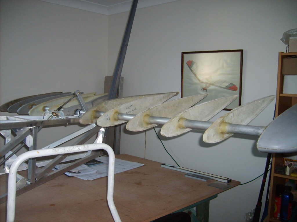

kgwilson Posted May 30, 2011 Share Posted May 30, 2011 Garry let me know my Sierra Kit was ready a little while ago & while I was champing at the bit to get going there are things in life (when you have a wife and a new house that according to her needs a few... well lots of changes plus gardens landscaping etc) that have to be done in a pretty quick order. And I always thought retirement was going to be "My Time". Not so but I knew the time was nigh and went to Taree last Monday just in time to check out Kevin Harrison's new S200 before he headed back to Adelaide with his brand new baby. Nothing really began till nearly lunch and I cut out a whole bunch of gussets and linished them all up, laid out the longerons and all the right sidewall framework with the steel fuselage central cage on the bench template and proceeded to rivet them all together. Some gussets required trimming for a neat finish and I was slow and deliberate but by about 4:00pm I had the first side done. Tuesday dawned cool but sunny with a reasonable westerly breeze. We said our goodbyes to Kevin and Karl and I went back to look at the beginnings of my Sierra. I then turned the frame over and laid out the other side on top to create a mirror image left hand side. I finished this before lunch. Next was to bolt the steel central cage to both sides and then to join them at the firewall end. The sides needed to be pulled in with some ratchet ties to a precise width and the gussets rivetted in. Then the steel engine mount pins were added. After that the seat top and bottoms were bolted in. Again slow and deliberate and I kept checking the plans and manual to make sure it was right. Garry and Tim just kept on working to their own schedules unless I asked a question. Wednesday the weather turned cold and very wet, a good day to be in a hangar. Made a few mistakes and realised that I still needed to think the process through. i.e engage brain before putting body into gear. Pulled the tail in with the ratchet ties and installed the tail fin. Plumbing it was a mission but my perfectionist attitude took over and after a long process got it sussed. Thursday, pay for it day and home. Garry had generously offered me his aircraft trailer to get everything back to Corindi Beach. Got home just after dark. The trip computer showed 7.8 litres/100km going down and 18.5litres/100km towing the trailer coming back. Wow. Now it's on my bench in my garage and I have spent the last day identifying every nut, bolt and part to try and build a good mental picture of where it all fits together. Now the building fun really begins. Watch this space for progress reports. Cheers Kevin Link to comment Share on other sites More sharing options...

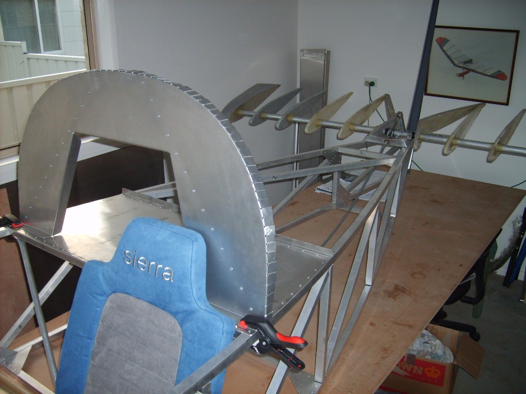

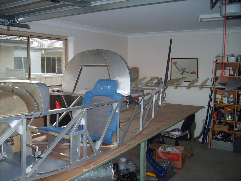

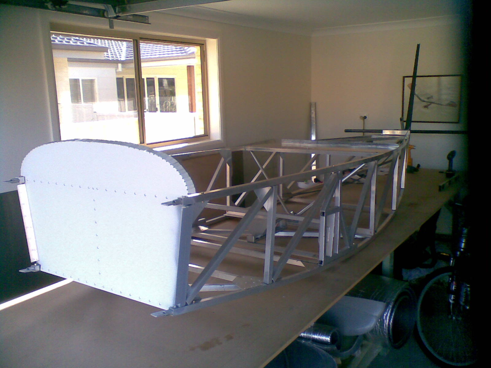

kgwilson Posted June 18, 2011 Author Share Posted June 18, 2011 I now have a completed fuselage frame with the firewall, seat bracing, parcel shelf and the elevator spar installed. I was about to install the cable and control box when I realised the cable was too short. Id been given a dual control cable by mistake & it is about 25mm shorter. I'll get the correct one next week but I'll just carry on with the build & install the floor & fuel tank next. The fuel tank will take a while I think as there are several bits to it with baffles that have to be fibre-glassed in, the 2 halves joined, fuel cock & drain plus the filler cap & neck. Boy did we have some rain this week. 400mm in 48 hours & on Tuesday morning at around 6:00am the manhole cover in the garage disappeared up into the roof cavity & water was forced in past the sectional lift door & all the Sioerra parts that were on the floor were now on a wet surface. Plus all the Aluminium sheet nicely stacked against the wall with the ply sheet in front got sucked off the wall & were now all leaning on the bench. This saved them from damage & the ply sheet was wet for about 15mm up from the floor. I dried everything and it all now sits on blocks. The ply dried naturally & there isn't even a water mark on it. My biggest shock came from finding a major abrasion gouge on one wing spar angle. This must have happened on the trip home & I never saw it when putting everything away. Anyway I now have a couple of good solid angle straight edges and work well as a manual sheet folder when clamped in a vise. One new spar angle required though. Here are a couple of pics of the build to date and the spar damage. I can't download photos from my camera at present due to our 11 week old puppy finding his was into the office and deciding to chew up the camera data cable. Luckily the phone camera & cable still work. Link to comment Share on other sites More sharing options...

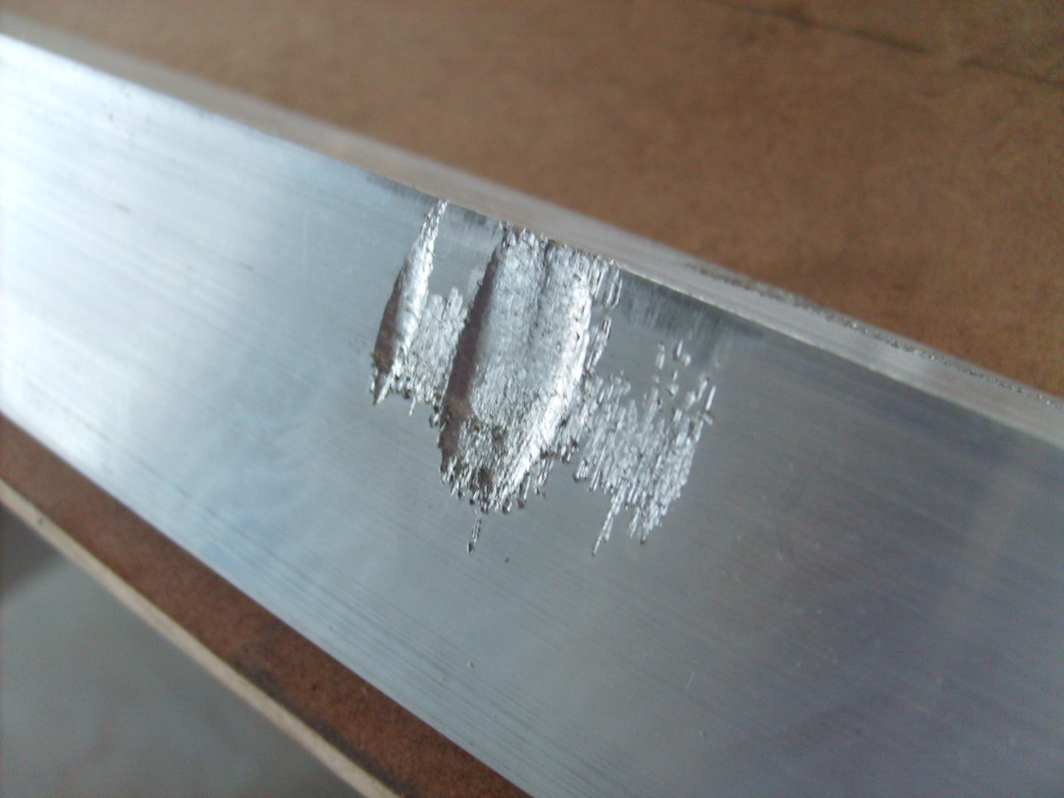

kgwilson Posted June 19, 2011 Author Share Posted June 19, 2011 Well the damaged one is now in 3 pieces. One 2 metre length is good for something. The other 2 1.1 metre lengths are now clamp straight edges. Link to comment Share on other sites More sharing options...

kgwilson Posted June 20, 2011 Author Share Posted June 20, 2011 I figured it was just because of the stone damage as Kevin came back from a flight along the beach the day before he left Taree & told us he'd got 150 knots & joined overhead at 140 knots. Garry has always claimed that the 3 blade props don't perform as well so you have proved this now. Cut the floor today & spent about half an hour trying to get it in without success. I've checked the fit both sides and front so its a matter of technique. Got it 3/4 in & then had a real hassle getting it out. Now I am going to trim it, sand and paint & then have another go. Kevin Link to comment Share on other sites More sharing options...

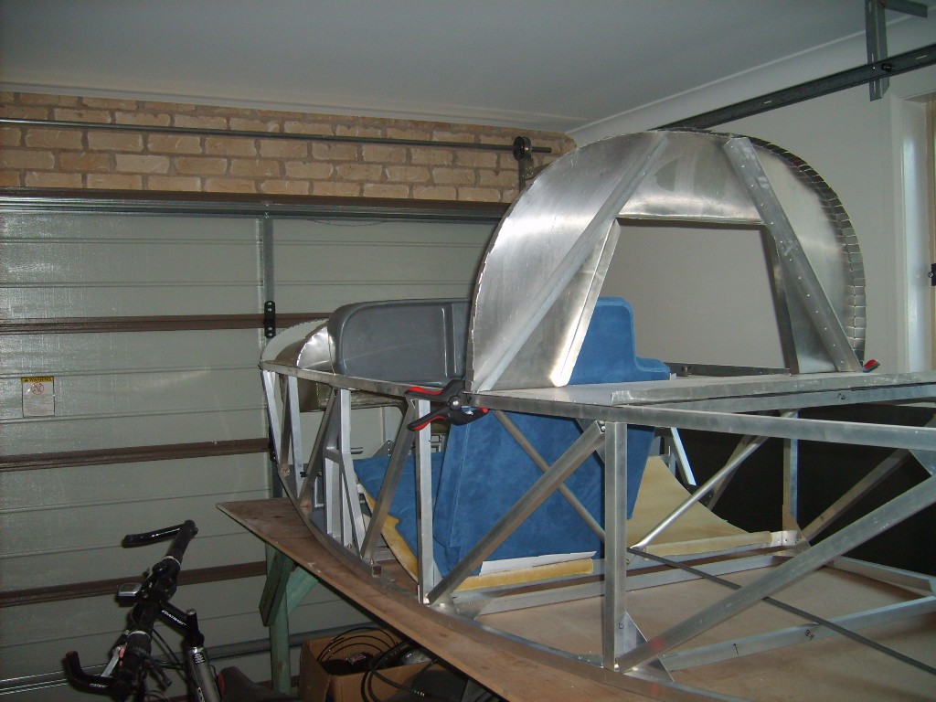

kgwilson Posted July 22, 2011 Author Share Posted July 22, 2011 Progress has continued with the build. I was concerned about getting the 2 halves of the fuel tank glassed together without any leaks but in the end this wasn't too hard. The secret is to get the Vinyl ester and Q cell mix to a paste that is not too runny so it all falls out of the joint area and not too stiff so it doesn't stick well. I had it clamped with about 30 clamps to get a good seal and after 24 hours I pressurised it with compressed air there were no leaks in the join, but I found 3 in the main tank, glassed those and then found another 2. Glassed those & re-pressurised and left it for an hour and no more leaks. I cut out the floor to shape and tried to get it in and couldn't so took it out and cut out the corners where it fits round the frame & then managed to get it in. I was going to take it out again and paint it before installing it permanently. That didn't work. I couldn't get it out again so I turned the fuselage on its side and primed & top coated it working around everything. I cut out the 2 bulkheads and bent the straight edges, drilled and bent the tabs for fuselage shape and installed the rollover angle on the rear bulkhead so these are ready to go. I got the correct length elevator cable and installed this with the control box and joystick. Next I drilled the holes for the elevator spar in all 12 elevator ribs. All this imperial sized stuff is a pain after a lifetime in metrics so I didn't have a hole saw the right size. Anyway drilled slightly smaller holes and honed them with a half round file and hung them on the spar. They weren't all perfectly lined up as I expected but with a bit more fiddling and and filing I got everything where it should be. I clamped them to the bench and glassed them in. Both sides are done and look nice and straight. Next I am installing the rudder pedals and brake master cylinders, fuel drain and breather and getting the main undercarriage leg cleaned up for its final cloth wrap and glass roving . This is to prevent possible de-lamination over time and hard landings. I have placed a few things like the pedals, seat and panel to give a better idea of how things end up. The panel will be much lower in the final install. Progress pics attached. Link to comment Share on other sites More sharing options...
