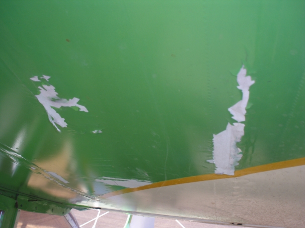

IanR Posted June 11, 2012 Share Posted June 11, 2012 I had a look at a fabric aircraft yesterday - Auster J1B - basically a very good one but has had an absolute crap paintjob which is now peeling badly. The fabric is ceconite. My question is, is it possible to strip and repaint a fabric aircraft successfully ? Are there any people out there who do this ? Only other mid-term option I see to it is recover the wings - not sure how much that would cost. Link to comment Share on other sites More sharing options...
skyfox1 Posted June 11, 2012 Share Posted June 11, 2012 It can be done but with the effort of preparing the ceconite surface it would be better to recover . Link to comment Share on other sites More sharing options...
IanR Posted June 12, 2012 Author Share Posted June 12, 2012 Thanks for the response - I was thinking that may be the case - I guess all paint would have to be chipped off somehow so as not to damage the fabric Anyone got any idea as to approximate costs of complete wing recover ? Link to comment Share on other sites More sharing options...

skyfox1 Posted June 12, 2012 Share Posted June 12, 2012 Hi what color is on the underside of the paint and when the paint flakes off is the ceconite clean . Link to comment Share on other sites More sharing options...

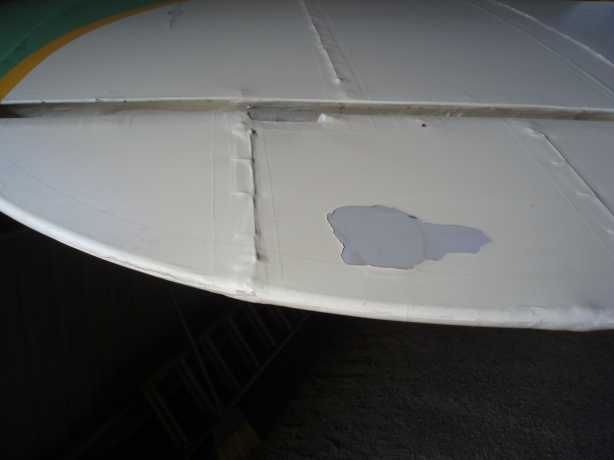

IanR Posted June 12, 2012 Author Share Posted June 12, 2012 The colours are very unfortunate - lime green and an off white. The fabric is clean under the paint. There is one section shown on the green where the tape has frayed a bit where the paint has come off but no damage to the base fabric. I think the real issue was the type of paint used rather than the fabric application. Link to comment Share on other sites More sharing options...
skyfox1 Posted June 13, 2012 Share Posted June 13, 2012 The colors are very unfortunate - lime green and an off white. The fabric is clean under the paint. There is one section shown on the green where the tape has frayed a bit where the paint has come off but no damage to the base fabric. I think the real issue was the type of paint used rather than the fabric application. l was hoping you where going to say silver , looking at your pics doesn't seem to be any silver nitrate after you sauate the fabric with nitrate you then put a coat of silver nitrate for UV protection after that the rest of the coats are with butyrate if l was you l would recover the hole thing .. cheers Geoff... 1 Link to comment Share on other sites More sharing options...

djpacro Posted June 13, 2012 Share Posted June 13, 2012 .. if l was you l would recover the hole thing ..... After seeing the pics and reading the recent posts I agree that this is the likely best plan and if it has been around for years with no silver there probably won't be any choice. David Isaac has promoted the virtues, including the low cost, of Austers in another thread but it won't be low cost if you pay some-one to recover it. http://www.recreationalflying.com/threads/ra-to-ga-why.40211/page-2 Link to comment Share on other sites More sharing options...
Guest ozzie Posted June 14, 2012 Share Posted June 14, 2012 Paint systems used for fabric aircraft have several additives one being an elastomer that helps the paint to remain flexible and resist cracking. Looks like the type used may be just an automotive base/top coat. No UV barrier either. ozzie Link to comment Share on other sites More sharing options...
IanR Posted June 14, 2012 Author Share Posted June 14, 2012 I talked it through with my engineer this afternoon - he agrees with the comments made here - will end up needing recover - his estimate for getting it done professionally is about $10K per wing !! I think I will probably pass and keep loking for one that has already been done. Anyone know of any good Austers for sale ? 1 Link to comment Share on other sites More sharing options...
skyfox1 Posted June 14, 2012 Share Posted June 14, 2012 I talked it through with my engineer this afternoon - he agrees with the comments made here - will end up needing recover - his estimate for getting it done professionally is about $10K per wing !! I think I will probably pass and keep loking for one that has already been done. Anyone know of any good Austers for sale ? Have ago yourself it isnt hard it is quite easy and very enjoyable you could cut that price in half. Link to comment Share on other sites More sharing options...

Louis Moore Posted June 15, 2012 Share Posted June 15, 2012 Wise choice. It is hard to determine the condition of any fabric covering even with tests-very subjective. I stayed away from them in my past aircraft-fibreglass is much better, unless one comes up really cheap. Come now fabric rules. If we were both to crash on an island, I could tare my plane apart and make myself a bed! It's not impossible to sand back fabric and re-paint it if automative stuff has been used making the rejuvenators useless! It's just a very slow and easy to stuff up process. Where is the J1? Link to comment Share on other sites More sharing options...
djpacro Posted June 15, 2012 Share Posted June 15, 2012 Fine Louis, but if the fabric has had nil UV protection for many years then it may have lost much of its strength. 1 Link to comment Share on other sites More sharing options...
Louis Moore Posted June 15, 2012 Share Posted June 15, 2012 If the paint is thick enough it will block a good amount of the UV's but would need to see it. Also looks like it is in a hangar (most fabric aircraft are kept that way) so UV damage should not be a major issue. Do not get me wrong though, sanding back a fabric aircraft is a MONUMENTAL job that at the end of the day is nearly worthless compared to re-doing the wing. Alternatively you could just wait until all the paint flaked off, I would only think you would have to wait a month or so!!!! If you change your mind Ian, I have a friend looking for a hour builder, does not really care for condition as he intends to fly the hours he needs and put it back on the market at a super low cost, so if your not interested pass on the details and I will let him know. Link to comment Share on other sites More sharing options...
