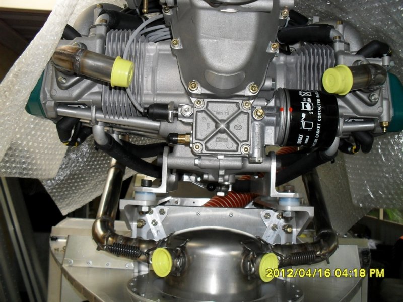

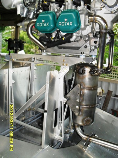

Hi Dave,

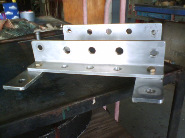

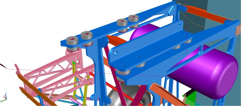

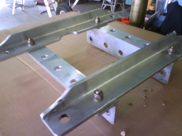

It's not a photo but might help - here is a screenshot of the CAD model of the bed mount on the AussieMozzie, fairly similar to what you have in the Bug.
It's all fabricated from 2"x2"x1/4" 6061T6 structural aly angle. The vibration isolation mounts look similar to what the Bug has at the moment, Universal mounts. I sourced them from the US - Vibration mounts Part no. V10Z82-R21200060, they come in various durometer values.
Cheers, Alan

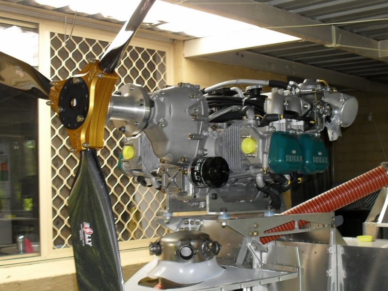

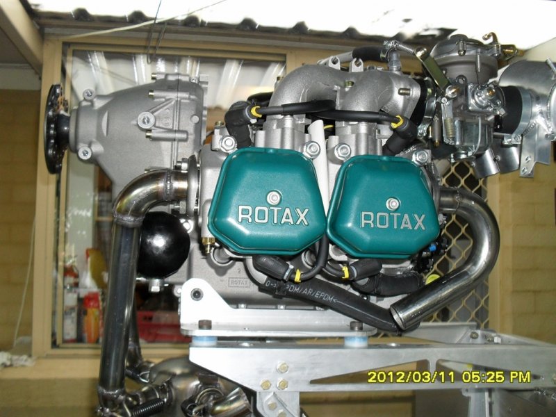

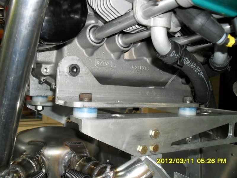

Here are some pics of the actual installation, note that the 'vibration mounts' are just dummies made from PVC and the bolts are just temporary ones for setting up - so no comments about the crappy hardware. hihi.gif.e1cf9f94f80a48a42c64c1543615f37c.gif

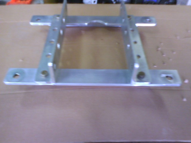

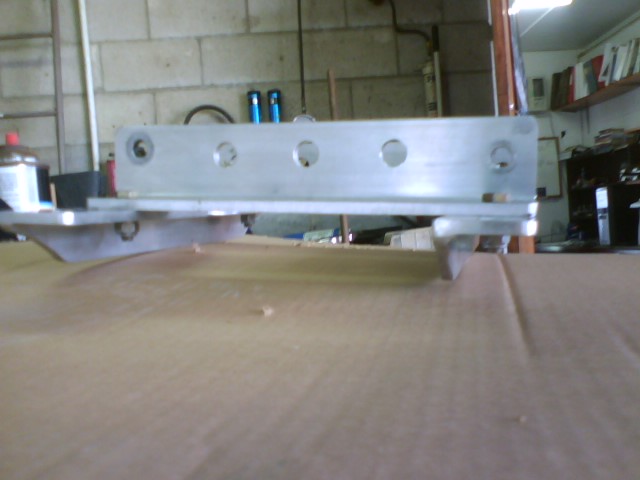

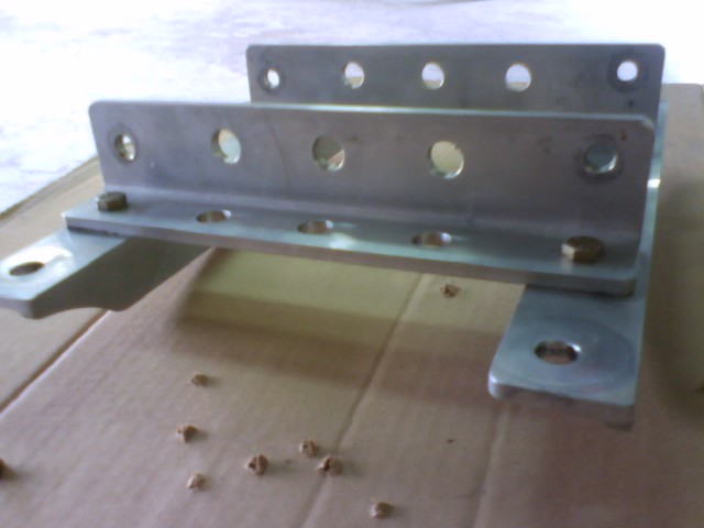

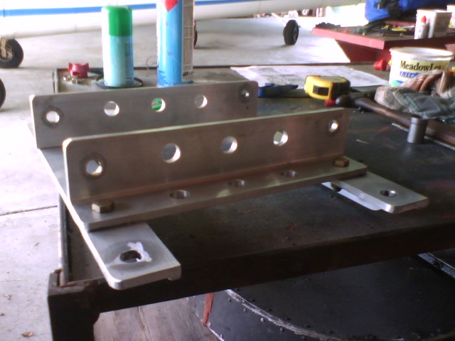

Guest Maj Millard

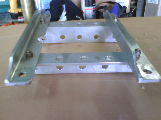

Flyvulcan....These are detailed photos of the Storch SS4 912 engine mount. Engine is secured via the side lower bolts. Mount probabily designed by Bill whitney and sits on a chromolly frame via An5 bolts and circular rubbers above and below the alum base...........material appears to be 6061-t6 about 1/4" thick....irst 3 photos are with mount upside down...rest are as mounted in aircraft..............................Cheers Maj....

Guest Maj Millard
This is about as simple as it gets, you can see in the later photos (right way up) where the rubbers are positioned and where the engine case bolts have been. That Lightening Bug will be like a scalded cat with a 912 in her !!!!..................................................Maj...023_drool.gif.742e7c8f1a60ca8d1ec089530a9d81db.gif
