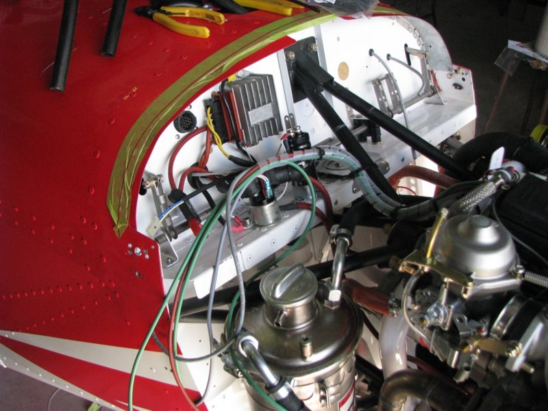

Kyle Communications Posted February 16, 2014 Posted February 16, 2014 Everyone usually mounts the cap on the strip that goes across the firewall that the top of the nose leg attaches to just in front of the reg the cap from memory goes direct to the reg connection
Kyle Communications Posted February 16, 2014 Posted February 16, 2014 goes to R and B+ usually you want it not far from the regulator or of course if it is easier to the input side of the fuse. My main battery earth goes to the base of the solenoid then off to the motor the cap earth goes under that same bolt for both earths
Kyle Communications Posted February 16, 2014 Posted February 16, 2014 You can see mine here just in front of the reg and beside the starter solenoid
