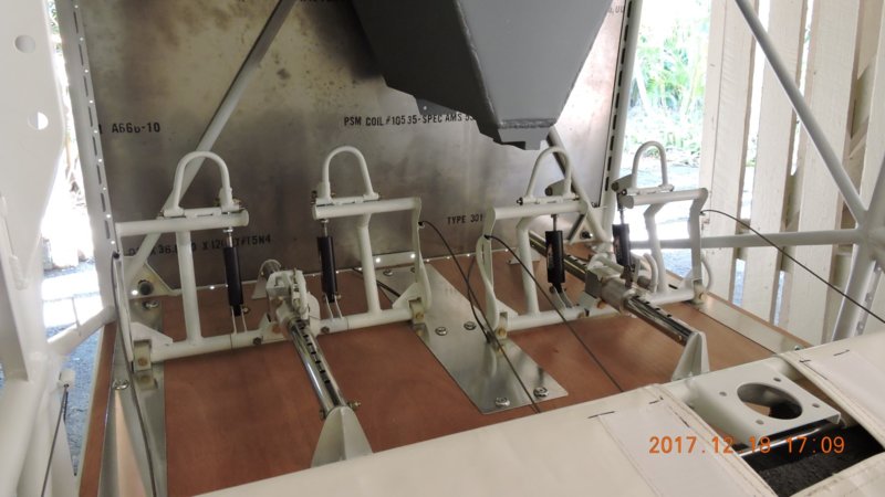

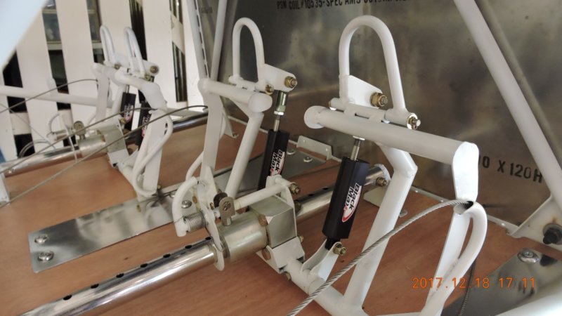

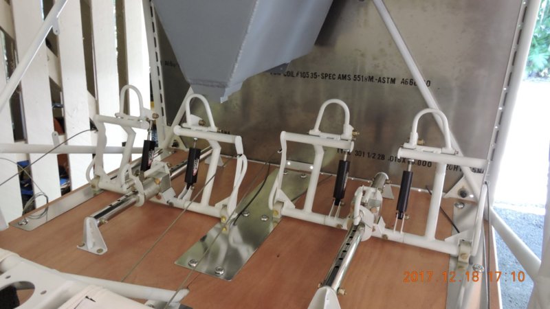

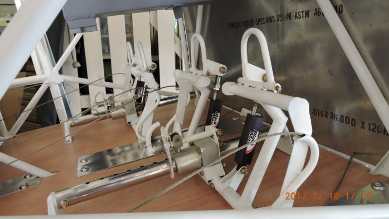

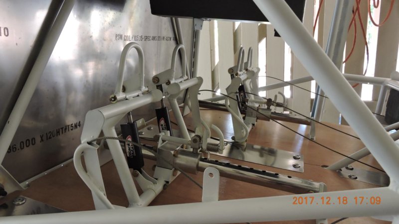

First I worked on the pedal assemblies. They were more-or-less completed some while ago but there's always some finishing touches to complete, I had to touch up some epoxy paint, fit the toe-brake pedals, and now that I had them I could fit the four new master cylinders which will provide both seats with full independent braking.
That all worked out fine so I was able to bolt the pedal assemblies to the floor panels and final-fix the floor panels down. Lastly I made the thin aluminium plates each side of the pedals, on which the pedals sliders run when adjusting the pedal positions, so that they don't scuff the floor timber. Gave them a bit of polish for a better appearance and was able to move on.
Some pics -
13 more hours for the log - making 1800hrs so far.

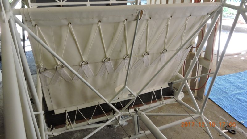

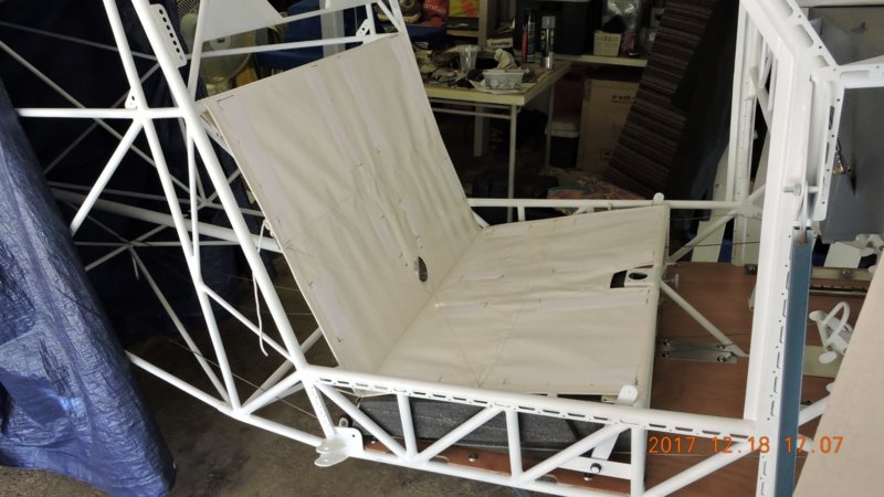

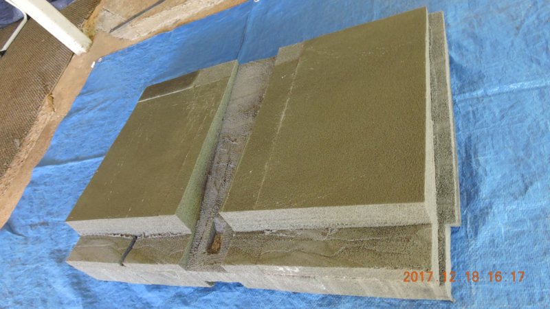

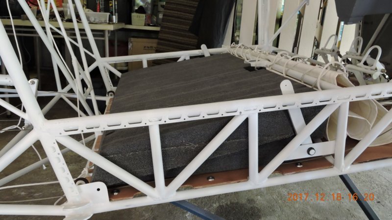

Next I needed to get the under-seat impact foam cushion made, so that I could complete the seat itself, because the seat had to be in before the joystick and aileron torque-tube could go in.
I sourced the impact-absorbing foam from my favourite foam suppliers, PJ Bowers in Reedy Creek. I don't think you'll ever find a more helpful fella than Steve, one of the partners there. They had some large bags of off-cuts from a theme-park protective crash-barrier. It is 12mm closed-cell polyethylene, multi laminated, and came in pieces about 120mm thick. Being closed-cell it won't absorb moisture and therefore is rot, mildew, and mold proof.
I cut up the sections of it with an electric carving knife, glued them all together with an industrial strength instant grab spray contact adhesive and then carved out channels and pockets on the underside for the four rudder cables, clearance for the throttle torque-tube and throttle levers each side, the throttle friction device and the harness attachments.
Then I could finalise the position of the lacings that would secure the seat fabric and make cutouts in the timber floor under the seat to accommodate the lacing, varnish the timber where it was cut and final-fit the floor in place with its screws.

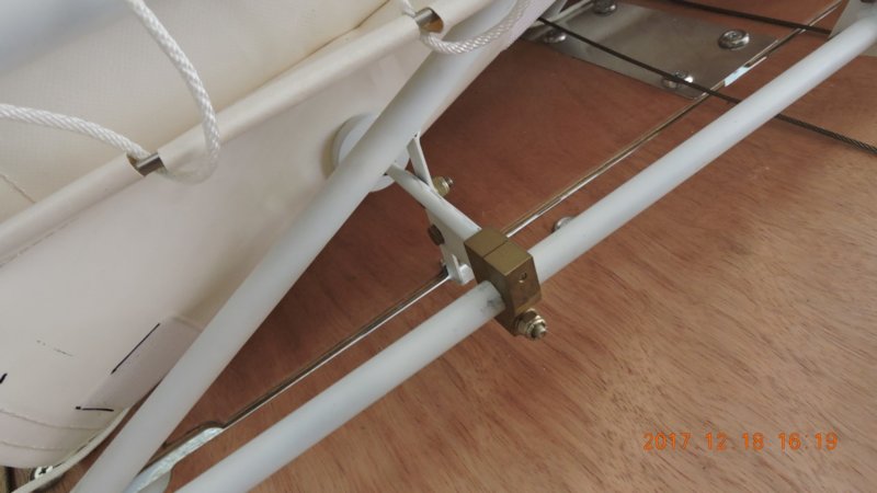

Once that was in the throttle torque-tube was fitted and the three central joining bolts were torqued, then the throttle cable fitted to the left-side throttle lever, and those bolts also torqued.
Finally I fitted the throttle friction and torqued those bolts also.
Once they were in I fitted the seat and laced it up tightly so that I could determine exactly where the harness straps needed to come through at the middle attachment and marked it for modification in the industrial sewing machine.
Some pictures -
Another 14hrs in that lot, 1814hrs in total so far.

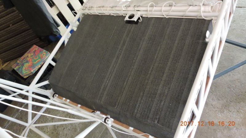

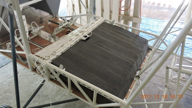

Next I needed to get the under-seat impact foam cushion made, so that I could complete the seat itself, because the seat had to be in before the joystick and aileron torque-tube could go in.I sourced the impact-absorbing foam from my favourite foam suppliers, PJ Bowers in Reedy Creek. I don't think you'll ever find a more helpful fella than Steve, one of the partners there. They had some large bags of off-cuts from a theme-park protective crash-barrier. It is 12mm closed-cell polyethylene, multi laminated, and came in pieces about 120mm thick. Being closed-cell it won't absorb moisture and therefore is rot, mildew, and mold proof.
Some pictures -
[ATTACH]53379[/ATTACH] [ATTACH]53380[/ATTACH] [ATTACH]53381[/ATTACH] [ATTACH]53382[/ATTACH] [ATTACH]53383[/ATTACH] [ATTACH]53384[/ATTACH] [ATTACH]53385[/ATTACH] [ATTACH]53386[/ATTACH] [ATTACH]53387[/ATTACH] [ATTACH]53389[/ATTACH]

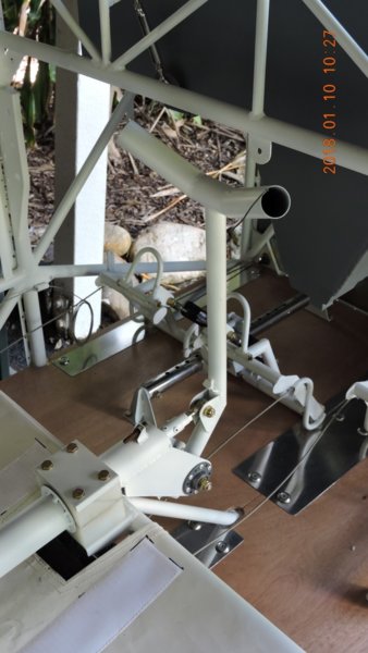

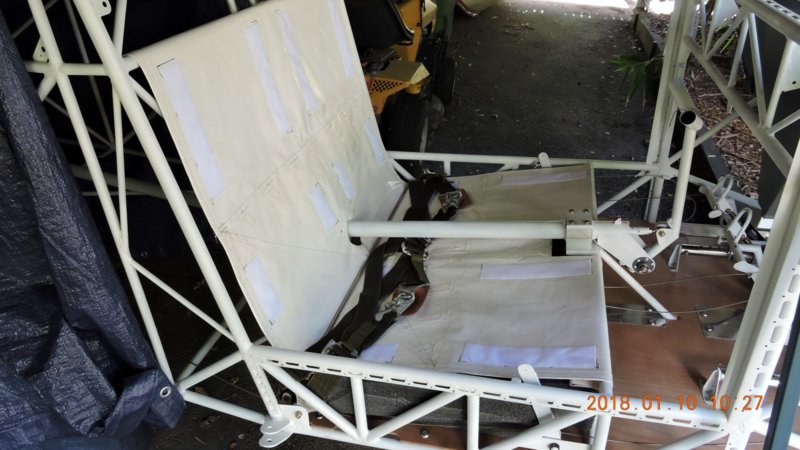

I marked the seat for a hole to be cut out for the harness straps and then undid all the lacing again to remove the seat and sew in a reinforcing patch around the hole. That done it was all laced back in again at the front only, the steel cable that the harnesses attach to at the centre was made up, swaged and fitted and the harnesses threaded through the seat and bolted to the cable in the centre, and to the cleats at the outside edges of each seat.
Next the aileron torque-tube which carries the joystick had to be threaded through the hole in the seat and threaded through the triangle formed by three tubes which supports the rear bearing for the torque-tube. It was a bit like trying to work out a chinese puzzle for the first time, so I was mildly relieved when I did find a way to actually thread it. For a few moments I was beginning to think I may have painted myself into a corner.
Next, and equally tricky, was fitting the split bushing itself, I had to machine some extra clearance to get a spanner on the nuts underneath, and modify a spanner for the purpose but got there eventually. I also made some extra 0.005" shims to go between the two halves of the bushing, and applied plenty of graphite because it was just a little too tight.
That done I was able to fit the forward torque-tube support bearing, also with shims and graphite powder for lubrication, the bolts on both t-t bearings are fitted 'snug' (not torqued) with nyloc nuts/washers etc, so as not to crush the plastic bushing material.
Once the torque-tube was fitted I could install the joystick between the pair of bellcrank bearings that carry it, and fit the first of the elevator pushrods that runs down the centre of the torque-tube.
Some pictures -
Another 10hrs, 1824hrs so far.

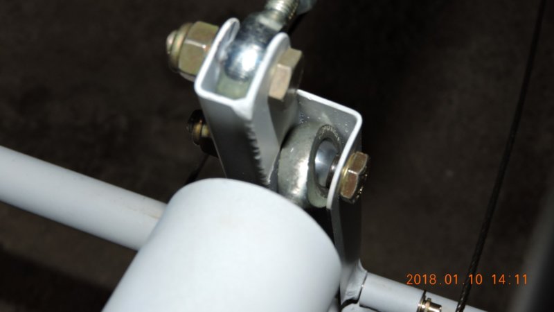

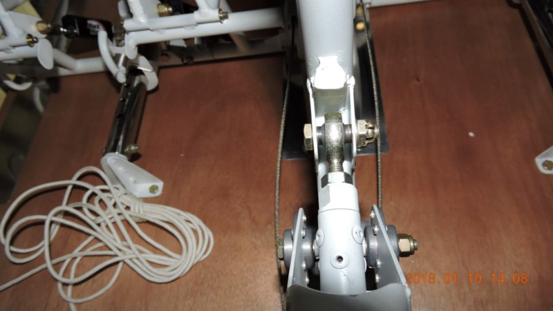

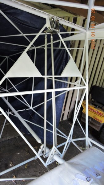

With the first of the elevator pushrods in place I went to the rear of the fuselage and clamped the elevator control horn in the central position, then I could determine the exact length to adjust the rear elevator pushrod (there are four elevator pushrods in the length of the system). That rear pushrod needed to be the exact length that would make the control horn contact the control stop at the same time as the bellcrank on the other end of it is at right angles to the pushrod, since there is no differential in the elevator motion i.e. the up and down angle is the same. Once that length was determined I removed the rod-ends and nuts, cleaned the threads and applied Loctite 243 before re-assembling and tightening them, being careful to end up with both rod-ends in alignment with each other.
I re-installed that particular pushrod with temporary nuts on the clevises because they will have to come off again for the fabric covering, and moved on to the next pushrod. Similarly its length had to be adjusted so that it was at right-angles to the bellcrank and also at right angles to the walking beam halfway down the fuselage. Then remove it, disassemble, clean, loctite, re-assemble etc. A word of caution for any future owner who might use this log as a manual when servicing the aircraft, it would be easy to damage the aft end of that particular pushrod if that end is not supported upwards because it could jam in the diagonal internal bracing, so when removing or replacing it, the aft end of that pushrod should always be unbolted from the clevis last and bolted onto it first.
Next I adjusted, removed, cleaned, loctited and replaced the third pushrod, the one in the forward part of the rear fuselage and which attaches between two walking beams.
Once those three pushrods were set to their final lengths I clamped the joystick in the centre of its travel and could then adjust the length of the forward-most pushrod, the one inside the torque-tube. Then disassemble, clean, loctite, re-assemble etc.
Important Note about this front pushrod - when the joystick moves from side to side in an arc of approximately 50° the forward elevator pushrod must 'twist' by that same amount. This MUST NOT result in any movement of the rod-end threads, or any twisting load on the pushrod. It is achieved within the lateral rotation of both of the balls in the rod-ends. They can only provide that motion if small spacers are provided each side of the balls, within the clevises AND the rod-ends must be well aligned with each other (± 2°). Those spacers (4of) are made from 5/16" tubing bored 1/4" and they are 1.9mm/0.075" ± 5% long. Installed with very small long-nosed pliers.
The pictures show the small spacers installed each side of the pushrod which rotates (note they're only on the first pushrod's rod-ends, not the other three pushrods which don't rotate), and how they allow the rod-ends to rotate further than they could if the clevis was only as wide as the rodend, without the spacers -
9 more hours for the log, 1833 hrs so far.

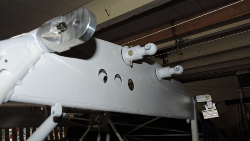

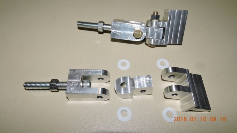

So - the next task was to get back to the CAD work and design the rear spar wing root fitting. That took a day and a half but once I'd worked it out I felt ready for a bit of machining again, so decided to go ahead and make them. Part of the reason for making them straight away is that it was pretty tricky to get my head around what moves when and where, as the wing folds and rotates, so I wanted to be sure it would work and end up as it should. Remember that these wings don't just fold back, they also rotate and fold flat against the fuselage sides.
Anyway, I started machining last Friday morning and finished on Monday afternoon. They probably don't look much for 29 hours of machining but there are a lot of processes involved to machine them manually. Or perhaps I'm just getting slower in old age ...
They went together just fine which was pleasing and seemed well, but as I fiddled with them I realised that at the last part of the wing-folding action the inner and outer parts wanted to over-centre around each other. At first I thought that would be a good thing as they would 'park' positively with the spar root fitting under the fuselage attachment. But ... the 'collapsing' action as they over-centred would position the end of the wing lower skin beyond the fuselage fitting requiring an ugly cut-out in the skin or a cover plate, neither of which I fancied.
So - the answer would be to make up a new pair of the central links and round off one end of each but leave the other end square so that it would only have limited movement, how much movement it actually needs can be determined later and the square end adjusted to suit. Consequently I spent most of Tuesday making the replacement links.
More 'real work' starting tomorrow so I guess things on the plane will slow down a little, for a while.
The picture shows the articulated rear spar wing root fittings, which, in combination with the top and bottom articulated strut end fittings that I machined this time last year, allow the wings to quickly and easily fold flat against the fuselage sides -

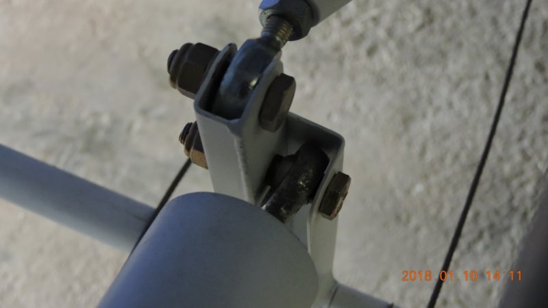

HITC, I am only asking because my LAME who is helping with the Bushbaby rebuild got real jumpy when I suggested using graphite as a lube. Is graphite ok for use on 4130. He had explained that graphite works it way into the metal at a molecular level and can cause strength problems. I was going to use it on the same type of nylon block control mounts where mine go cross ways for dual sticks, They were binding and I ended up with 0.005" plastic shim material and grease in the end which freed up the controls perfectly.
cheers
clint
HITC, I am only asking because my LAME who is helping with the Bushbaby rebuild got real jumpy when I suggested using graphite as a lube. Is graphite ok for use on 4130. He had explained that graphite works it way into the metal at a molecular level and can cause strength problems. I was going to use it on the same type of nylon block control mounts where mine go cross ways for dual sticks, They were binding and I ended up with 0.005" plastic shim material and grease in the end which freed up the controls perfectly.cheers
clint
Hmm, good point, I think it's only a problem with aluminium as far as I know.
In any case my control torque tube is well painted with primer and then 2 coats of 2 pack epoxy so unless all that wore through, which I don't imagine it would, then there wouldn't be an issue.
I will check though, it's easy enough to clean it off and replace with another type of dry lubricant. I wouldn't want to use grease because it picks up dirt and would probably make the condition worse than without any lubricant at all. AND - the plastic absorbs anything liquid and swells, making the fit tighter again.
Either way, the torque tube isn't really loaded up much at all so I can't imagine any slight weakening being a problem, but best to err on the side of caution.
Thanks for the heads-up, I'll look into it.

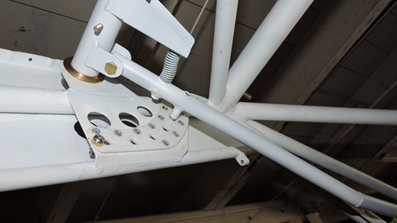

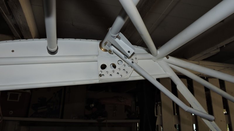

Some while ago I made the front spar attachment fittings and installed them as well as the rear spar fittings shown in post #255.
I'd also started to make the parts for the aileron and flap torque tubes in the cabin roof which provide for the automatic connection and disconnection of those controls when the wings fold. They're the bits that go with the 'dogbones' that some may recall I made from the drilled balls in rodends, described in posts #175 and #176. Coincidentally, that was two years ago today!
Last week I made the rest of those parts and welded them onto the ends of the cabin roof torque tubes and cross-drilled the fittings on the other side to bolt them on.
I also made the flap control handle and the spring-and-detente mechanism and fitted that to the flap torque tube.
Then made up the short pushrods that connect the aileron bellcranks to the aileron torque tubes and fitted the whole lot together.
A few small adjustments with shims and it all moves very smoothly and freely without any discernible play or lost motion.
Some pics -
Another 19hrs for the log making a total of 1899hrs so far.
