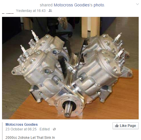

DrZoos Posted October 30, 2015 Share Posted October 30, 2015 This was on facebook yesterday...imagine the power to weight ratio... A honda CR500 puts out 60HP So this may put out around 240HP ?? Interesting.... 1 1 Link to comment Share on other sites More sharing options...

DrZoos Posted October 30, 2015 Author Share Posted October 30, 2015 i dunno, most CR500's with a new ring every now and then would make it past 500 hours pretty easy.... and with 240hp, you wouldn't be running it very hard very often... the big issue here would be how it could handle a heavy fly wheel/prop and crank shaft strength... I reckon this would only cost $5,000...so if i was a home builder id be considering it or variations at some point... 4 cylinders of two stroke is a lot more reliable than two or one... This could become a first world suicide vest 1 Link to comment Share on other sites More sharing options...

DrZoos Posted October 30, 2015 Author Share Posted October 30, 2015 hirth is 80-110 who would fly behind a four cylinders of two stroke for that rubbish HP This new two stroke has possibly 240HP 1 Link to comment Share on other sites More sharing options...

DrZoos Posted October 30, 2015 Author Share Posted October 30, 2015 hey bex the CR500 is 60hp what your thoughts on this 4cly 4 x 500cc what sort of hp would it get at the prop Link to comment Share on other sites More sharing options...

bexrbetter Posted October 31, 2015 Share Posted October 31, 2015 hey bex the CR500 is 60hp what your thoughts on this 4cly 4 x 500ccwhat sort of hp would it get at the prop You would need a PSRU and you would be looking at 170-180hp at 5000 rpm all day long with 4 pipes that take up a lot of room, maybe 150 - 160hp with just 2 pipes (that are still bulky). People quickly forget about the pipes you critically need to make good power from a 2 stroke, they don't weigh much but can be bulky and awkward to fit in place ... Link to comment Share on other sites More sharing options...

bexrbetter Posted November 30, 2015 Share Posted November 30, 2015 You would only need a CR1000 twin, I have long thought about a flat twin "Twingle" (twingle means that both cylinders fire at the same time, i.e. twin single) the flat twin layout for compactness and balance. Allows you to use one exhaust chamber, one carby or injector, etc. I would do it a little different though, direct drive with a whopping long stroke because as DrZoos says, by the time you add a PSRU the weight percentage difference gets smaller compared to a 4 stroke so keep the obvious weight advantage on your side. Link to comment Share on other sites More sharing options...
