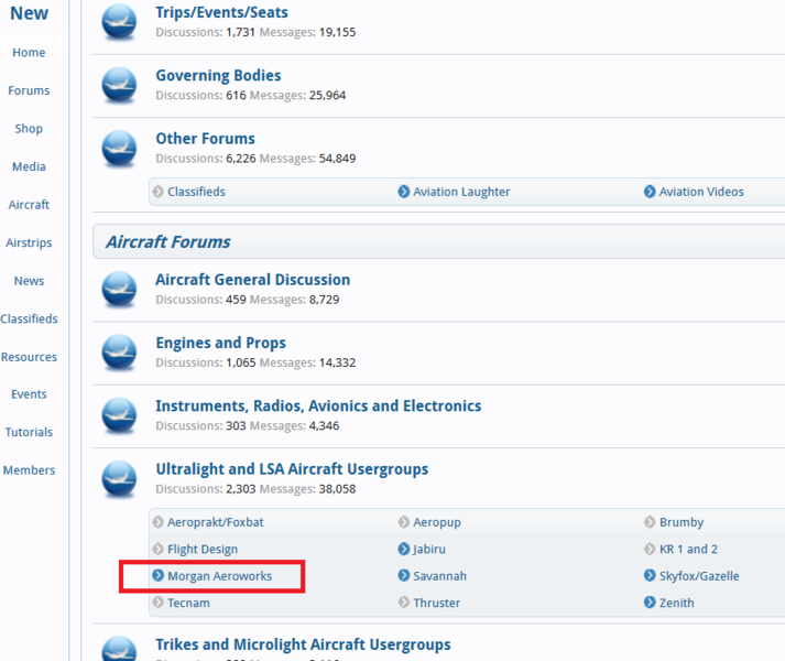

kgwilson Posted November 19, 2016 Posted November 19, 2016 Check out the various build blogs in the Morgan Aeroworks Forum threads including mine. Garry Morgan leaves for NZ next week so Morgan Aeroworks in Taree is no more. He is moving to Blenheim and is basing himself at Omaka & has bought a hangar there. There are Sierras flying in NZ. Give him a few weeks to settle in & take a trip to Omaka & talk to the man himself. 1

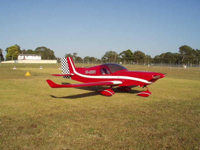

graham brown Posted November 22, 2016 Posted November 22, 2016 Camel has the explanation right. I have 40 hours in mine now over the last 12 months. I don't have any trouble with any weight configuration in mine and I put the shock absorber on the nose leg. I also lowered the nose 2 inches. The photo is before I lowered the nose. I cut 2 inches off the vertical bit of the leg. Maybe the mods will help make it better and I'm sure Ray Tolhurst will take all this on board. Great aircraft but probably not a trainer. 1 1
