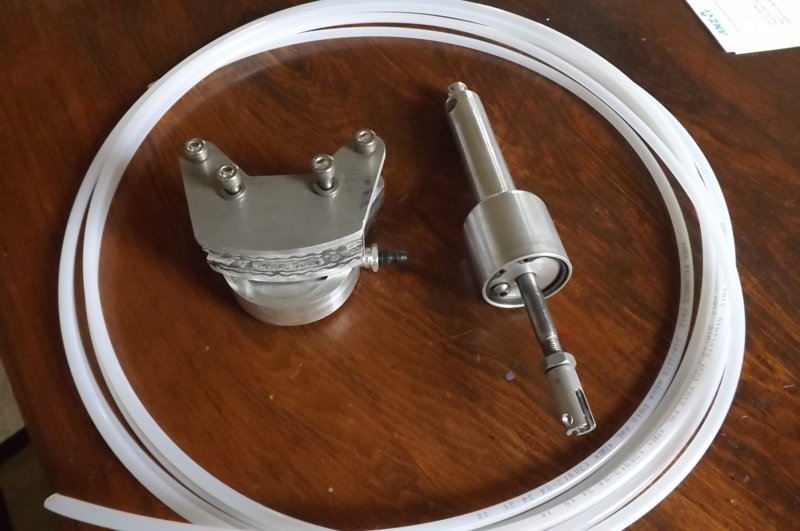

IBob Posted April 1, 2017 Share Posted April 1, 2017 Have you seen the "documentation" that comes with a Savannah? ;-) The construction manual tells me to fill the brake system with a mineral base fluid but doesn't hint as to how, doesn't give a quantity, and doesn't give a specific type. So.... after some research I'm planning on using Royco 782 as it is more flame resistant (seems like a plus with brake lines and master cylinders surrounding my feet ;) I'm just not certain how much to order. I'm also going to try pushing it up from the calipers to the master cyclinders. I was hoping a Savannah builder would have a good idea about the capacity of the dual brake system. In my Pilot Operating Handbook P12&13/44, LANDING GEAR, my manual calls for: Mineral Based Oil (Renofluid 3.000 IT, Fiat Tutela GI/A). ( DO NOT USE synthetic oil type DOT4) It does not give a quantity. Based on external measurements, I estimate: Per Cylinder (at rudder pedal)= 28cc Per Calliper = 12cc. Hydraulic lines 5.2metres x 4mm = 65cc So, for my single brake system, I would estimate 145cc (plus flushing, spillage etc) If a dual system is just 2 more cylinders and a bit more line, I would estimate 225cc (plus etc), assuming the components look like this: 1 Link to comment Share on other sites More sharing options...
IBob Posted April 1, 2017 Share Posted April 1, 2017 The manual also says (in the section on assembling the brakes) to take out the breather screw in the top of the pedal cylinder, and fill from the calliper up (as described by rgmwa, above). Well, actually, that's not what they say. But, y'know, it's what they're trying to mean...) Which means coming up with some sort of pump (also as suggested by rgmwa). I think when I get to this, I will get a couple of metres of neoprene tube and fit it to a fluid container, the other end to the calliper. With the container on or near the ground, I will put fluid in the container. Then gradually raise the container, which should cause fluid to go up the lines and into the pedal cylinder. This may be more controllable than pumping the fluid in. However, I will need to make sure that all lines are 'uphill' for this to avoid airlocks. Well, it's an idea.... Please let us know what works for you? 1 Link to comment Share on other sites More sharing options...
