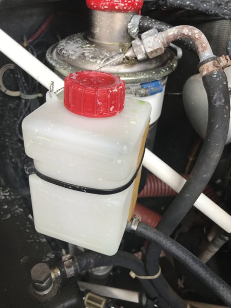

Guest TopEnd Posted April 6, 2017 Posted April 6, 2017 So I have this issue. Lately my 912 has started spit bits of coolant out the overflow lid. But not really on flights under 2hrs. I just completed s 3 hr flight and the overflow bottle is empty. Header tank still has coolant. And the overflow was only filled exactly to the min line. Temps on climb up to 120 CHT AND 100-110 on cruise. Oil 105 on climb and and around 90 on cruise. I have a new cap coming 1.2 bar and a new radiator extra two core from Bert Flood. Anyone else had anything like this? Cheers Marty - Darwin NT 2005 with new Crankcase 2000TBO ENGINE TT 880

cscotthendry Posted April 6, 2017 Posted April 6, 2017 In my first plane, I ran Evans coolant. I always had higher temps than anyone else I knew, but Evans does that. My current plane uses the 50/50 and I wouldn't go back to the Evans. Re-reading your post, I think you mad a good choice to replace the radiator cap. It's a cheap attempt at a fix and just might solve it. From the pix, it's certainly made a mess of the plane! Also, since you have had the overflow bottle go empty, make sure that your cooling system is topped up and bleed all the air out of the system. If there is any air in the lines, it could cause the coolant to boil easier, which causes steam which pushes more coolant out, which allows room for expansion, which causes lower boiling temps etc etc in a positive feedback loop.
