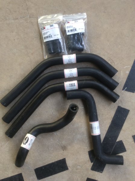

skippydiesel Posted November 12, 2017 Share Posted November 12, 2017 Having just completed my 912 ULS, 800 hr & 5 year rubber replacement, maintenance/ service, I just thought I might share my hose supply experience with you: My coolant, fuel & oil hoses come from only two suppliers Gates (Repco these days) and Bert Flood. BF supplies my oil & small coolant hoses. Repco supply my Gates large coolant & all my fuel hoses. Gates specifications & Part No are: Fuel 27349 - 3/8 (9.6mm) Barricade Fuel Injector Hose 27348 - 5/16 (7.9mm) Barricade Fuel Injector Hose 27347 - /4 (6.3mm) Barricade Fuel Injector Hose Above part numbers are for 15 ft length, however Repco will sell it to you by the metre. (The FI hose is about twice the price of ordinary low pressure carburetor hose) I use proper fuel injector hose clamps for a good seal without damaging the hose. My fuel filters are Hengst H 102 WK (for those who might want an inbuilt elbow, try H 103 WK) Coolant. Radiator hose Pn 05-0725 (x 3) . Three of these Holden Barina MF 1.3 L 1989-90 upper radiator hoses do my installation very neatly with minimal cutting & only one joiner Joiner 90 degree elbow Pn 28626 (x 1). These joiners come in a pack of two. They may look similar to 1" plastic irrigation line joiners but are properly heat rated and tested for coolant compatibility. Coolant concentrate is Castrol Radicool mixed 50:50 with distilled water. If you want straight joiners the PN is 28606. I have attached a photo of the coolant hoses & connectors, with two other hoses I did not use. The unused hoses are: PN 05-1797 Subaru Outback 3.0L 6 cylinder 1988-04 Upper radiator PN 05-1235 Ford Lazer 1994-96 Lower radiator For a nice clean cut, invest in a pair of cheap hose cutters (a little spray of silicon on the blade helps the cutting process) 2 1 1 2 Link to comment Share on other sites More sharing options...

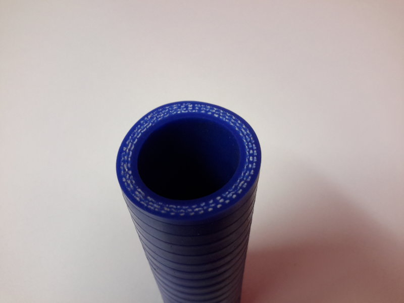

skippydiesel Posted November 29, 2017 Author Share Posted November 29, 2017 I used silicon hose for the bends and rotax 17mm hose for the straight sections under the heads.16mm/25mm silicon fits perfectly. Have never used silicon hose in an aircraft application. I would welcome your observations on the following: Silicon hose is: relatively heavy when compared with conventional hose quite soft & flexible hence the 16mm hose fitting over the 17 mm spigot and its (25 mm) ability to conform to quite tight radius bends purported to have a long service life but that this does not negate the requirement (by Rotax) for a 5 year replacement costly compared with conventional hose Link to comment Share on other sites More sharing options...
Downunder Posted November 29, 2017 Share Posted November 29, 2017 Weight.... doesn't seem heavy at all. If it is we're talking a few grams. Strength. Has reinforcing imbedded in it so is quite strong and ridgid. I purchased pre-molded elbows at various angles as bending straight sections too far caused a "kink", as an indication of how ridgid it is. Can't recall prices but as I'm known as a "peny pincher" can't of been too expensive. Done about 20 hrs since. All seems fine. Hose clamps not needing too much extra tension after rechecking. Link to comment Share on other sites More sharing options...
