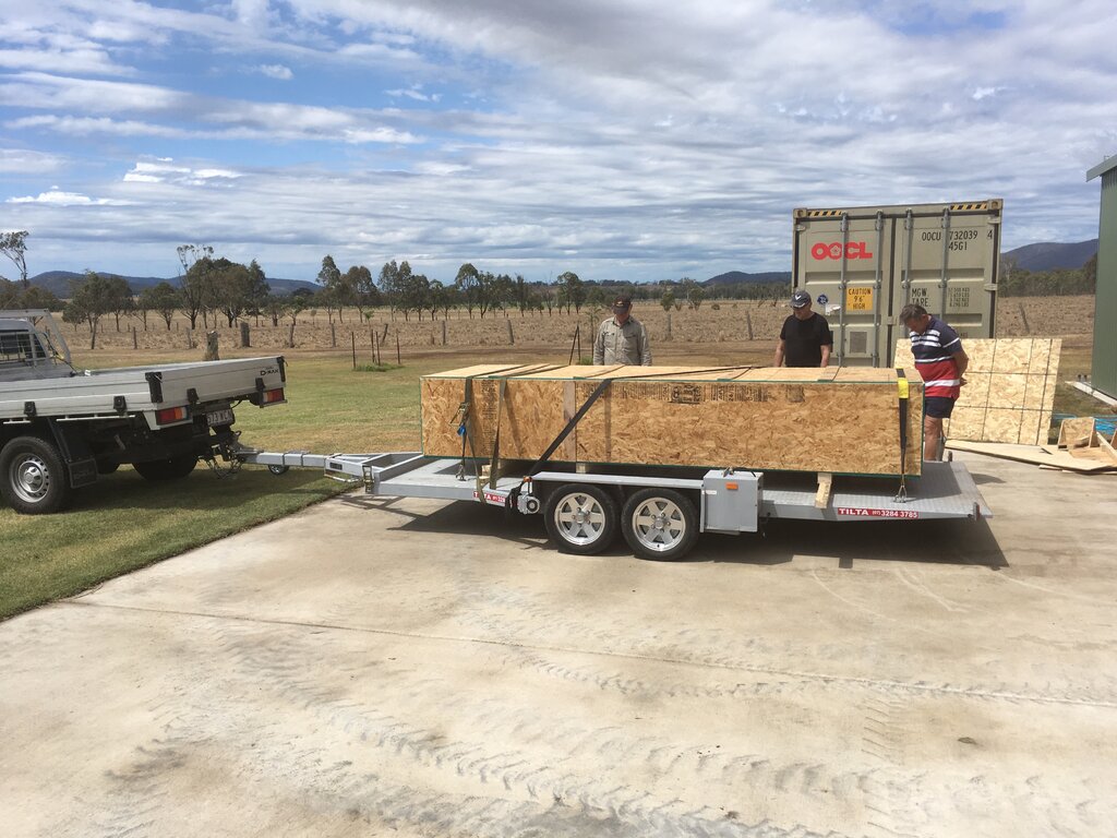

Hi Geoff   It was all done in the one price for transport from Kansas to here..got to say though the delivery out to Just up the road from Archer Falls was expensive..but when split 4 ways not so bad ?

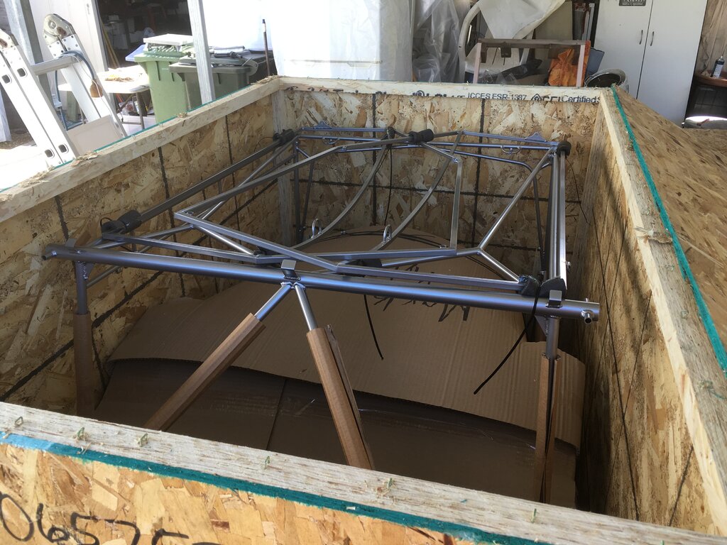

yes its a exciting aircraft especially if you have had a fly of one. Couldnt resist had to open the boxes for a look...well thats my story ?  You have to do inventory so need the packing list so I opened both boxes only the top but couldnt find it. Rang Greg and he said it was at the front on the bottom of the cabin frame box so dove in and managed to find it so I can cover the boxes up easily until I make some room. Its well packed..heaps of packing and everything is wrapped in brown paper and the stickers are on the package so will leave all the parts in the brown paper when I unpack. Got to say the cabin cage looks awesome...the work in it is unreal

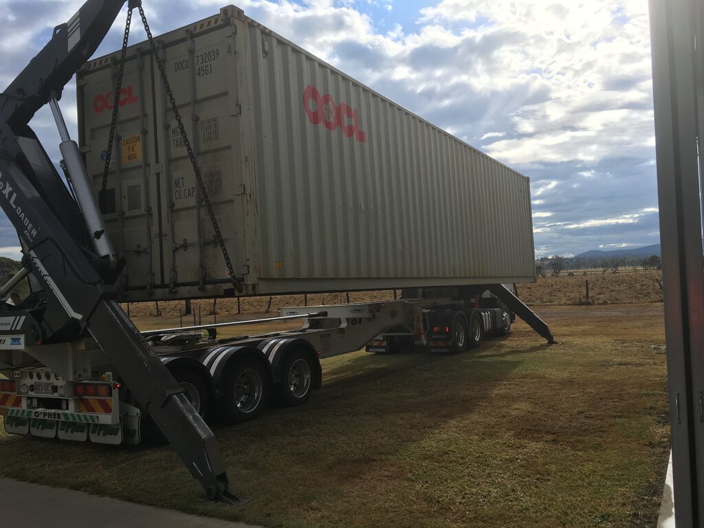

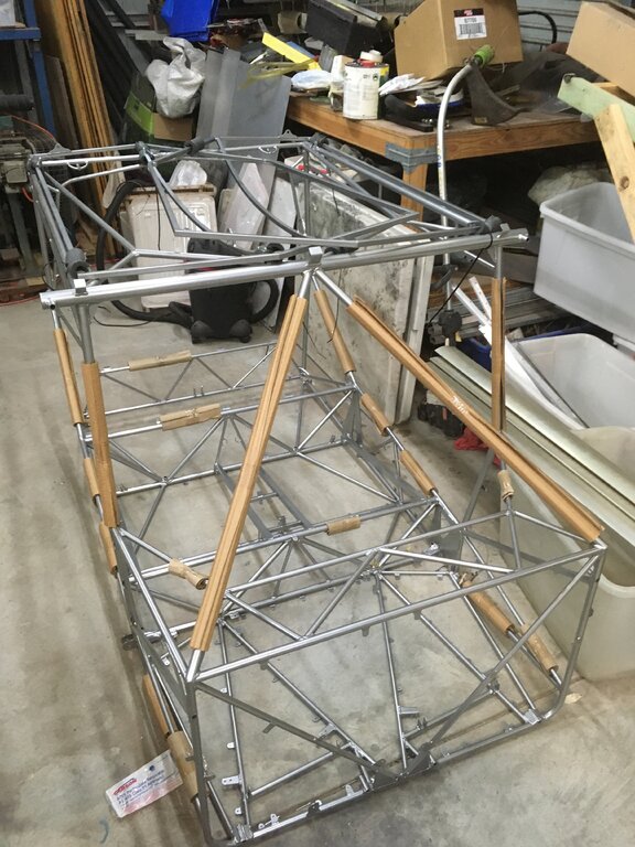

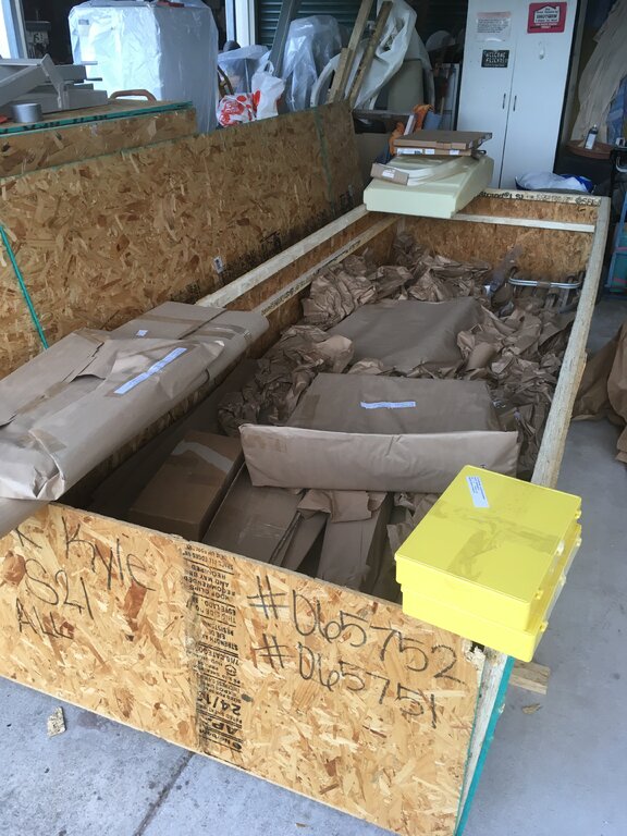

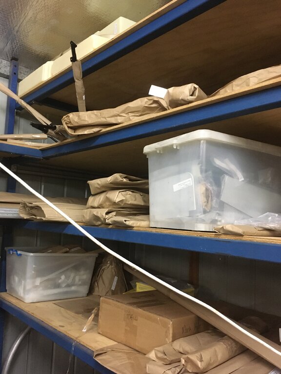

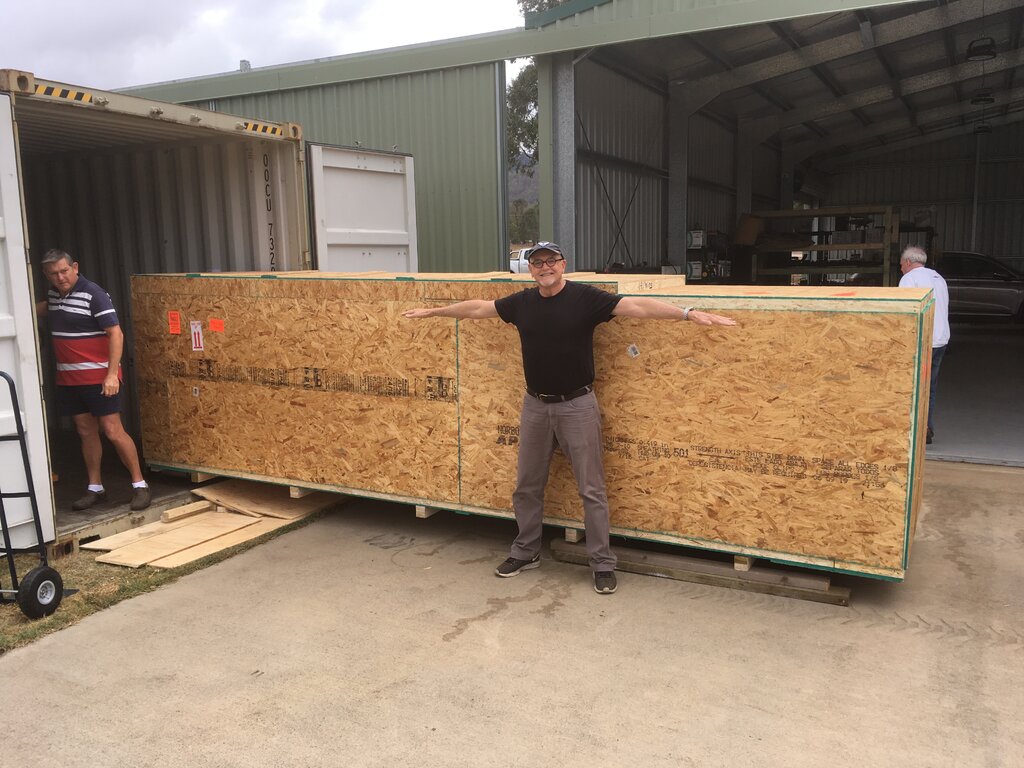

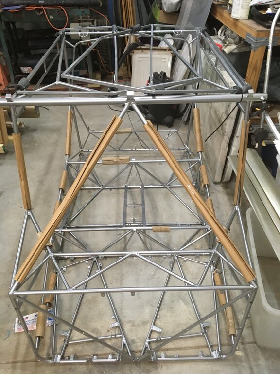

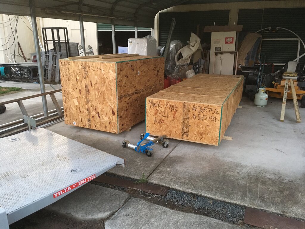

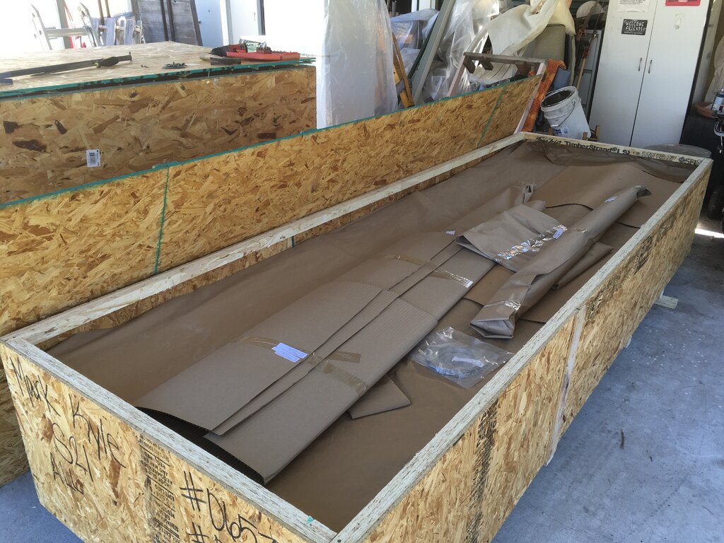

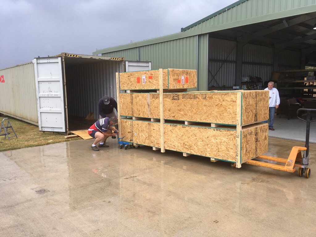

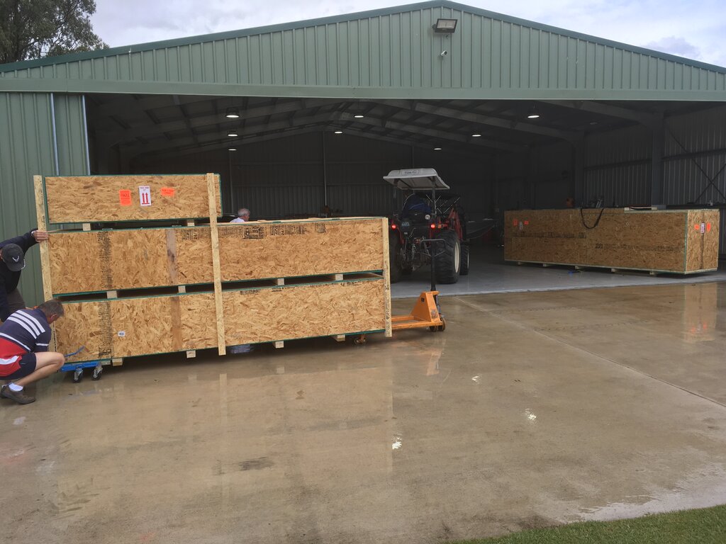

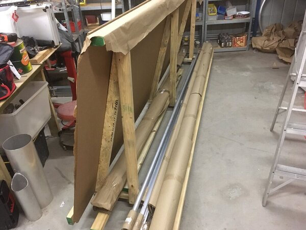

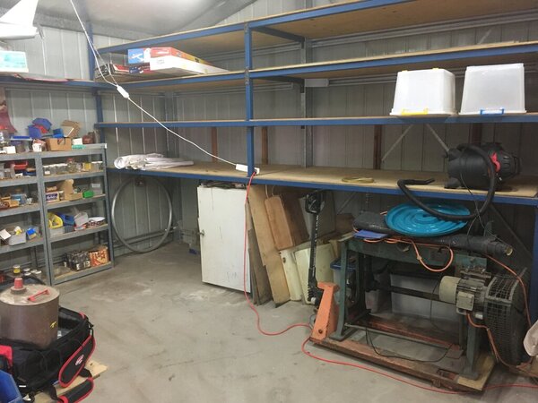

It took me 3 days of full on solid work to clean up my big shed to make enough room to be able to unload the boxes. Cant believe how much crap I have accumulated in the 15 years I have been at this place and I need to do a lot more. Dont forget I am doing the S rebuild in this same shed so room is a big issue. Anyway got the large main box unloaded on sunday arvo late and the taller box with the cabin cage and cowls,tyres etc done last night. Started doing inventory of all the parts. OMG this kit is 2 whole levels above a savannah kit. Just the packing list for inventory is a mission. I have put all the large bits alu etc and this is all wrapped in brown paper and stickers on the outside of each with the priority number and the actual part name on it so you know what it is. I have divided my shelf areas into sections for fuselage and wing and tail and finishing kit areas etc the smaller parts (and literally a thousand of them all in bags marked) are all going into plastic boxes in those categories as well. Doing this has made ticking everything off to make sure it has been supplied is making it much easier because I remember when I pulled the lid off the sav kit box I thought that was daunting well this is way beyond that. I will get some better pictures and post them later. I did make a vertical rack to store the wing skins and the longer material on the back of it as well this has also made it a bit easier and saved a lot of room. Once I get all this loaded away I can get back onto finishing Mabel
1695511046_IMG_00933.thumb.JPG.b123770f482c9f9b766fcba4e631906a.JPG1923085944_IMG_06863.thumb.JPG.9344c63b501766fa08cc4f1e5fe1bf87.JPG571581312_IMG_12932.thumb.JPG.dd568cde0cdb34ccc8a9916ea51a02bc.JPG1935170614_IMG_31003.thumb.JPG.5b818234b2c71a9859d8e8532a313362.JPG2101041517_IMG_76402.thumb.JPG.fb75d16bb38d58f9544b820c6c916ddf.JPGIMG_7499.thumb.JPG.f7736d95192a171366feb4080511ac69.JPGIMG_1904.thumb.JPG.c4a98853d8d4242c0d17efbff596765c.JPG

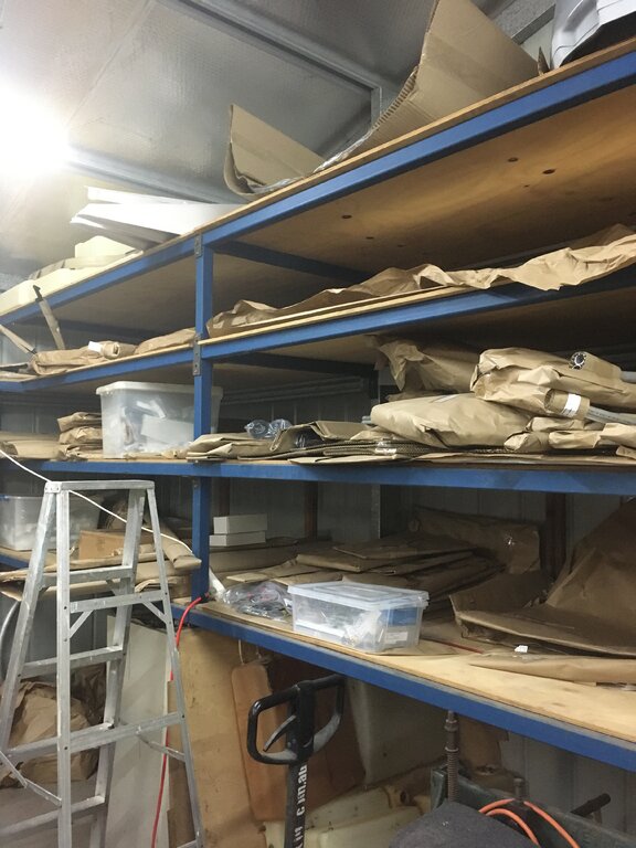

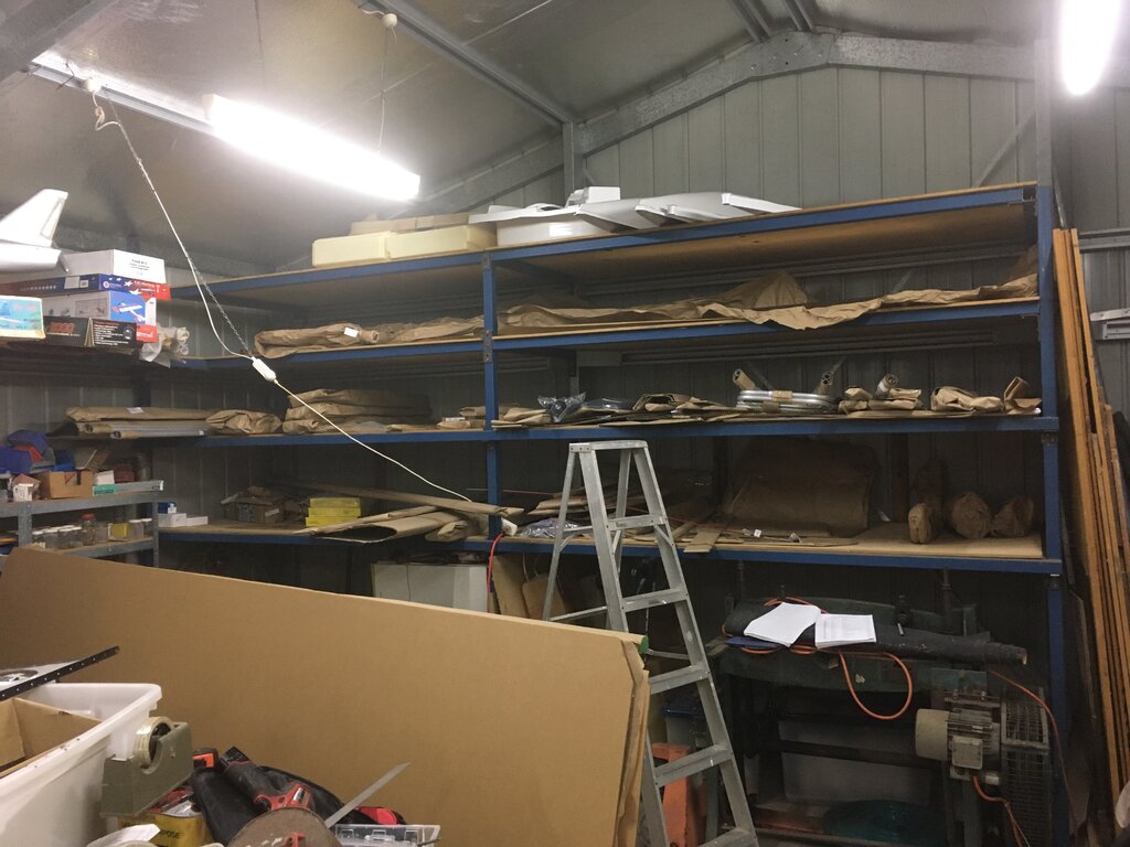

Well mission one is completed.

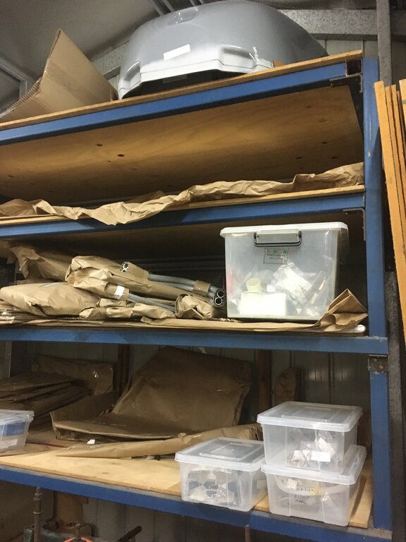

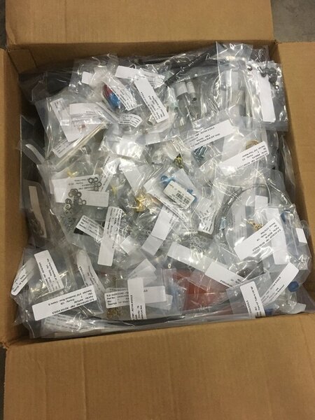

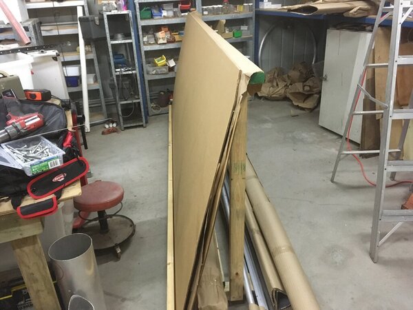

All parts are now stored safely. All the parts are sorted into big plastic tubs...the ones small enough to fit of course and there is a lot of them. All larger bits left wrapped in the brown paper they came in and all the large sheets stored flat and covered with the brown paper to stop dust which starts corrosion.

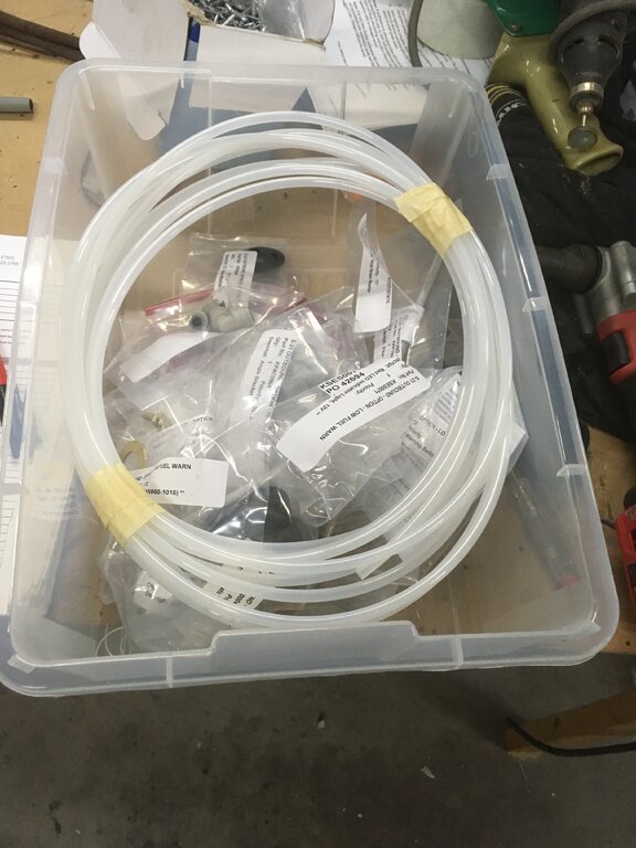

While sorting all this I ticked every single packet the parts came in off the packing list. That is a big mission too. There is 39 pages of parts in the list. They are done in sections to make it easier and they have a part number system I havent seen used before but surprisingly its easy and works well and is fast. All I have to do is get one of my mates over to give me a hand to get the cabin cage up to the top shelf out of the way up near the cowls. It should fit by the look of it.
Now its time to finish cleaning up and putting the rest of the crap I have laying around since the big cleanup either found a new spot or in the trailer off to the dump.
I can now get back onto Mabel and get her done to a stage where I can start to get the S21 under way

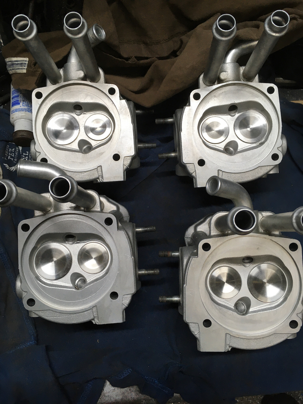

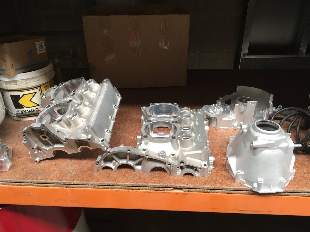

Nothing going on with the S21 yet as still working on the Sav rebuild but its getting closer. Lots of work being done on the engine though. My out of time 2015 engine has been stripped and measured to see what bearings will be needed for the mains luckily the engine is excellent and no fretting of the cases also the bore for the crank is perfectly round. The gearbox has been overhauled the crank has been welded and the crank and flywheel have also been balanced. Looks like none of the Rotax engines are balanced which is a bit of a shock especially for what they cost. So with the main assembly done I expect a big difference. The camshaft has been reground and nitrided. Most of the parts are here, new valves and gaskets and seal kits, new oil pump gears. Danny has perfected a great sequence of sand blasting the cases but not with sand its pretty tricky stuff but boy does it do a fantastic job. So just waiting on bearings and through bolts etc and the engine can go back together.

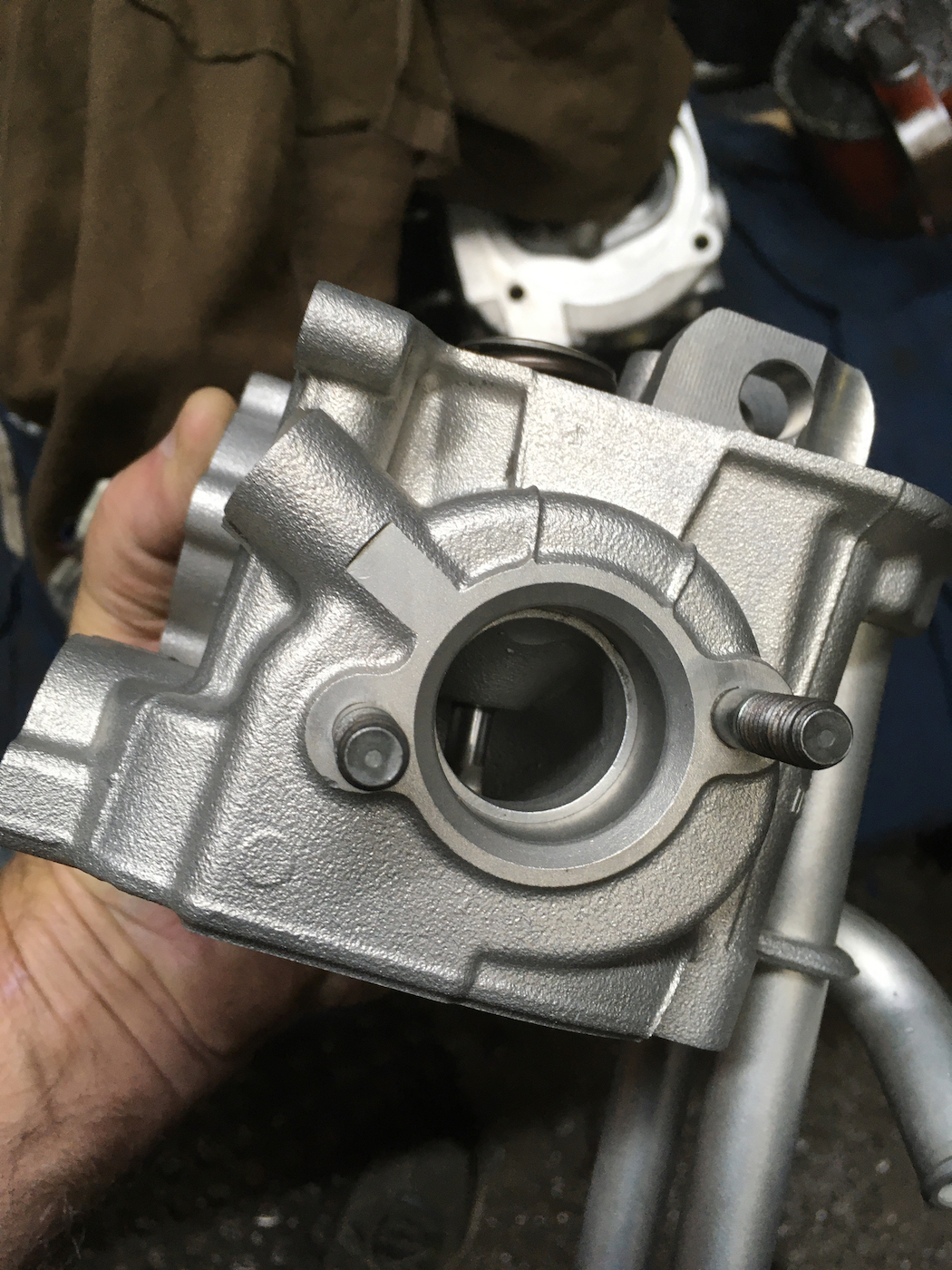

Picture of my engines cases after Danny has worked his magic on them
My big bore will be 114hp as std and hope for a bit more with a better exhaust. Danny is working on a new prop design that should be a lot better as well. This video is of a just completed S21 with a Rotax 915 IS in it. There is no wind on this day it was filmed

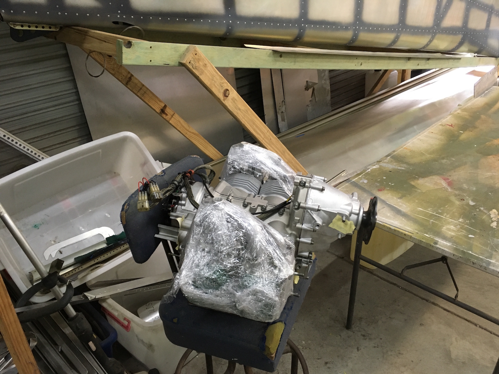

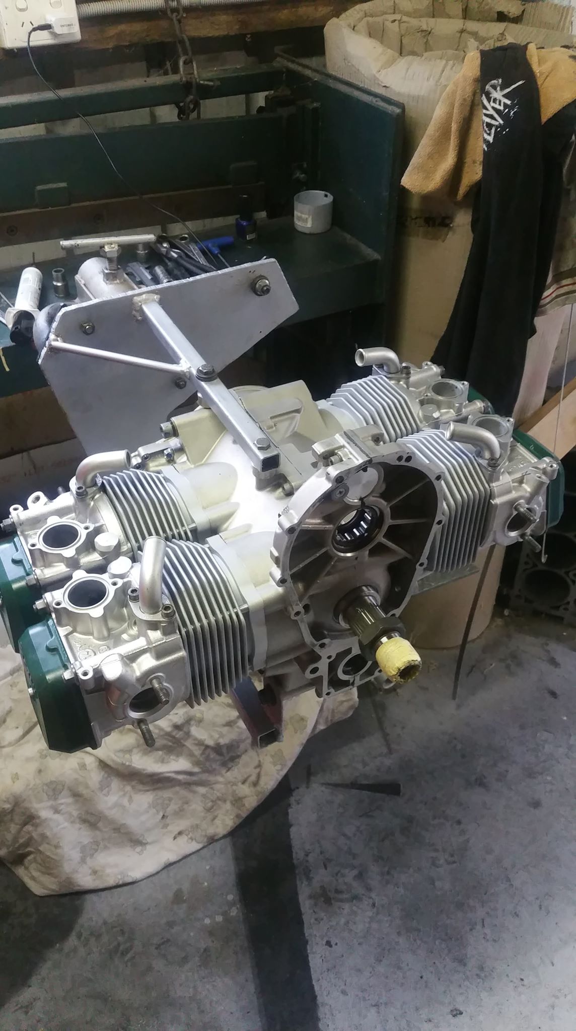

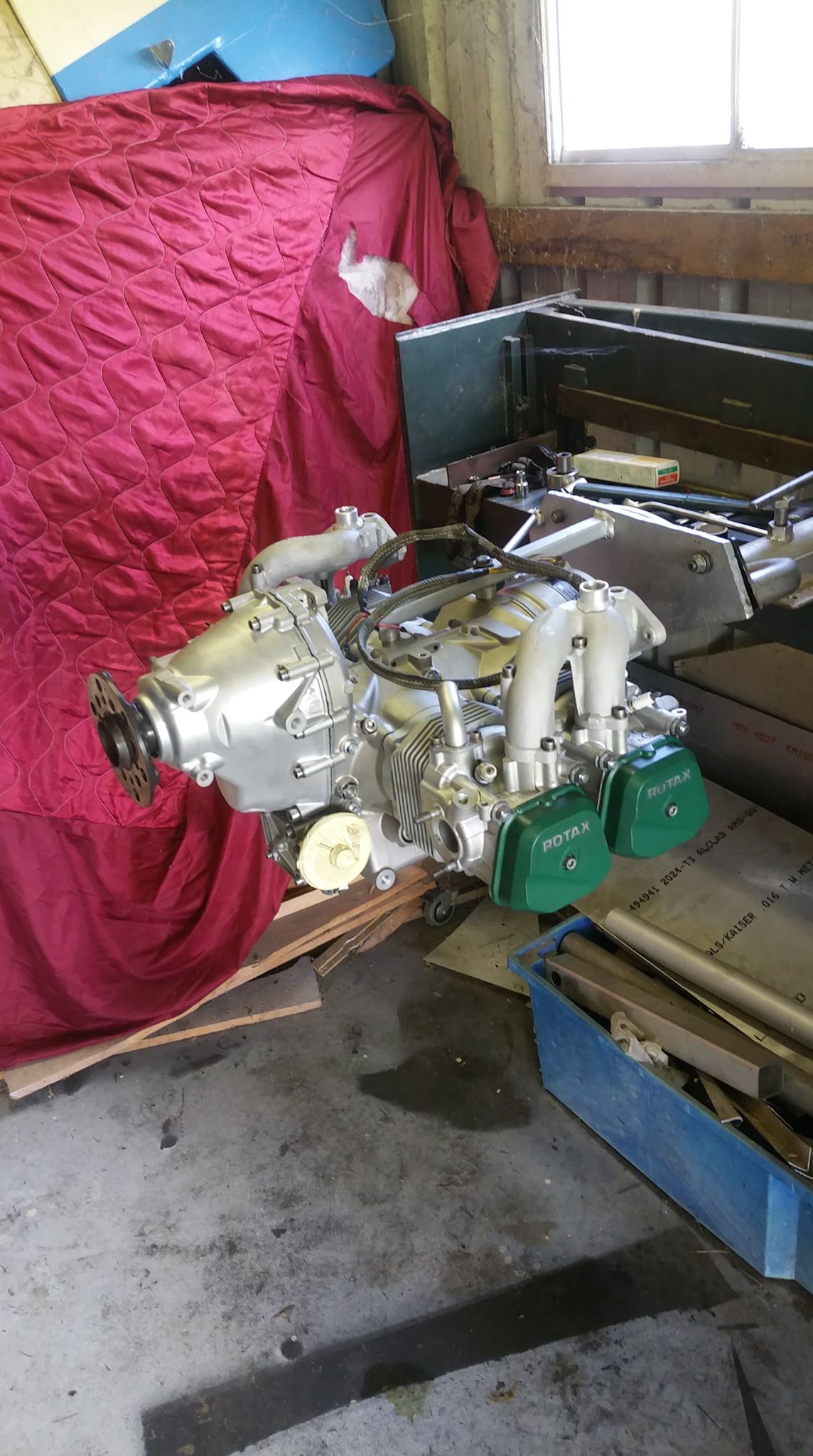

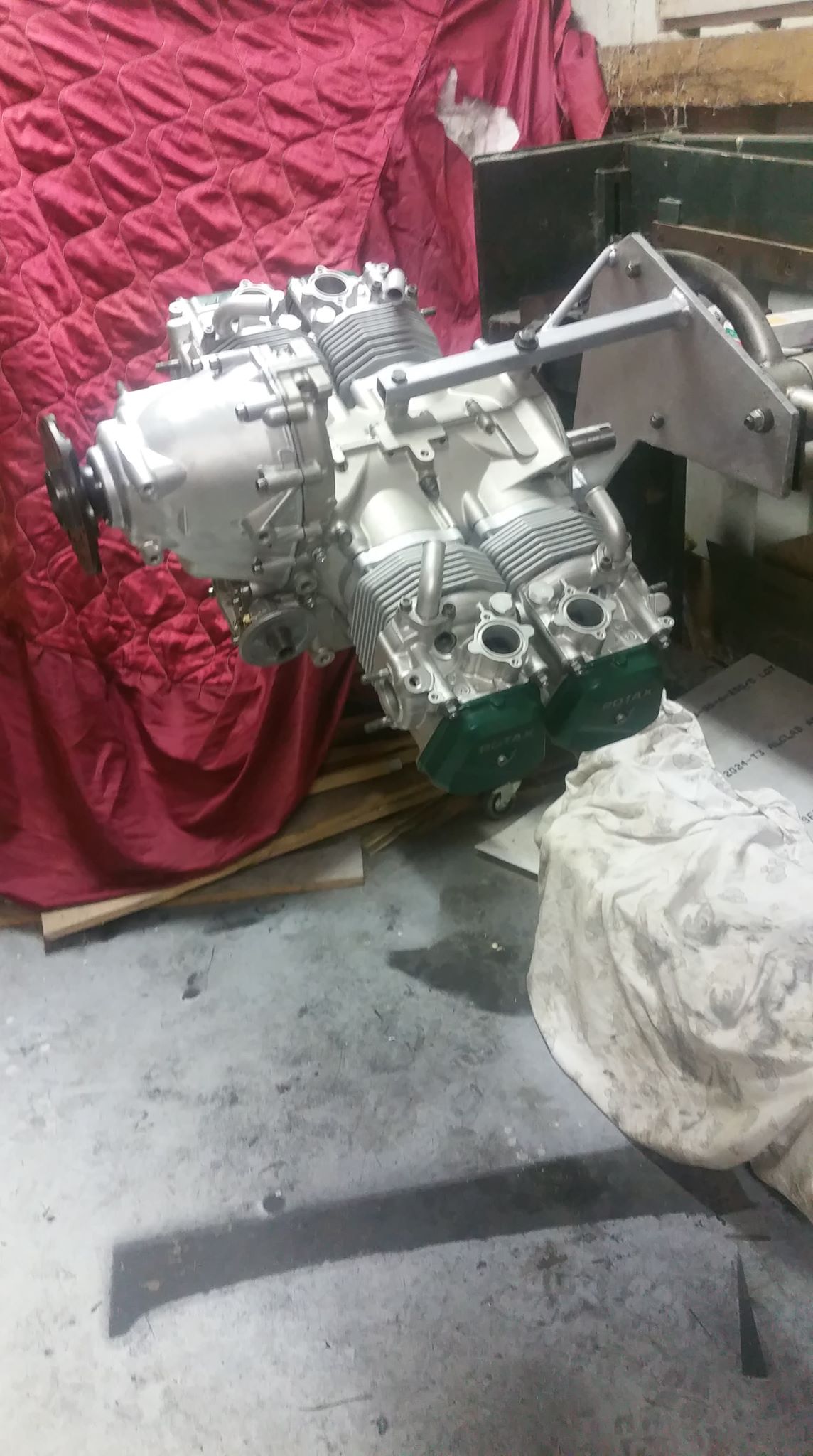

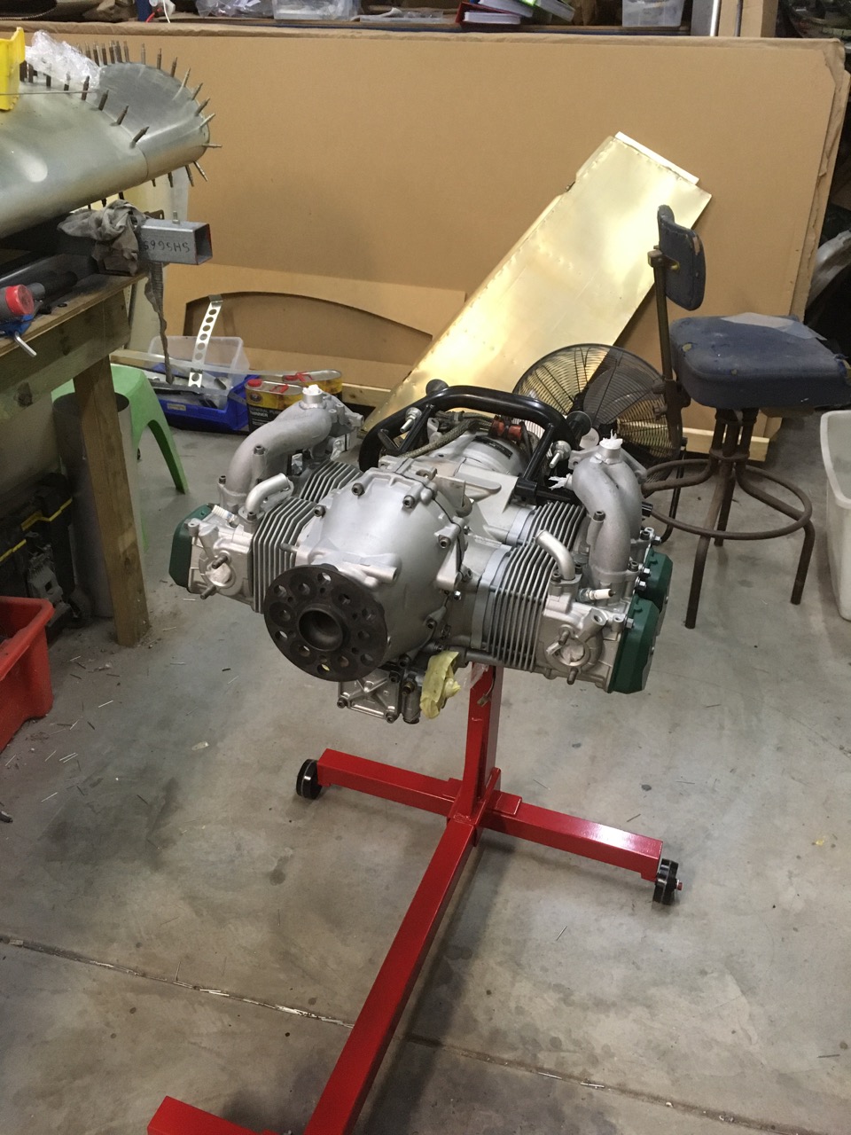

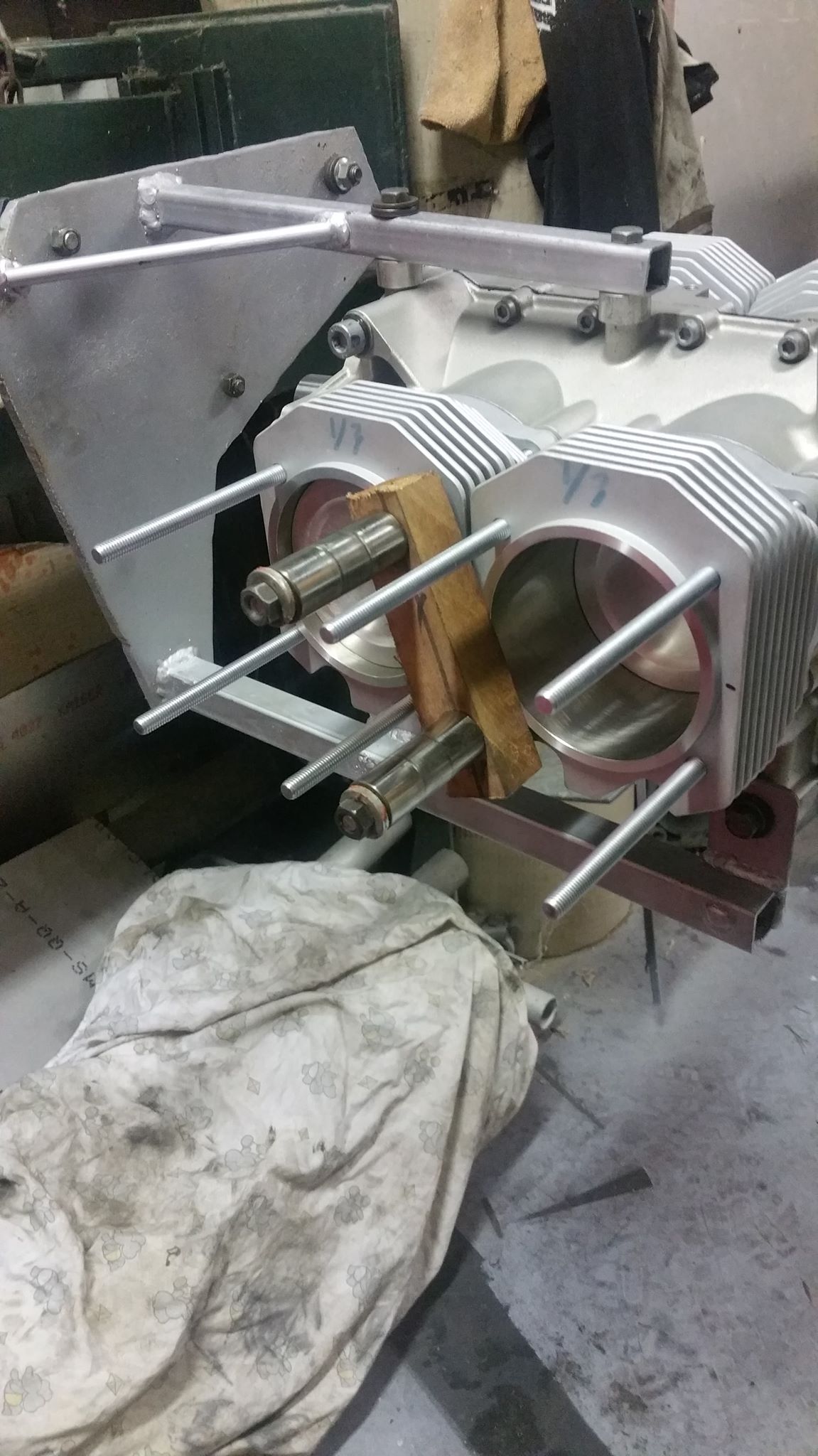

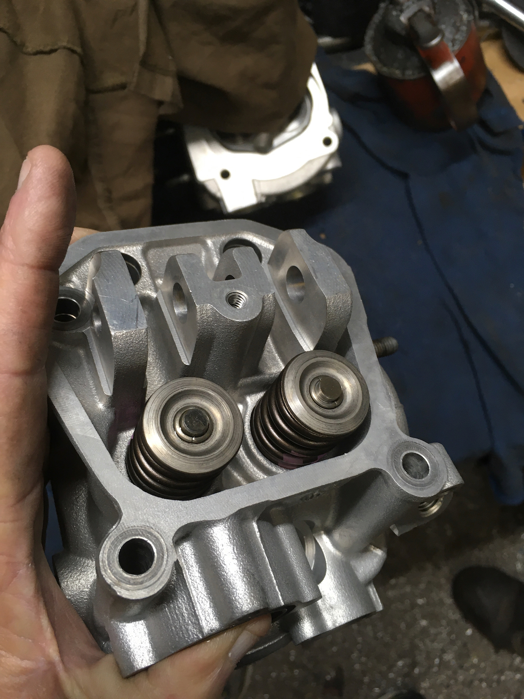

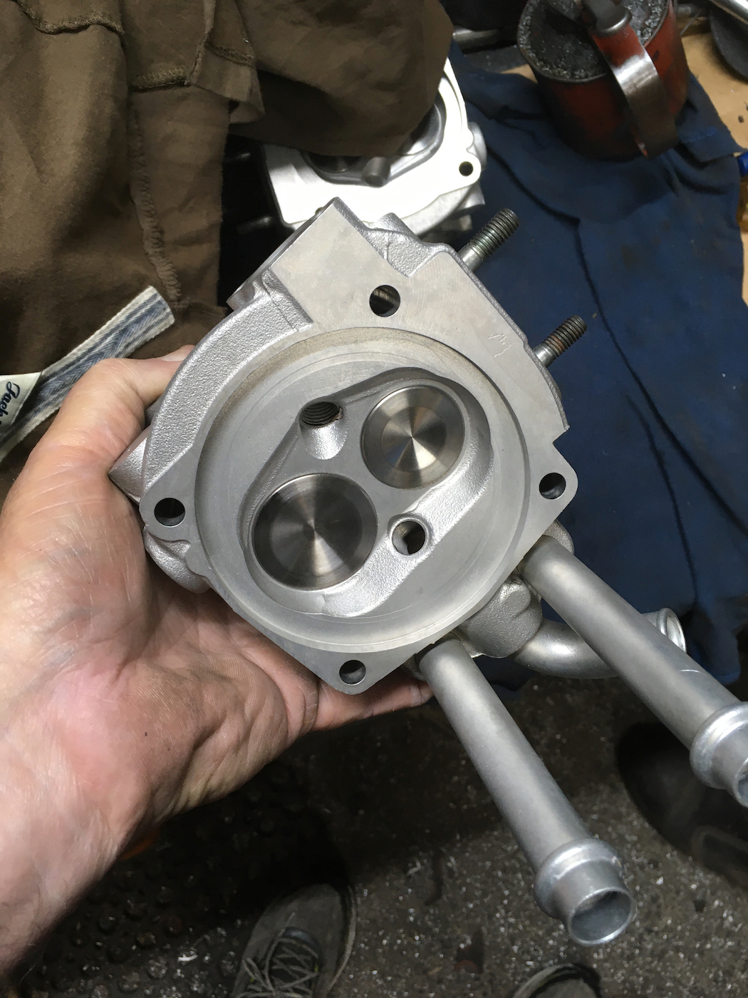

The engine is now here at home..all rebuilt.....its a beautiful thing :) Some pics of its assembly. Getting the last wing together on the Sav now and just waiting for the new dash so I can get ready to start painting..then I can get Mabel down to the hangar for final assembly and I can start on the mistress
The video shows the lifters rotating as they are supposed to when the cam has been ground correctly. There are marks on the lifters at the 12 o'clock position and they turn counter clockwise as the engine rotates
In all of this we found that the Rotax engines are NOT balanced at all..I was quite frankly shocked by this. We tested 4 cranks and flywheels to prove this. My engine has had the crank welded to make it stronger due to the larger hp and also it is balanced also the flywheel is also balanced so the whole rotating assembly is balanced. My engine guy is super impressed with the big bore kit I have. Everything is well made and done the right way. Even the pistons are perfect they are all exactly 504 grams each

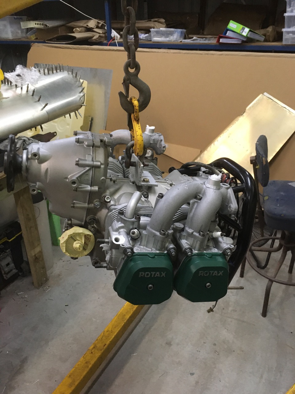

Slowly sneaking up on starting The Mistress.

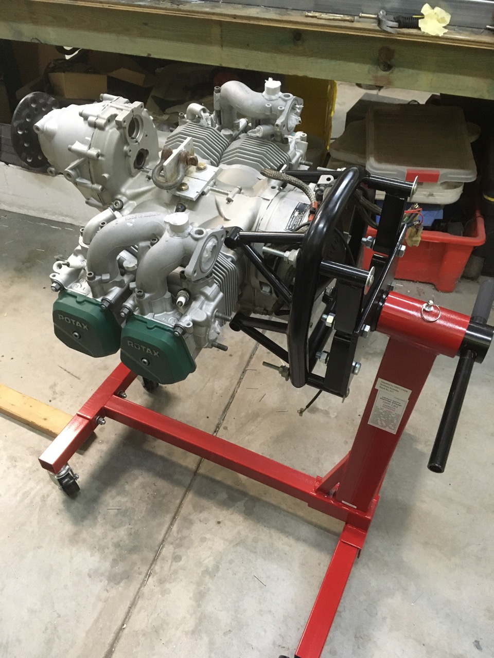

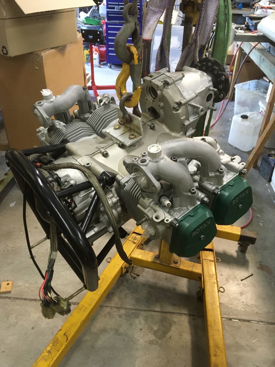

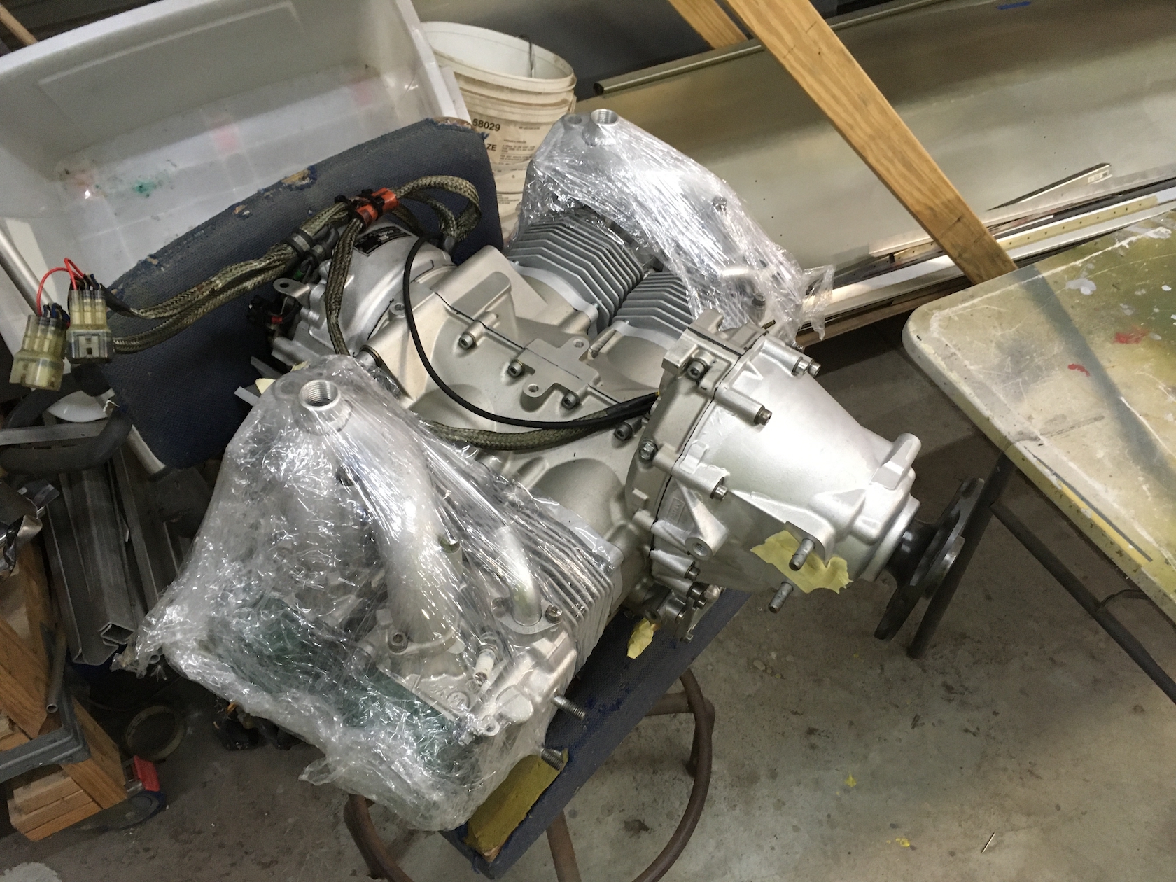

Finally got around to spraying the matt clear high temperature paint over the engine to stop that ugly corrosion that gets on the front and top of the engine over time. Got another engine stand and fitted the spare ring mount I have here to the engine so I could easily mount it on the engine stand. Now I can start fitting all the new rubber hoses and other parts to the engine. The Rans uses a bed mount for the engine so it hopefully should be easy to then fit the engine when I get that far. Once I have fitted all the bits to complete the engine then I will "season" it as it will be at least 12 months I would think until its ready to go onto the fuselage. Not too far off getting ready to paint Mabel then it will go to the hangar for assembly and final fit out. If The Girlfriend hasnt sold by then and I doubt it will due to this virus nightmare I will fly her up to the farm and leave it there to free up the hangar. Then I can work on the S-21 at home at night and Mabel during the daytimes at the hangar as there are no lights in the hangar.
