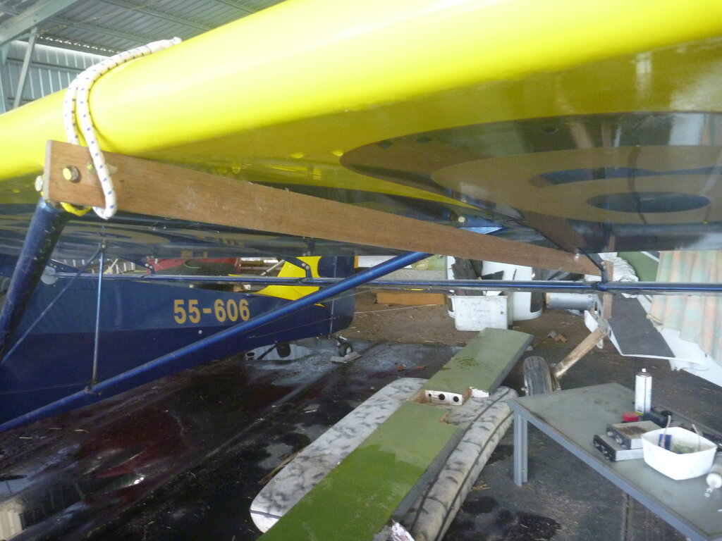

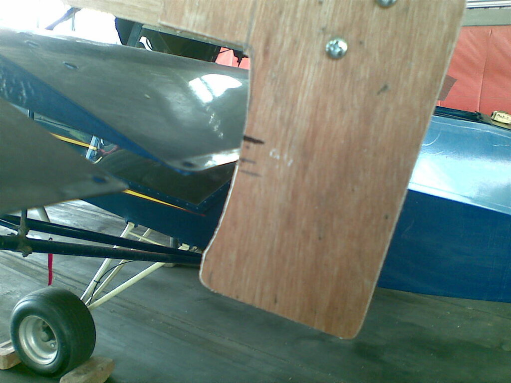

Blueadventures Posted December 9, 2019 Posted December 9, 2019 Hi Smokey This is what I made up so I could check the ailerons. You need two.

Blueadventures Posted December 10, 2019 Posted December 10, 2019 Hi Thanks I don't suppose you had a drawing or some measurements? Straight edge is fine just the curve i am really after. Cheers Have the straight edge timber or even alloy and attach the end piece and cut a rough curved shape then fit under wing a little off and hold a marker a distance behind the aileron and move it go through full deflection travel of aileron and cut out the line and that's it. I used shock cord over the top of wing to hold it on.
facthunter Posted December 13, 2019 Posted December 13, 2019 You only need to locate at the leading and trailing edges Can't you use levels a or a laser ? Once you test fly it you will probably adjust it a bit anyhow. Nev
