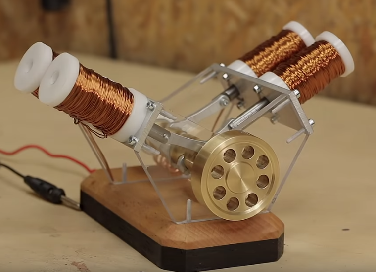

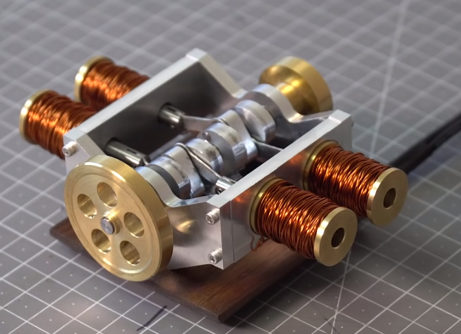

old man emu Posted December 21, 2019 Posted December 21, 2019 Here's a red herring for people who want to discuss the development of electric motors as power plants for aircraft. We normally think of electric motors for aircraft as being basically the same as electric motors we use everywhere.The fundamental purpose of the vast majority of the world's electric motors is to electromagnetically induce relative movement in an air gap between a stator and rotor to produce useful torque or linear force. The moving part is the rotor, which turns the shaft to deliver the mechanical power. The rotor has conductors laid into it that carry currents, which interact with the magnetic field of the stator to generate the forces that turn the shaft. The stator is the stationary part of the motor's electromagnetic circuit and usually consists of either windings or permanent magnets. It is also the part that adds the most to the overall weight of the motor. There is another electronic device which relies on windings to perform its function. A solenoid is a coil whose length is substantially greater than its diameter. The coil can be arranged to produce a uniform magnetic field in a volume of space when an electric current is passed through it. In practice, solenoids are used to create linear movement in an iron rod. When the rod is connected to some other device, it can operated the device as mentioned in this image. We are used to using solenoids for one action at a time, eg throwing in the Bendix spring on a starter motor, or operating the door locks on our cars. But what if a number of solenoids were grouped together to operate sequentially? First of all, lets look at how a single solenoid can be used to convert linear motion to circular motion. (Please bear with the Germanic accent) 1 1

pmccarthy Posted December 21, 2019 Posted December 21, 2019 Surely defeats the primary advantage of rotary motion. 3
onetrack Posted December 21, 2019 Posted December 21, 2019 OME - the idea is sound, but I believe the bearings on the crank arms need pressurised lubrication, for long-term durability and substantial power output. My 1977 Engel portable fridge/freezer is still running well after 42 years of fairly steady work - and it's powered by a solenoid motor (Sawafuji Swing Motor). But the Sawafuji has no crank arms, no rotating parts, and only one moving part - the piston. Maybe multiple Sawafuji motors could be combined to produce compressed air, which could then be used to propel the aircraft? 1
