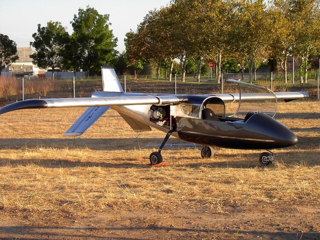

Blackhawk Posted January 21, 2020 Share Posted January 21, 2020 Anyone building, or know of someone building a Taylor MINI IMP here in Australia. I'd like to know more about the plane and it's building prosess. Cheers, Graeme Link to comment Share on other sites More sharing options...
FlyBoy1960 Posted January 21, 2020 Share Posted January 21, 2020 Unusual, ducted fan for propulsion ? Cant see a propeller. No clearance for tail strike either. Link to comment Share on other sites More sharing options...
Blackhawk Posted January 21, 2020 Author Share Posted January 21, 2020 Apperantley you've never seen the Mini Imp before; it's a pusher prop aircraft. This photo shows the propeller. Tail clearance is 14 degrees. 1 Link to comment Share on other sites More sharing options...

onetrack Posted January 22, 2020 Share Posted January 22, 2020 That thing looks like a crash waiting to happen. It's bad enough that the tail is so close to the ground, but the prop is even closer. A bit of a gust on landing, creating a nose-up attitude, and it'd be all over, red rover. Link to comment Share on other sites More sharing options...
Thruster88 Posted January 22, 2020 Share Posted January 22, 2020 The risk of propeller or drive shaft failure taking the tail off would be a no for me not to mention the joy of working on the engine. 1 Link to comment Share on other sites More sharing options...
Blackhawk Posted January 22, 2020 Author Share Posted January 22, 2020 I think I'll have to refrase my question. I don't require any information off the internet as I have all of it; and some. What I should have said: "Anyone building, or know of someone building a Taylor MINI IMP here in Australia. I'd like to know more about the building process." 1 Link to comment Share on other sites More sharing options...
Deskpilot Posted January 23, 2020 Share Posted January 23, 2020 Guys, look closely at the drawing. There's a skid below the tail plane which will prevent prop strike. If you get to that point, you're going to be very near stall anyway so stay away from it. The plane is as safe as the pilot wants it to be. 1 Link to comment Share on other sites More sharing options...
