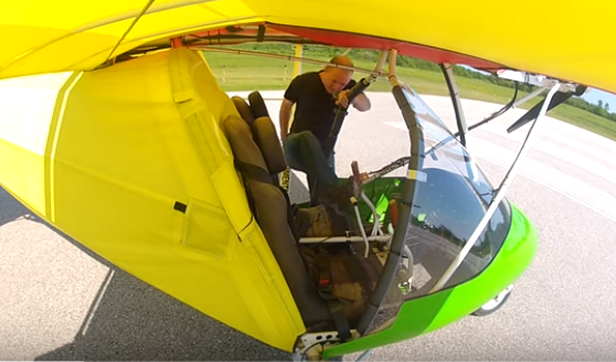

Old Koreelah Posted February 15, 2020 Posted February 15, 2020 But how in hades do you get into and out of one?
Hunsta Posted February 15, 2020 Author Posted February 15, 2020 If you want to go fast, buy something else. Think I mentioned that The X-Air is good for dawdling around, they can be fun (not as much as a Drifter of course). The Drifter is also one Ive had a look at, and like the look of. But I have another novice question. Technically the ones Ive seen are taildraggers. Does that mean to fly one, one has to be taildragger certified?
red750 Posted February 15, 2020 Posted February 15, 2020 But how in hades do you get into and out of one? 3
Hunsta Posted February 15, 2020 Author Posted February 15, 2020 I actually watched that vid this morning. His grin at the end got me hooked
M61A1 Posted February 15, 2020 Posted February 15, 2020 I have posted this previously, but it seem appropriate here.... 1
FlyBoy1960 Posted February 15, 2020 Posted February 15, 2020 The one at our airport has a much wider entry than the imade from RED 750. The bar is in front of the seat base, so the opening is much, much wider. I tried to get infor today but the owner was not at the airport, sorry. 1
