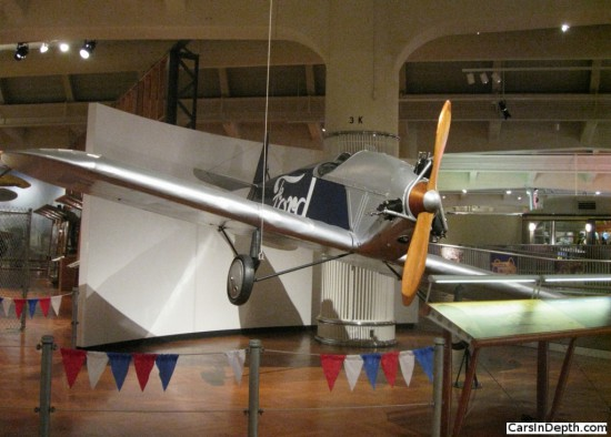

old man emu Posted May 15, 2020 Author Posted May 15, 2020 Just about every aeroplane has wing diherdral. The only one I've really looked at that doesn't as the Ford Flivver. https://www.thetruthaboutcars.com/2014/07/henry-fords-flying-flivver-the-model-t-of-the-air/ As for the Corsair, I can see that the gull wing would reduce the overhead space when the wings are folded. As for allowing the wing to join the fuselage to join the fuselage at 90 degree, neither the Corsaid not Stuka have their wings attached at 90 degrees. Look at the 3-views. 1 1

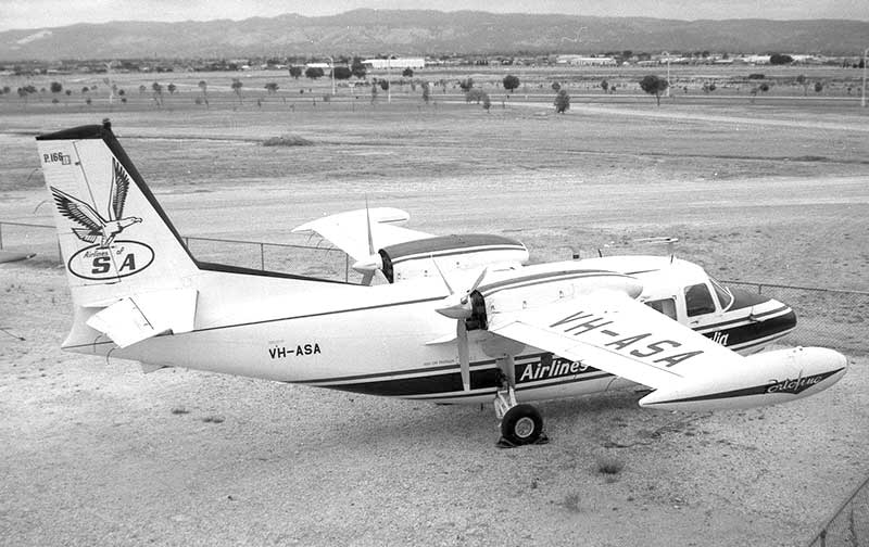

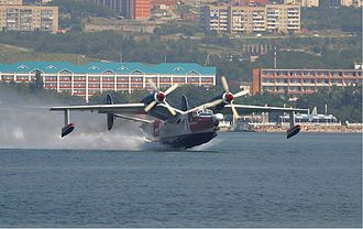

old man emu Posted May 15, 2020 Author Posted May 15, 2020 I can see the advantage in gull wings for flying boats, and the wonderful Piaggio P.166B, but where's the advantage in the inverted gull wing for the Stuka?
