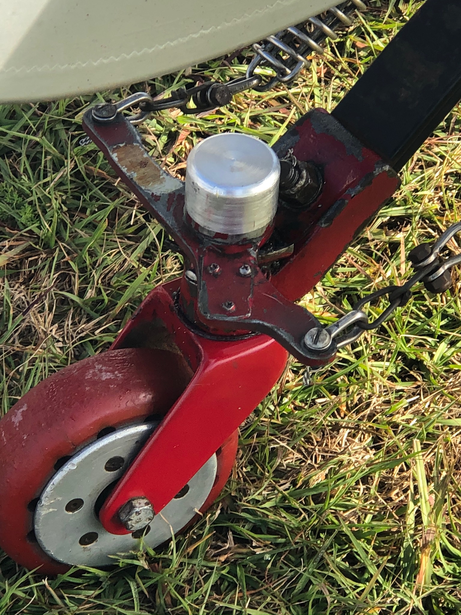

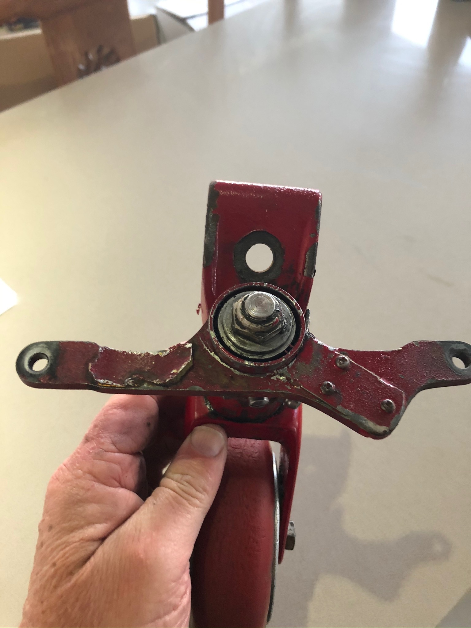

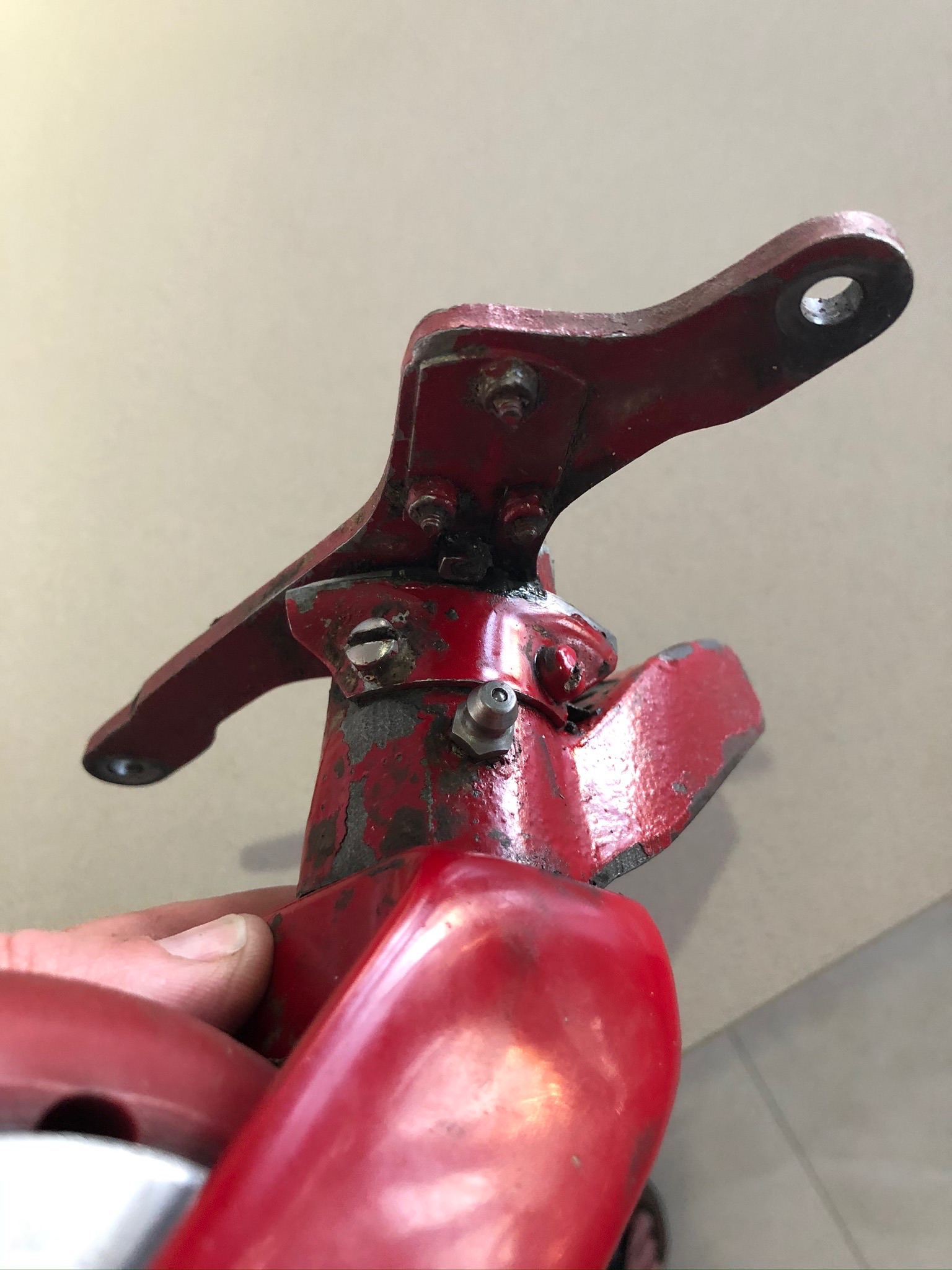

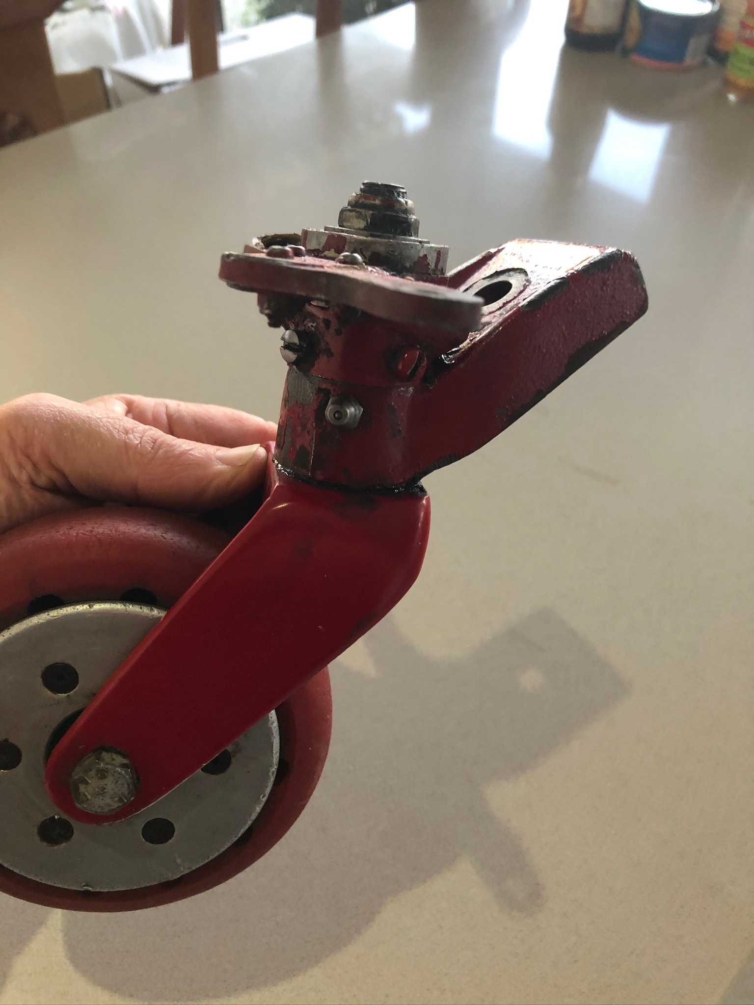

Nobags Posted June 3, 2020 Share Posted June 3, 2020 Hi Gurus, If a person could positively identify the manufacturer of the following tail wheel assembly that would be great. Please disregard the tail wheel itself, that will not ident the assembly. Reason, new grease cap is required, and I want to get a spare bushing too! Grease cap is 1.25 inch or 31.7mm All exact answers gratefully received. Please see attached photos....... Link to comment Share on other sites More sharing options...
kaz3g Posted June 3, 2020 Share Posted June 3, 2020 Looks similar to my Scott but no idea. Sorry. Link to comment Share on other sites More sharing options...
Student Pilot Posted June 3, 2020 Share Posted June 3, 2020 Matco? Scott? Link to comment Share on other sites More sharing options...
Student Pilot Posted June 3, 2020 Share Posted June 3, 2020 Maule looks similar, what was it attached to? 1 Link to comment Share on other sites More sharing options...
old man emu Posted June 3, 2020 Share Posted June 3, 2020 It could be one of these: Search Results | Aircraft Spruce 1 Link to comment Share on other sites More sharing options...
M61A1 Posted June 3, 2020 Share Posted June 3, 2020 The lock/unlock mechanism looks like a Maule but the fork doesn’t. Is it a hybrid? 1 Link to comment Share on other sites More sharing options...
onetrack Posted June 4, 2020 Share Posted June 4, 2020 I'll go for Maule. Brush a thin coat of paint stripper onto the aluminium tag, then wash it off with water, and see if the writing becomes visible on the tag. https://www.ebay.com/itm/Maule-Tail-Wheel-Control-Arms-for-Swiveling-Tailwheel-/323733284313 1 Link to comment Share on other sites More sharing options...
Nobags Posted June 4, 2020 Author Share Posted June 4, 2020 I'll go for Maule. Brush a thin coat of paint stripper onto the aluminium tag, then wash it off with water, and see if the writing becomes visible on the tag. https://www.ebay.com/itm/Maule-Tail-Wheel-Control-Arms-for-Swiveling-Tailwheel-/323733284313 Thanks onetrack, unfortunately I tried that but the tag disintegrated ? I’m inclined to think it’s a maule type, however I haven’t seen a ‘fork’ type tw on all the websites I’ve been active in. Link to comment Share on other sites More sharing options...
Nobags Posted June 4, 2020 Author Share Posted June 4, 2020 The lock/unlock mechanism looks like a Maule but the fork doesn’t. Is it a hybrid? Trying to get to the bottom of it, I agree looks like early maule but the fork arghhhhh! Link to comment Share on other sites More sharing options...

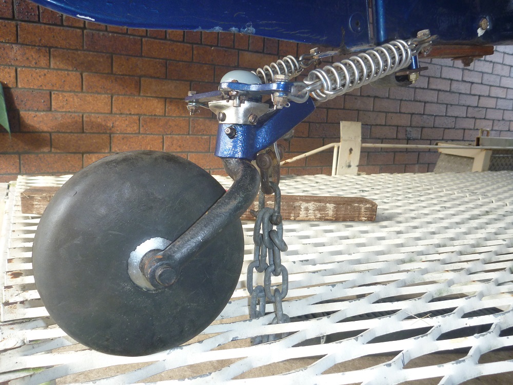

Blueadventures Posted June 4, 2020 Share Posted June 4, 2020 Hi Gurus, If a person could positively identify the manufacturer of the following tail wheel assembly that would be great. Please disregard the tail wheel itself, that will not ident the assembly. Reason, new grease cap is required, and I want to get a spare bushing too! Grease cap is 1.25 inch or 31.7mm All exact answers gratefully received. Please see attached photos....... [ATTACH type=full" alt="5D79341C-0C57-4966-B62D-B987681EB84C.jpeg]53671[/ATTACH][ATTACH type=full" alt="F849D0F5-D79D-45FC-9401-E1F3F2F81743.jpeg]53672[/ATTACH][ATTACH type=full" alt="CDD5EA75-268C-41E8-BBB0-1929660DB398.jpeg]53673[/ATTACH][ATTACH type=full" alt="91CC7626-FFC4-4FBE-8BF3-754F16DB1CA0.jpeg]53674[/ATTACH] Take it down to Rob Stowe at Coastal Aviation at Caloundra as it looks like the one I had on my old CA21 Skyfox. He has parts for the Skyfox's. I got all the refirb parts for Aircraft Spruce back when I did it. Cheers 1 Link to comment Share on other sites More sharing options...
Nobags Posted June 4, 2020 Author Share Posted June 4, 2020 Take it down to Rob Stowe at Coastal Aviation at Caloundra as it looks like the one I had on my old CA21 Skyfox. He has parts for the Skyfox's. I got all the refirb parts for Aircraft Spruce back when I did it. Cheers Thank you kind sir, WILCO ? Link to comment Share on other sites More sharing options...
Blueadventures Posted June 4, 2020 Share Posted June 4, 2020 Thank you kind sir, WILCO ? Hi This is the tail wheel after I did the service, parts and repaint. Parts included the new wheel, oilite bearing, key, spring and the cover cap. Can't put my hand on the pulled apart images. Is this what yours looks like if so it is what is used on the Skyfox tail draggers. Cheers. Link to comment Share on other sites More sharing options...

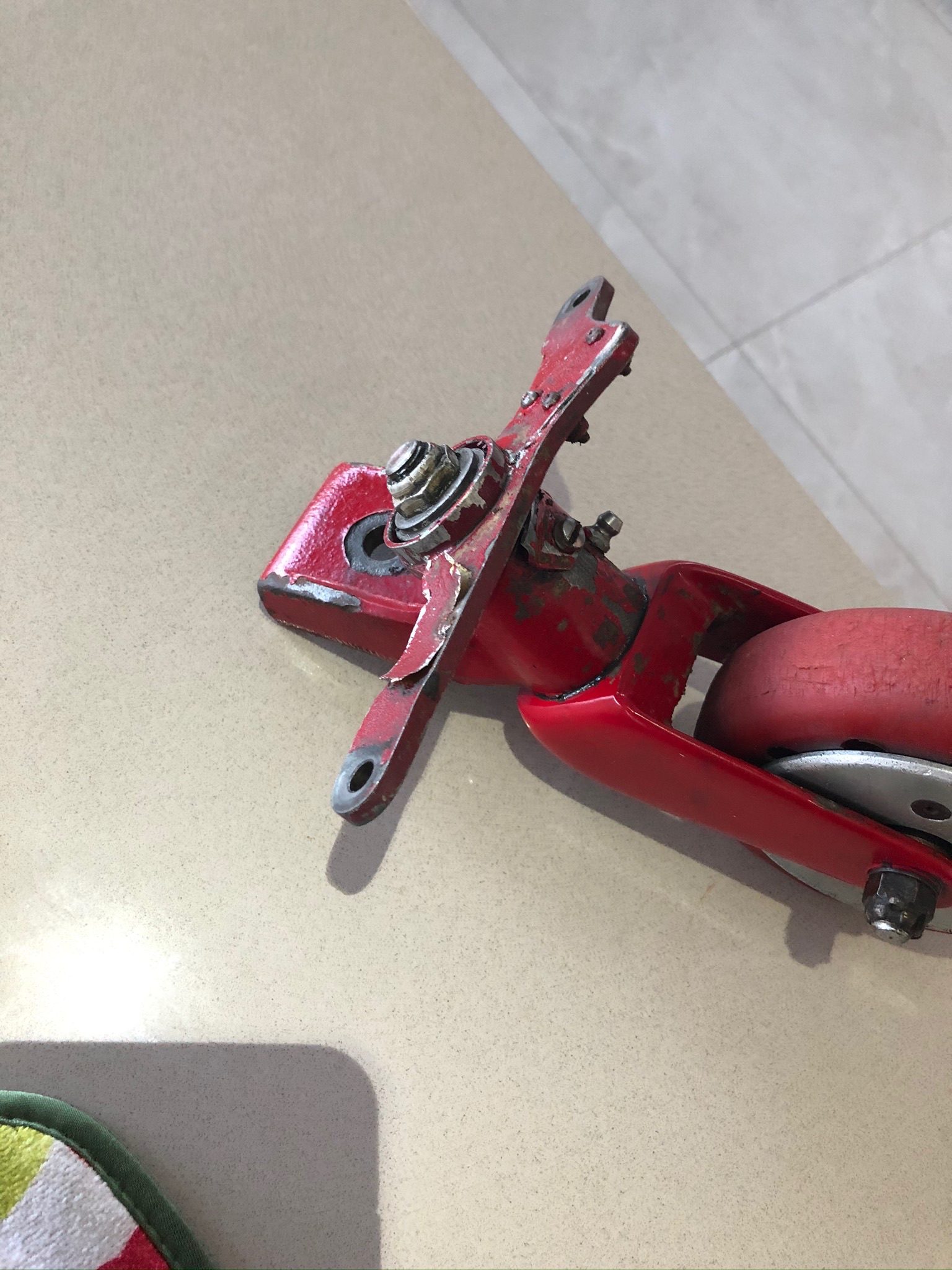

Nobags Posted June 6, 2020 Author Share Posted June 6, 2020 Hi This is the tail wheel after I did the service, parts and repaint. Parts included the new wheel, oilite bearing, key, spring and the cover cap. Can't put my hand on the pulled apart images. Is this what yours looks like if so it is what is used on the Skyfox tail draggers. Cheers. [ATTACH=full]53716[/ATTACH] Thanks for the photo! Visited Coastal, didn’t see Stowe, no help. Have since sent photo to Maule direct, my tw assembly (not the wheel) appears to be a pre 1976 tw. Cap is not available (I found a plastic temporary one atm) sizing now different. The cap is presently the only requirement, as you say the locking bearing and pins etc are the same for mine. The internal main bearing (when it gets worn) will be required to be made here in a lathe shop. Aircraft Spruce show the breakdown of parts, and they also confirm no caps available. I am currently talking with a mate who rebuilds old cars, 1.25 inch grease cups may be coming! ?✌ Thanks to every one for your assistance! 1 Link to comment Share on other sites More sharing options...
Blueadventures Posted June 6, 2020 Share Posted June 6, 2020 Thanks for the photo! Visited Coastal, didn’t see Stowe, no help. Have since sent photo to Maule direct, my tw assembly (not the wheel) appears to be a pre 1976 tw. Cap is not available (I found a plastic temporary one atm) sizing now different. The cap is presently the only requirement, as you say the locking bearing and pins etc are the same for mine. The internal main bearing (when it gets worn) will be required to be made here in a lathe shop. Aircraft Spruce show the breakdown of parts, and they also confirm no caps available. I am currently talking with a mate who rebuilds old cars, 1.25 inch grease cups may be coming! ?✌ Thanks to every one for your assistance! maybe 3D print a cap. Oilite material is a standard for bearings so any fitter will be able to make, try a mans shed with a metal lathe they would like making things that are used. Cheers. Link to comment Share on other sites More sharing options...
Nobags Posted July 5, 2020 Author Share Posted July 5, 2020 Howdy, Finally worked out the TW is basically a pre 1976 Maule type. Caps not available any more but the ‘wings’ and ‘pin’ and it’s bearing are available. The local metal shop lathed a new cap. Great job! 1 1 Link to comment Share on other sites More sharing options...
