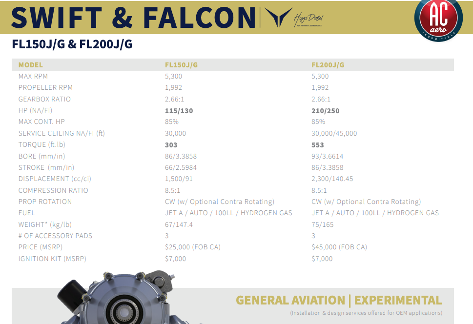

Kyle Communications Posted July 11, 2020 Posted July 11, 2020 This is a interesting development. Maybe later this year we will see how they are when released http://www.ac-aero.com/swift-fl150/ http://www.ac-aero.com/wp-content/uploads/2020/05/ac_FALCON_2020_R00_051820.pdf

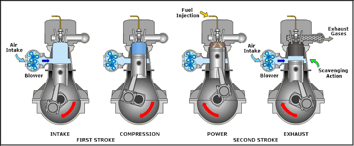

Thruster88 Posted July 11, 2020 Posted July 11, 2020 They appear to be like a GM diesel 2-stroke ie super charged but without the exhaust valves in head. Not sure how that works.
kasper Posted July 11, 2020 Posted July 11, 2020 At US$32,000 fob California it ain’t a replacement for a 912
Kyle Communications Posted July 11, 2020 Author Posted July 11, 2020 Price I saw was US$25,000 AU$39,000 inc GST The 915IS here is AU$60,000

facthunter Posted July 11, 2020 Posted July 11, 2020 Stepped piston two strokes were used nearly 100 years ago in Dunelts and maybe others. Emmissions, exhaust noise and internal (piston) cooling are bugbears of this style of motor. it's not far removed in principle from the GM diesel 2 strokes. Nev
onetrack Posted July 11, 2020 Posted July 11, 2020 Nev, the Higgs and SPV580 engine designs are quite a step away from early stepped piston designs, and GM 2 stroke diesels. The big thing with the former engine designs is the total separation of the combustion and oiling areas.
facthunter Posted July 11, 2020 Posted July 11, 2020 That's always been available if you wanted it and the GM had it.. It gives you a better chance of cooling the pistons but they still get heated twice as often. I've got a six cylinder( 2 by 3) radial design with a blower, done on much the same principle but I can't see how you would beat the emissions requirements. Nev

kasper Posted July 11, 2020 Posted July 11, 2020 Price I saw was US$25,000 AU$39,000 inc GST The 915IS here is AU$60,000 Don’t know where the price you saw came from. My price comes from the webpage you linked in your post. My guess is that landed oz incl gst will be near au$55k normal aspiration plus au$10k extra if you want it fuel injected. ... for a start up new design that’s quite steep.

Kyle Communications Posted July 11, 2020 Author Posted July 11, 2020 Look at the bottom..dont know where you got the US$35,000 from
kasper Posted July 11, 2020 Posted July 11, 2020 (edited) My mistake. 25+7=32 plus crate and ship at least 3 takes it to 35. Add gst and you’re at 38.5 and then convert to oz peso and it’s au$55 for an injected engine in oz. that is still untested. how much is a six pot Jabiru engine? Same power. Around the same weight ... Edited July 11, 2020 by kasper 2
Kyle Communications Posted July 11, 2020 Author Posted July 11, 2020 Only if you want or need the ignition kit..otherwise you run the engine as supplied...most likely on diesel or JetA
Thruster88 Posted July 11, 2020 Posted July 11, 2020 Only if you want or need the ignition kit..otherwise you run the engine as supplied...most likely on diesel or JetA The compression ratio is not high enough to run without ignition. I must confess my ignorance of stepped piston engines before today, now I am wondering why that is.

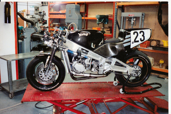

Discus647 Posted July 11, 2020 Posted July 11, 2020 That's a blast from the past! I recall getting excited about each new innovative engine being developed in the Norton works; the Cosworth twin, the Rotary and the Favell/Wulf stepped piston. Each one carried the hopes of a resurgence in the British motorcycle industry. Their engineers and designers were top notch, but how could their production systems compete against hyper efficient Japanese mass production? I worked at the Norton factory at wolverhampton in the 70s and remember seeing the 500 wulf and the early rotary engine as you said lots of promise then the place was closed, i ended up working for Norton on the JPS norton race team from 89 to 93 with great success winning british championships and the iom TT against the japanese teams 1 1

Old Koreelah Posted July 12, 2020 Posted July 12, 2020 I worked at the Norton factory at wolverhampton in the 70s and remember seeing the 500 wulf and the early rotary engine as you said lots of promise then the place was closed,[ATTACH alt=NRS 4 Terry.jpg]54614[/ATTACH] i ended up working for Norton on the JPS norton race team from 89 to 93 with great success winning british championships and the iom TT against the japanese teams Great to hear; I bet you have plenty of interesting stories to tell. Besides their innovative engine designs, Norton produced so many pioneering innovations in frames, brakes and wheels. They sure deserved to succeed.
