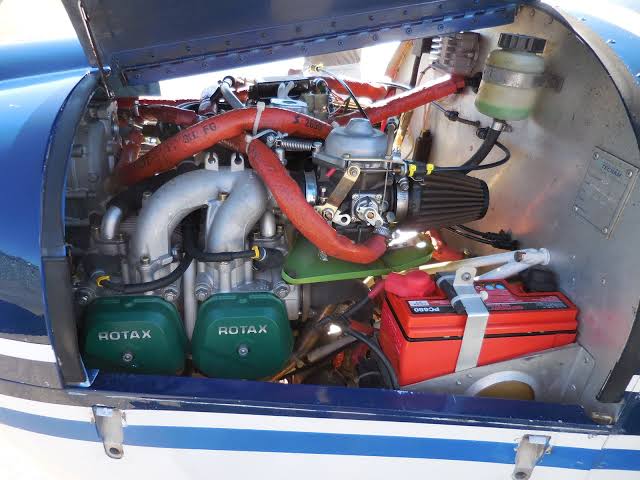

Thruster88 Posted August 8, 2020 Posted August 8, 2020 Any one made under carb drip trays for carbs with the air filters on the back? I’m looking at making a set out of aluminium with a 6 or 8mm i.d. drain tube. Images appreciated. Cheers. If you are going to do it make the sides at least 15mm high and slope it down to the outlet. The ones fitted to this factory machine are completely useless. From memory they are held with a tab underneath the air filter clamp. Dont get me started on the positioning of the coolant recovery tank above the pressure cap, they obviously never removed the cap at the factory. 1

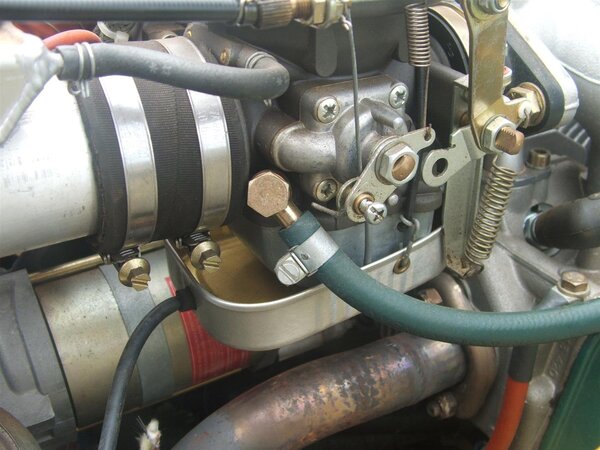

JG3 Posted August 10, 2020 Posted August 10, 2020 I found that these sardine tins do the job very well. Fit snugly around the float bowl. Held up by either light bungy cord or tie wire. Drain tube is plastic drip irrigation line forced into slightly undersize hole. Been using them for 10 years no problems. Light weight and the price is right..... I particularly like their heat shield function from the hot exhaust right below. 4 1 1
