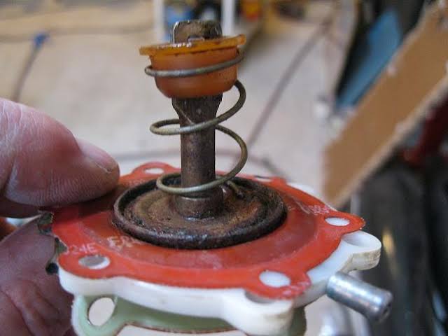

Bruce Tuncks Posted August 22, 2020 Author Posted August 22, 2020 Today I took out the fuel pump and had a good look at it. As has been said, the diaphragm is a double thing with a drain in between. If the top diaphragm got a hole, fuel would exit at the spacer between the diaphragms. To get to the crankcase, the fuel would have to get past the second diaphragm and also the fuel-pump drive-pin, which is a working fit in the side of the crankcase. These things explain to me why we have never heard of the fuel pump system causing a failure. And the official "life" of the fuel pump is the TBO, at which time the pump is replaced. The pump itself is a " made in Italy" CD brevettato and it works by a drive pin against a lever mechanism which pulls a diaphragm-piston down against a spring. If no fuel is being used, the drive pin misses the lever as the lever stays depressed. The depressed lever corresponds to the chamber above the piston being full of fuel and pressurized by the spring. If fuel is being used, the spring sets the pressure and the lever mechanism moves toward the pin and gets some pushing. When I removed it, the lower part of the fuel pump was full of oil. This may have come in from the drive-pin, but I can't see how it gets out again. Does anybody know? The pic shows the 2 diaphragms with a vented plastic spacer in between. The biggest vent is facing the camera. 1 1
