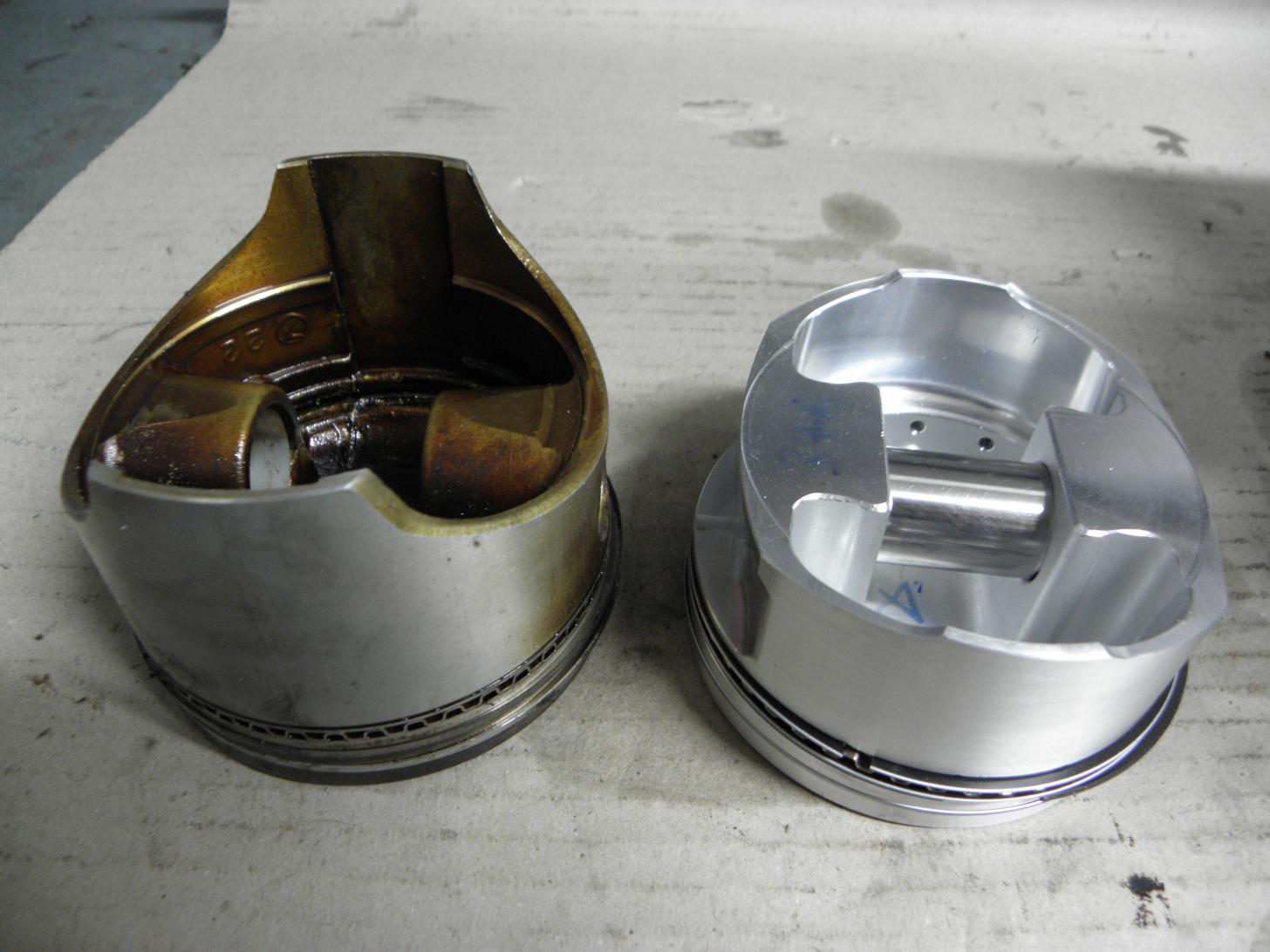

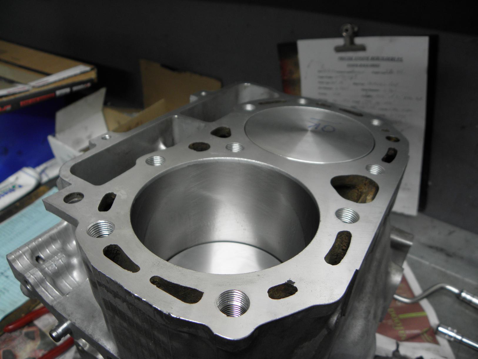

will kirkbride Posted October 13, 2010 Posted October 13, 2010 Subaru EA81 update Just an update on the progress of the Subaru engine for anyone interested. After strip down and measuring, the block halves were machined and line bored, including the camshaft and oil pump housing. All threads were helicoiled to improve reliability. Custom steel con rods with larger bolts , ended up the same weight as the originals. Forged pistons with narrow rings for less friction. weight of these were approx. 50 grams lighter than the Subaru cast pistons. Block was machined for zero deck height for the pistons. Rebore and honing of cylinders to .5mm oversize. Crankshaft was polished and measured. As there was no wear, journals were linished. Next step is to balance the rotating assembly after the redrive is finished. [ATTACH]12141.vB[/ATTACH][ATTACH]12142.vB[/ATTACH][ATTACH]12143.vB[/ATTACH]

AirWolf Posted April 4, 2014 Posted April 4, 2014 Subaru EA81 updateJust an update on the progress of the Subaru engine for anyone interested. After strip down and measuring, the block halves were machined and line bored, including the camshaft and oil pump housing. All threads were helicoiled to improve reliability. Custom steel con rods with larger bolts , ended up the same weight as the originals. Forged pistons with narrow rings for less friction. weight of these were approx. 50 grams lighter than the Subaru cast pistons. Block was machined for zero deck height for the pistons. Rebore and honing of cylinders to .5mm oversize. Crankshaft was polished and measured. As there was no wear, journals were linished. Next step is to balance the rotating assembly after the redrive is finished. [ATTACH]12141.vB[/ATTACH][ATTACH]12142.vB[/ATTACH][ATTACH]12143.vB[/ATTACH] Hi, I am rebuilding an EA 81 and would like to know more about the custom con rods and where they are available from. Cheers Ray.
