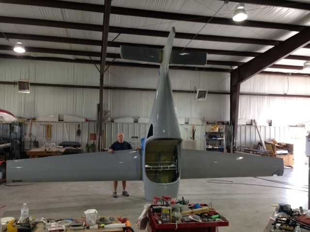

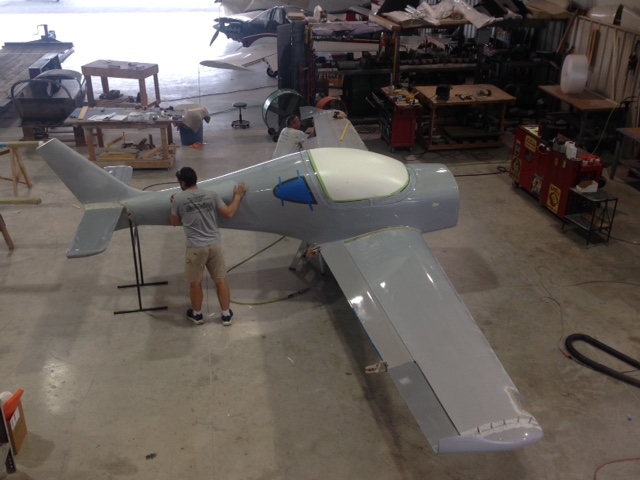

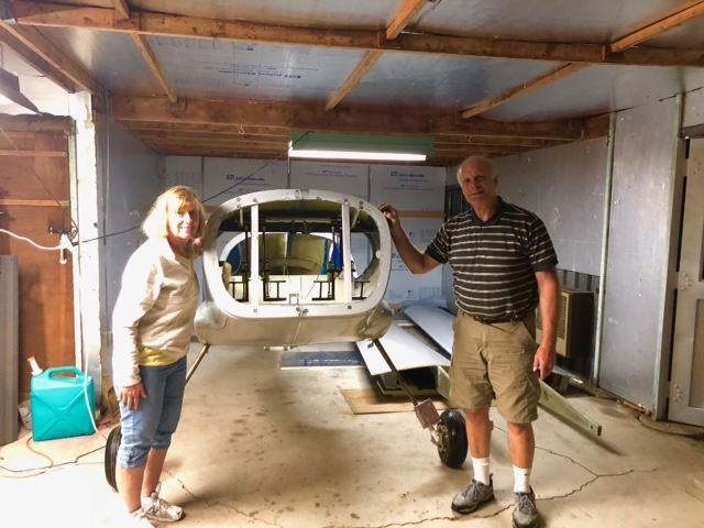

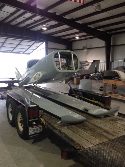

Guest langted Posted January 11, 2019 Posted January 11, 2019 Dave: Here are a few. Just like yours, except trip home. Classic Arion photo while being flipped over after wing and tail mount (about day 3) Last time the wings were fitted, on mains, canopy in place, flaps, ailerons, but no elevators/rudder (about day 5) Getting ready to go home, day 7. (No, not tailwheel, just no place for training wheel yet) Arrived home, in shop (also showing forward flange without firewall)
