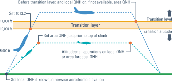

old man emu Posted July 21, 2020 Posted July 21, 2020 Im a student ra Aus pilot studying for my bak exam. Like many students, aiming for a full understanding of a topic, you are reading too much into why we have sub-scales on an altimeter. There are two "Q" codes we use, QFE and QNH. QFE is the air pressure at the airfield reference point. You find the QFE by turning the sub-scale knob until the altimeter reads Zero Ft. Assuming that the airfield is as flat as a billiard table, and altimeter set at QFE will be the same as the airfield reference point. In reality, if you are sitting on a hump that's higher than the reference point, you'll be out be a couple of feet - no worries. QNH is an arbitrary value set by the airspace controlling authority for a defined bit of airspace for a certain period of time. When the sub-scale is set to QNH (note it's Area QNH), then the altimeter will show the altitude above Mean Sea Level, based on an average atmospheric air pressure for the Area. USES: We use QNH virtually all the time. Because the QNH value has been provided by AirServices, it is the current reference value for all aircraft operating below a nominal 10,000 feet. By everyone using the same sub-scale value, vertical separation can be maintained, especially if the Quadrantal Rule is followed in cruise. As pressure systems move across the Local Area, Air Services will amend the Area QNH as atmospheric pressure changes. You can use QFE if you want to fly at a constant height above the airport reference point. You just have to keep an eye on the lowest safe altitude of the country you are flying over. I suppose it would be useful to a helicopter pilot doing lifting work to know how high above ground the copter was. You can also use QFE to check the serviceability of the altimeter by obtaining actual airfield air pressure from an accurate barometer, then setting the sub-scale to that value and seeing if the altimeter reads zero. Does it matter in practice if there is a minor error of a couple of hPa? Firstly, a couple of hPa is less than 100 feet. You won't fly into Cummulo-granitis if you are maintaining 500 feet clearance. You might get a parallax error as you read the sub-scale, but that will still be only a few hPa - well within safe clearance. Finally, the altimeter internal gearing might be worn and the needle or the sub-scale gearing movement might be a bit sloppy. That's why altimeters have to be re-calibrated on a regular schedule. Here's another video which might help you understand QFE and QNH. It's English, so ignore the bit about where the transition level is.

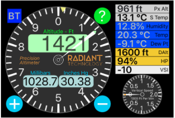

old man emu Posted July 26, 2020 Posted July 26, 2020 I have an app on my phone that reports the altitude of the phone. I wonder if it does this by using the GPS system, which not only gives Lat and Long position, but also height ASL.
Flightrite Posted July 26, 2020 Posted July 26, 2020 The vertical aspect of any GPS (outside of high quality aviation units) is very inaccurate. 1
onetrack Posted July 26, 2020 Posted July 26, 2020 OME - Not sure about your app, but this altitude app (link below) says .... "This altimeter app, to measure altitude, uses: - GPS satellites triangulation - works without internet connection, - barometer pressure sensor (if available in your device) - high accurate data; if internet connection is available it calibrates itself to improve accuracy, - online networks location services (wifi and other) - need internet connection. You can use each sensor separate or all together." https://play.google.com/store/apps/details?id=com.exatools.altimeter&hl=en_AU
